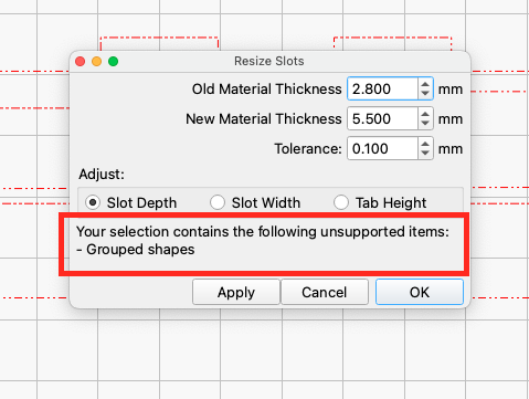

I tried this feature it with the enclosed SVG but it doesn’t seem to do anything. I fiddled around with the setting and still nothing.
I did read the documentation on this and it looked pretty straight forward.
I’m using LB 2.0.05

I just checked your file and resize works properly. One thing that trips me up sometimes is the shapes cannot be grouped. The dialog box shows any errors.
Geesh, Now it’s working.
Thanks Tim
