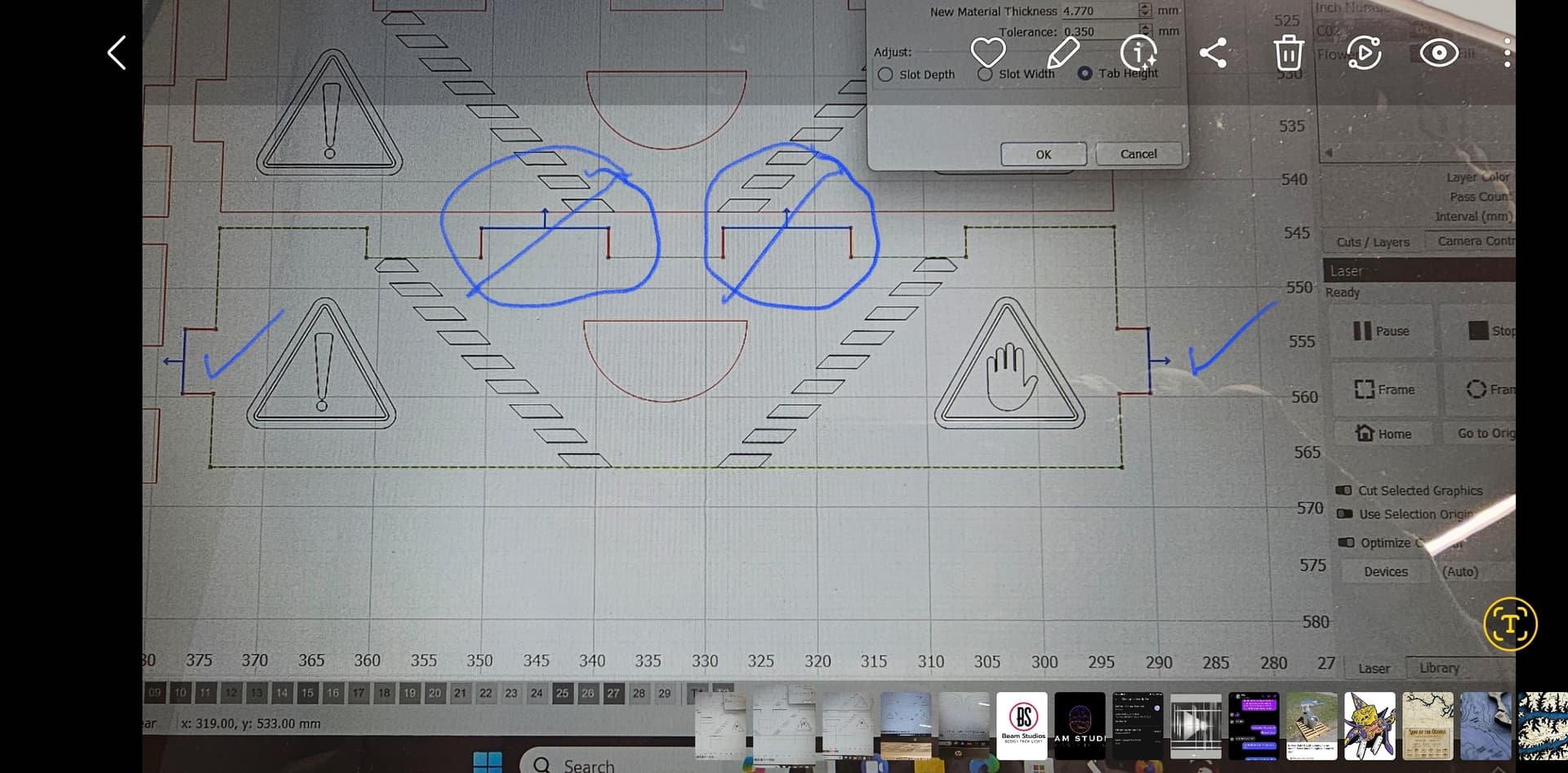

Working with the slot resizing portion of the software. Is there a way to exclude some slots from being resized on a selected part? I ask as I have a few parts that have internal slots as well as external slots and the software wants to adjust the tops of the internal slots when I’m looking to only change external slot depth. I included an image to hopefully clarify my question.
Thank you in advance.
I would node edit and break nodes at corner, then select the pieces you want to change. Then auto-join them back together. Didn’t fully test this, but looked like it will work.
Instead of breaking the shape with node editing, you’ll want to add a node in the middle of the tabs you don’t want to change.
This way the shape remains closed, and if you wanted you can go to “optimize shapes” and see very little about “adjust lines” and that’s it.
