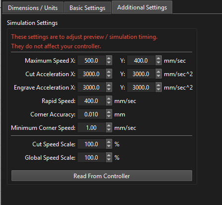

Regarding inaccurate time estimations from buffer runs etc., I often prefer using the preview to estimate times, assuming the accelerations and maximum speeds for the machine are correctly set in the device settings
The preview uses these values to estimate completion time, which should normally be relatively accurate if your laser is indeed moving at the speeds you tell it to.
For settings that your specific laser doesn’t use, that may have to be a future release of the REST API as a whole - for now I’ve got the beginnings of a thought on how to handle that, but it’s not yet fully baked.
