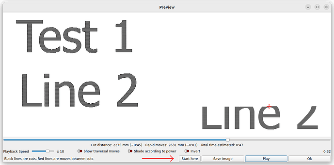

Can’t seem to get this feature working. Using version 17.08 on a macbook pro, 60w JPT. The job stopped about 3/4 the way through. Using the preview pane I go to the point where the job stopped the hit the “Start here” button but nothing happens. Close the preview pane and hit start but the job starts again from the beginning. Wondering what I’m doing wrong.

When the job stopped It showed in the laser pane that it was still running but the laser was not firing so I stopped that and opened the preview pane and positioned the preview where the job had stopped then hit the Start here button but nothing happened. I tried that a few times but couldn’t get it to start from that position using the Start here button. I did get it to work once on a previous & different job using an earlier version of LB but I don’t recall if I did anything different that time. Not sure If I’m missing some setting or method to get it to work.

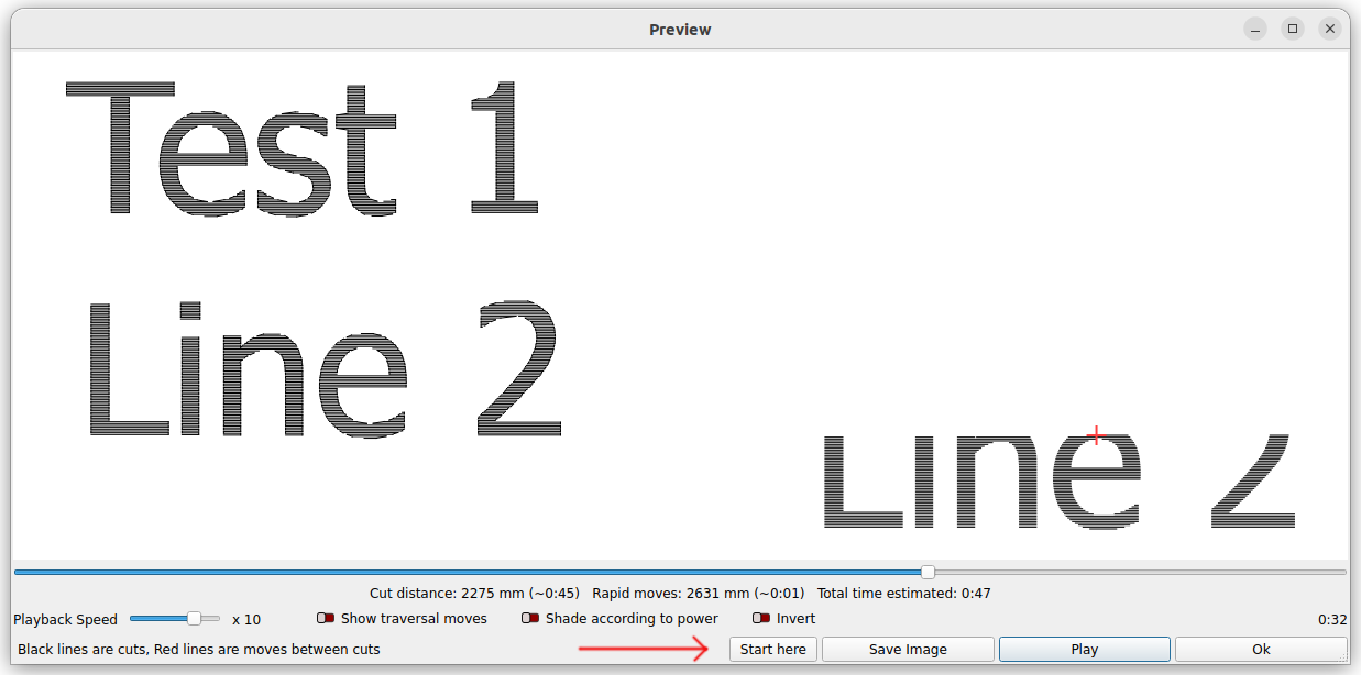

Using preview…
I haven’t really tested it, but I can hear the galvos working when I click on it.
What I found was clicking and briefly holding on the Start here button then releasing resulted in another drop down menu appear where clicking the start option there made the laser start again where desired.
