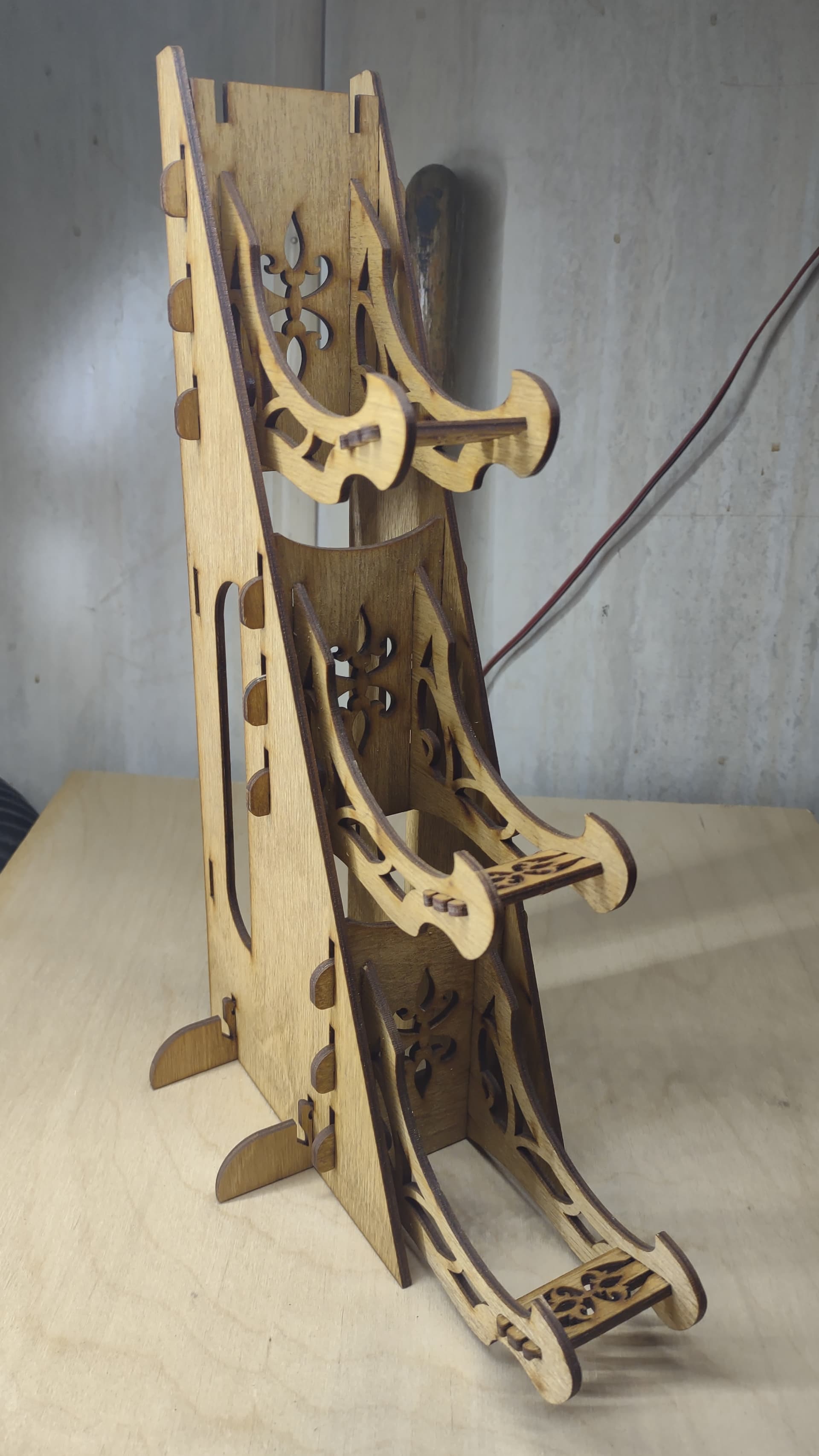

Retail Agate & Geode display racks – Design worked very good – all snap together no glue
Looks great!

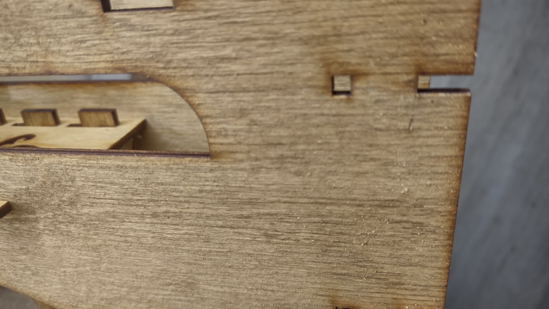

Does that side slot have a separate small square cut-out above for the latch you have styled to lock/hook into?, is there a latch on the inside as well?.. looks interesting can you share the design of this snap join please?

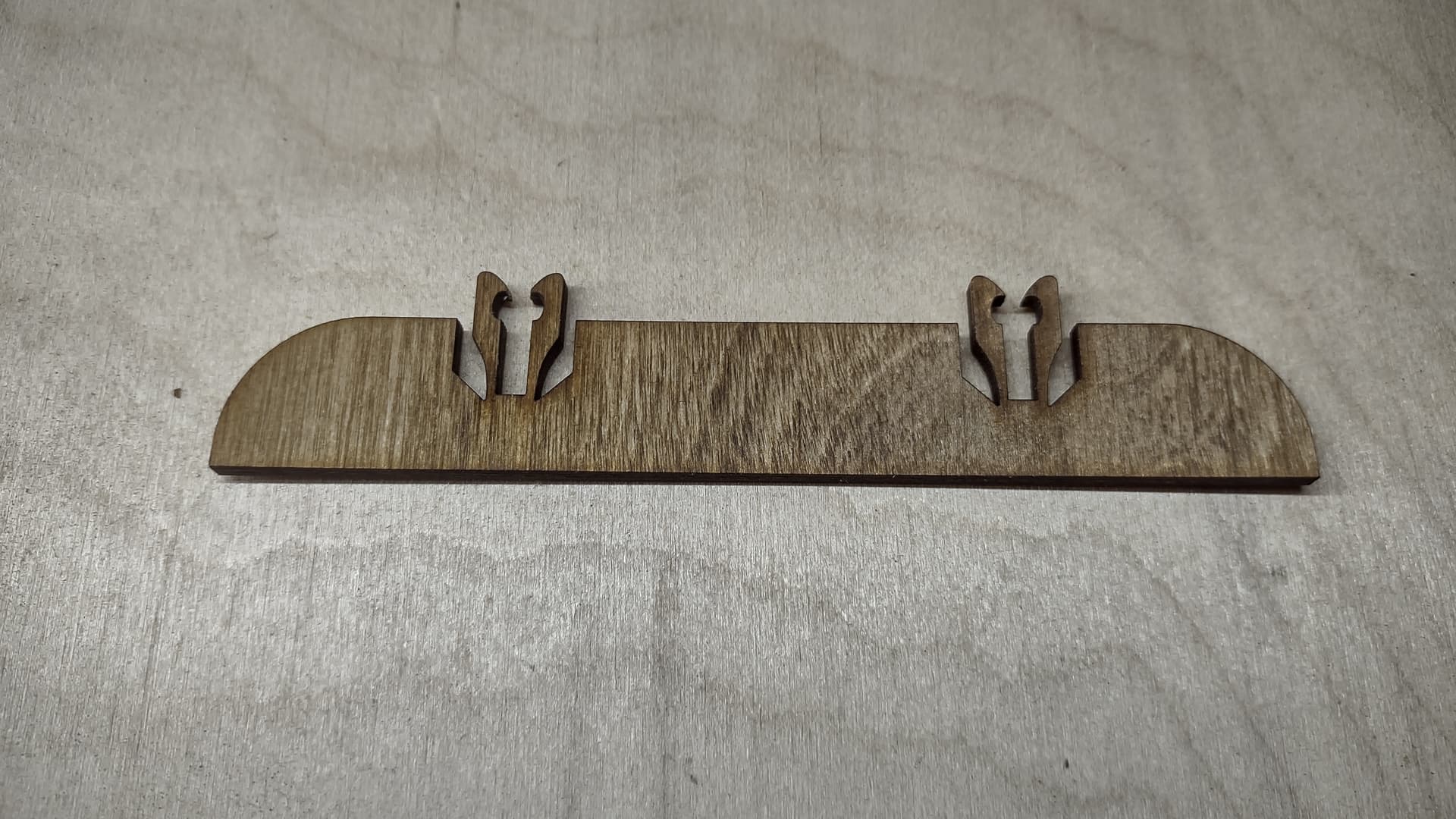

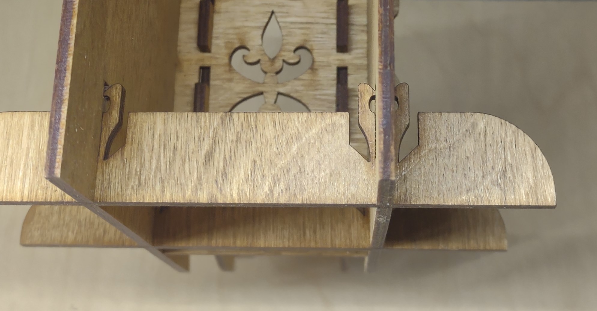

This was the proto type, I think the base point of the latch could be thicker
