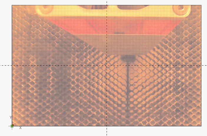

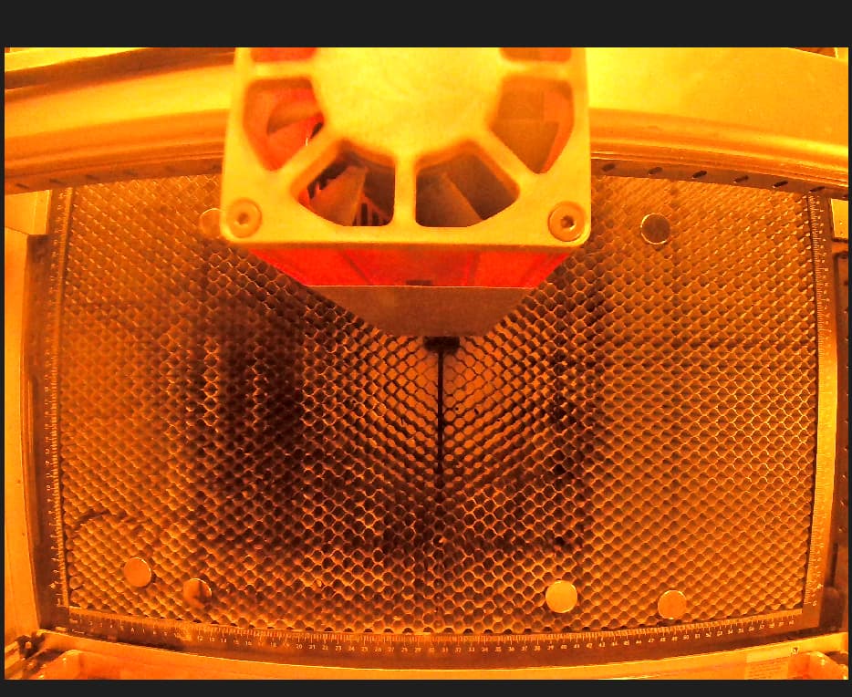

Installed 2.0.0 last night to check it out. Really liking the new changes, but I’m having issues with the camera.
For some reason 2.0.0 keeps telling me that my workspace is set smaller than what the machine is saying it is. I’m using the default config that came with the laser and double checked the work space matched up with what their website says. It’s trying to tell me it’s like 30mm larger than what it defaults to. Kind of weird …
Anyways, that seems to be throwing the camera off in 2.0.0. It’s like the camera is zoomed in really close when I apply the overlay. The camera window itself looks normal. But it makes it impossible to get an image lined up close to fine tune with frame.
Attached are a couple screenshots showing camera and overlay views.
Anyone else having issues or ideas on fixing it?
OK, apparently I just needed to keep calibrating my camera. 3rd times the charm? lol

For the camera, did you do the alignment again?

Yeah, had to do it 3 times. Not sure if I missed something the first two last night, but when I did it a 3rd this morning it worked and camera is back to normal.
