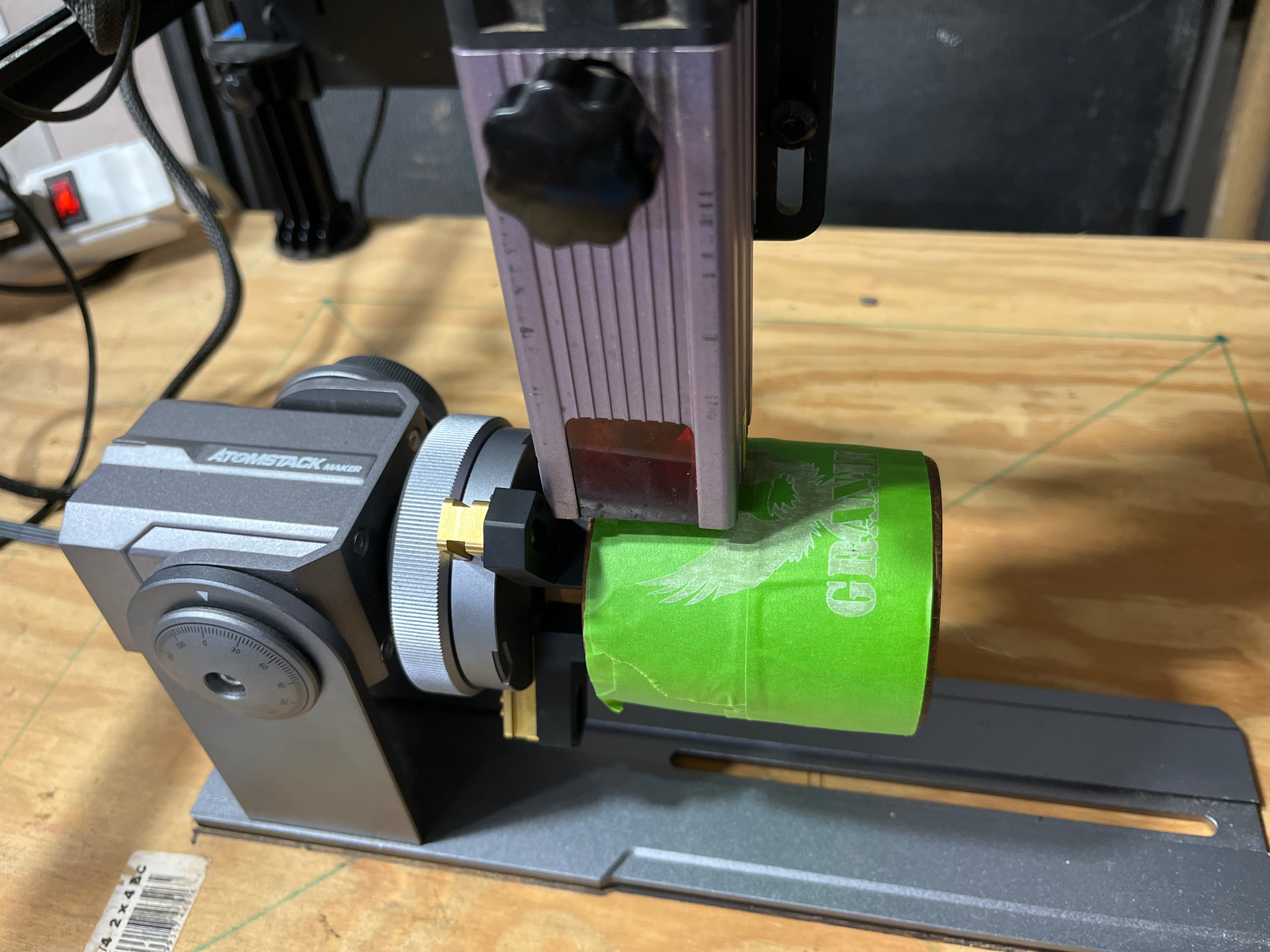

Rotary compressing right side of project when starting project
When starting a project the laser compresses the rifpght side of. The letters and artwork
Show your setup, your rotary with the tumbler on it, the results you’re getting and screenshots of your Lightburn screen with your project loaded and screenshot of the rotary window(no phone pics of your screen please)

Is the right side the beginning or the end of the engraving?
Right side is the beginning

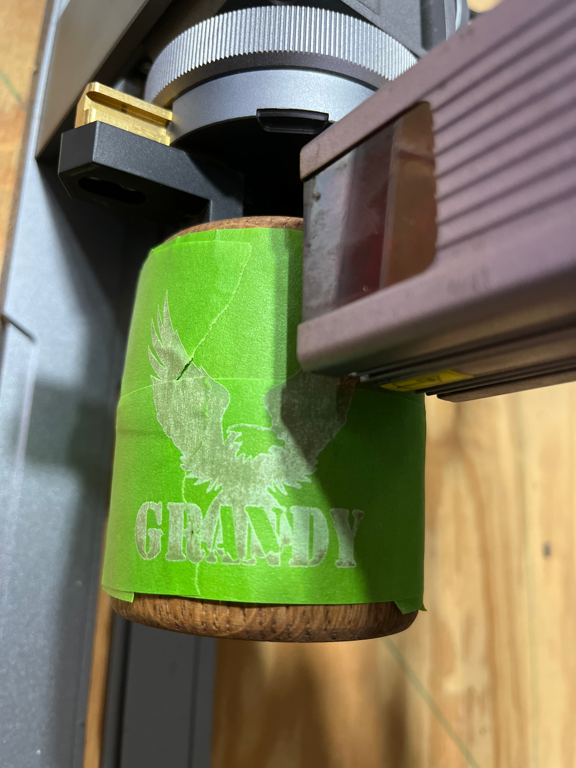

yes, I marked it again, and tested the rotation and it hits the mark on both rotations

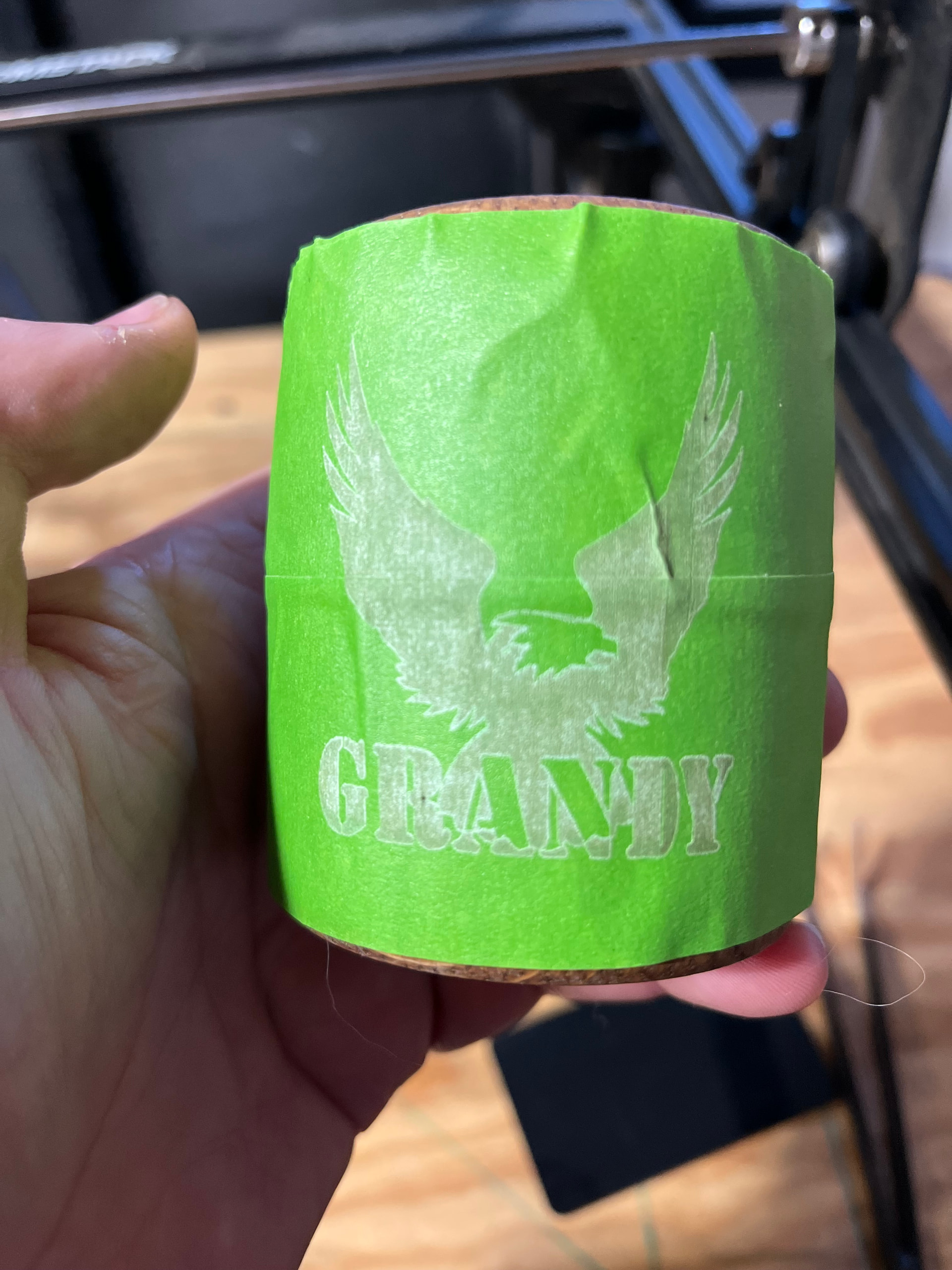

I burned it again, will follow with a picture, seems it is better….looks like the laser may have been off center

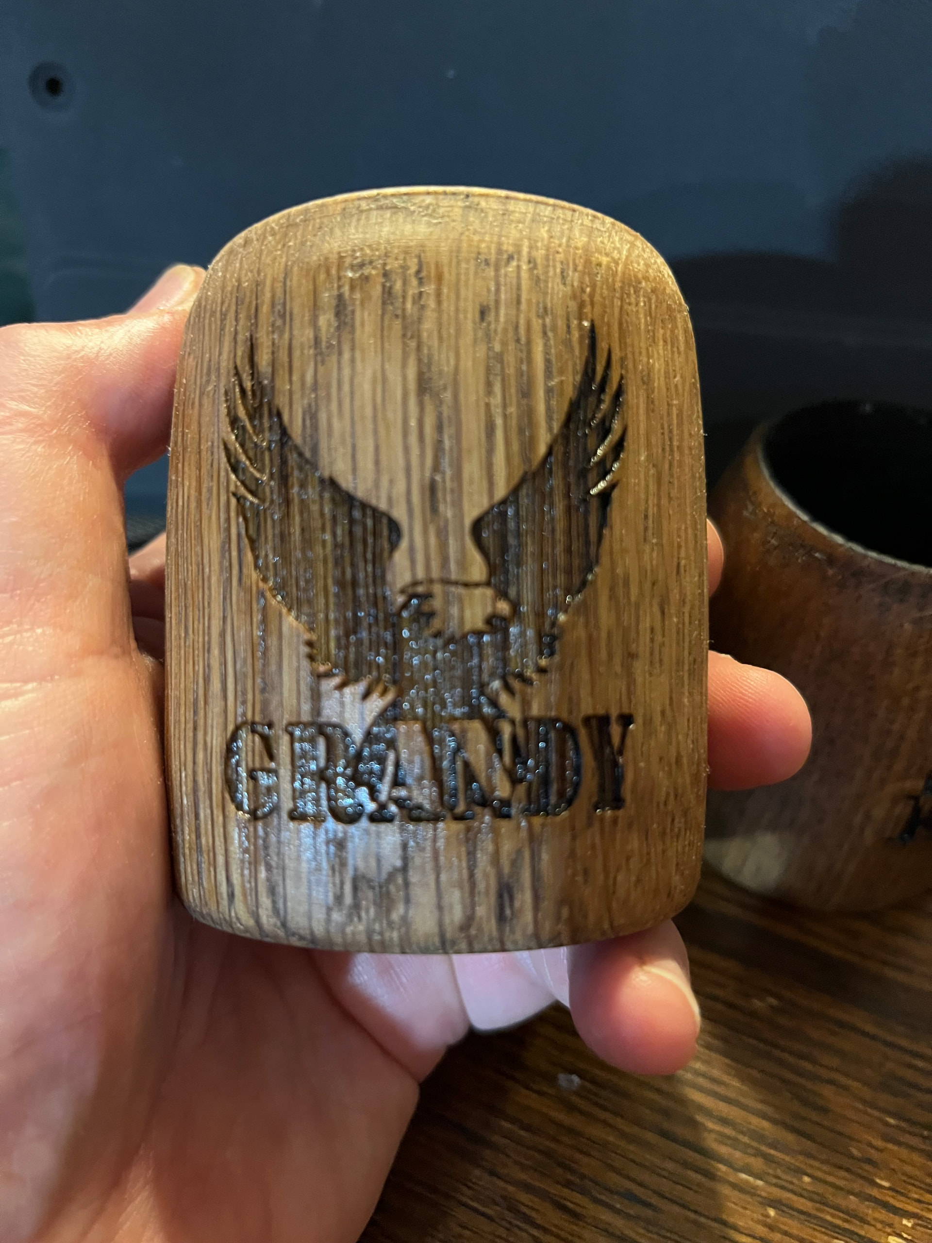

Still seems to compress a little then stretches
Could it be a spacing setting
I think it looks pretty good. The woodgrain may be causing some optical illusion.
