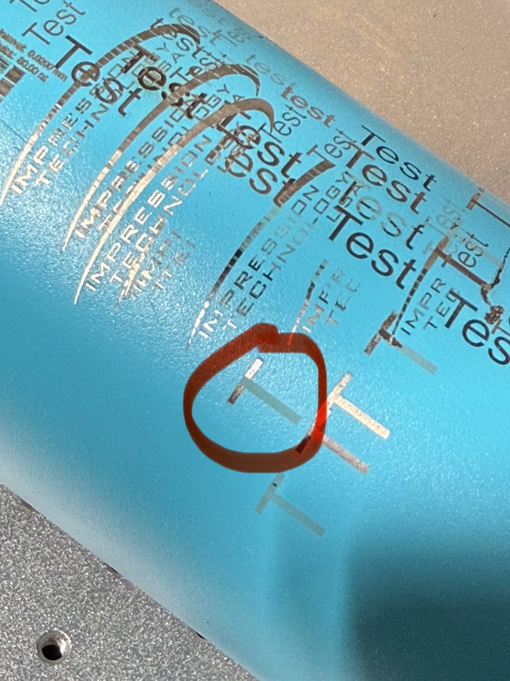

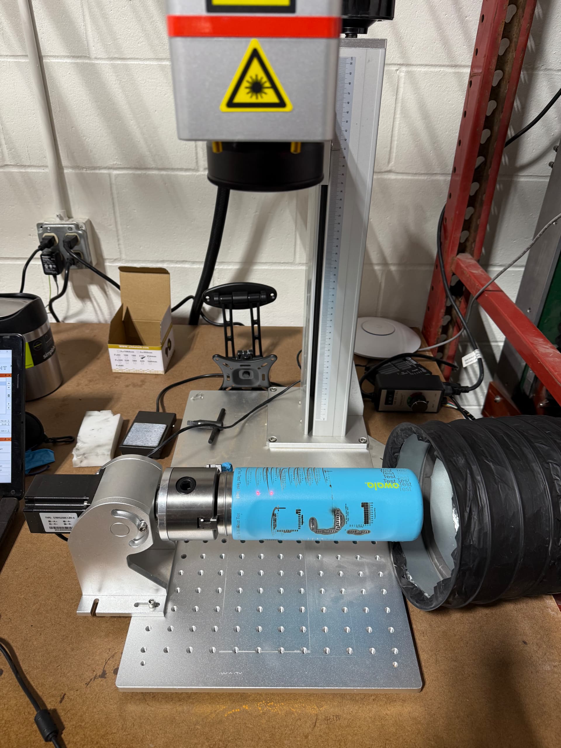

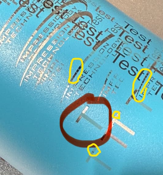

I am using a JPT 100w MOPA laser with a rotary. I have been doing some test engravings and the rotary is set to turn along the Y axis. As you can see in the photo the coating is removed fine along the y axis but the part of the T that runs along the X axis seems weaker and coating is not removed.
Can anyone recommend what to check on what would cause this to happen. I am new to lightburn and never experienced this with the previous software I used so i assume it is a setting somewhere that needs to be tweaked. To get the full T to engrave like the one below the circle it has to run several passes.
Hello, Bryan
Please post screenshots of your settings. My WAG with only looking at your photo is the heat remains high enough on the short passes of the top of the T, but as it scans the longer length of the stem of the T it cools just enough to make a difference. To confirm you could make a series of bars varying in length from the top of the T dimension to the stem of the T dimension. Could be a couple dozen other things as well. Removing colored coatings with a fiber can be a challenge.

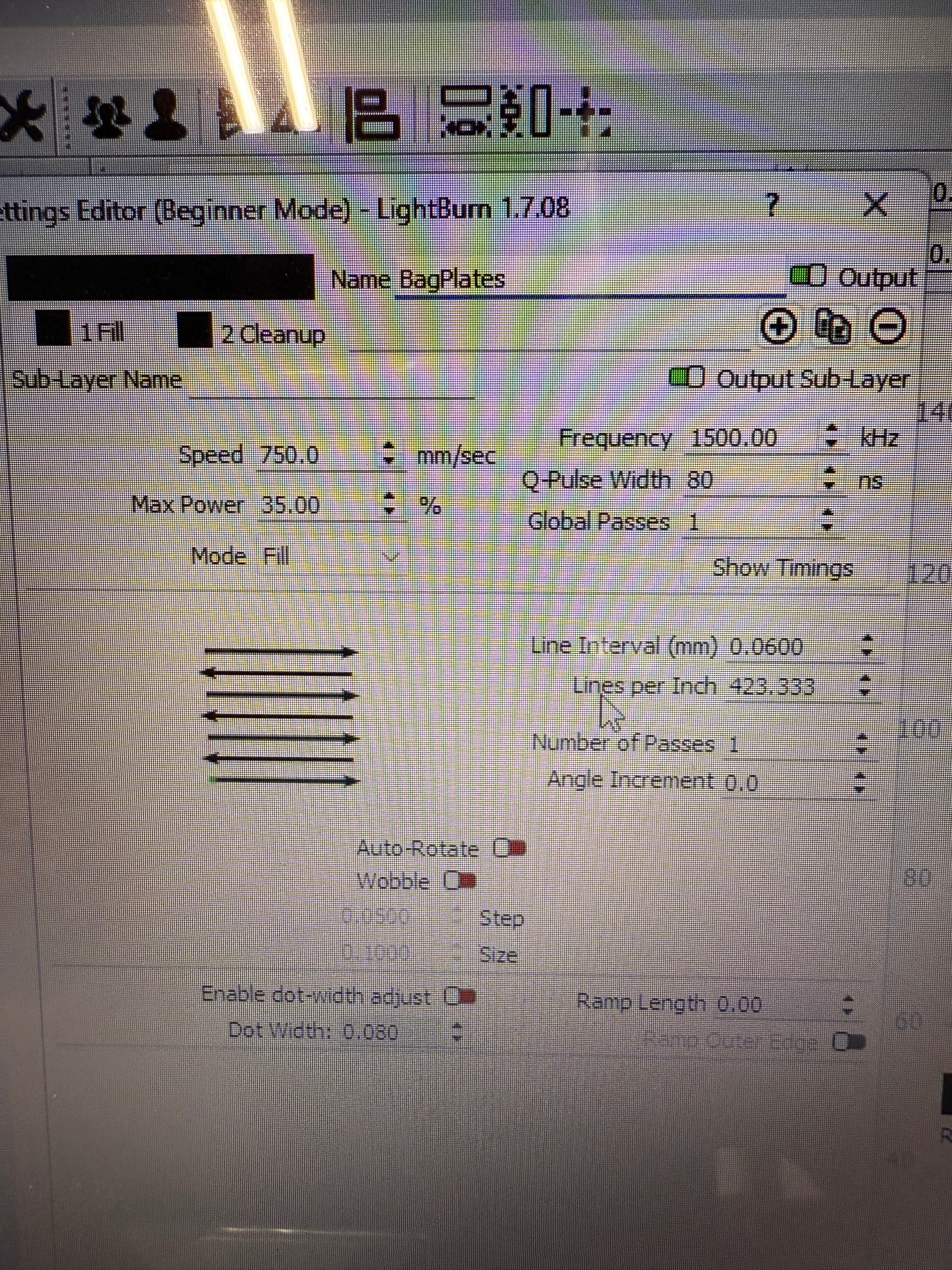

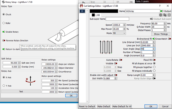

Here’s the settings I had used.
Got to “File > Settings” and disable the Beginner Mode. This will give you access to the Scan Angle setting in the Cut settings.

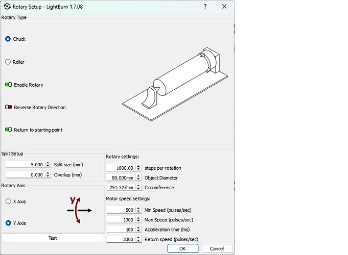

Which is your rotary axis?
From the Rotary Docs:
When rotating on the X Axis, you’ll want to engrave along the Y Axis, with a Scan Angle of 90 or 270. When rotating on the Y Axis, you’ll want to engrave along the X Axis, with a Scan Angle of 0 or 180.
Yes, turn off beginner mode for sure.

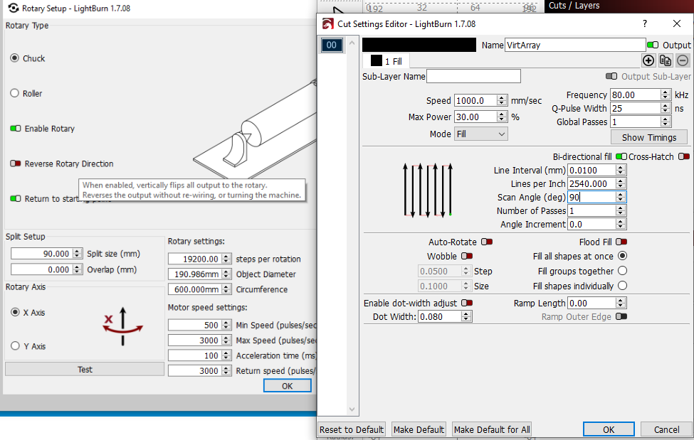

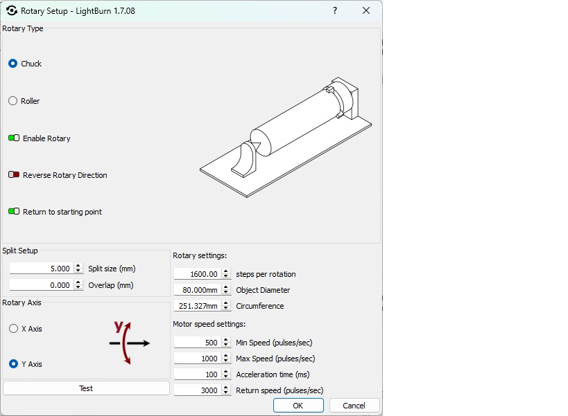

Scan angle vs rotation:

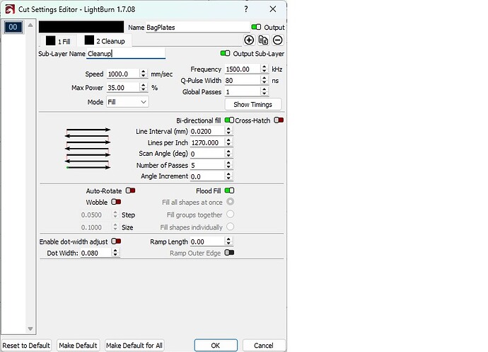

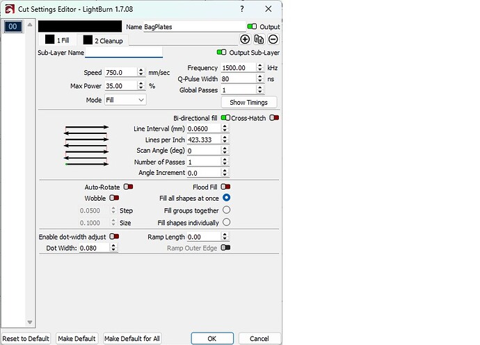

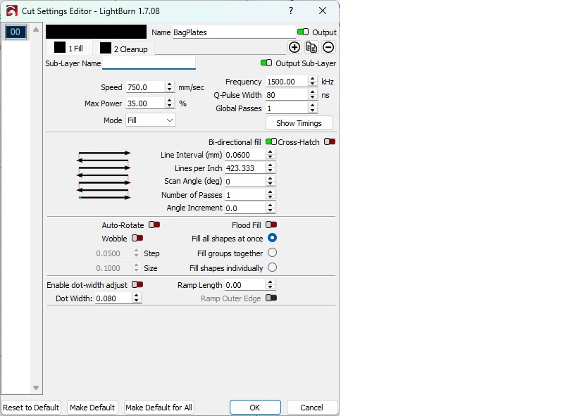

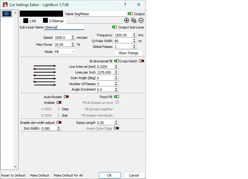

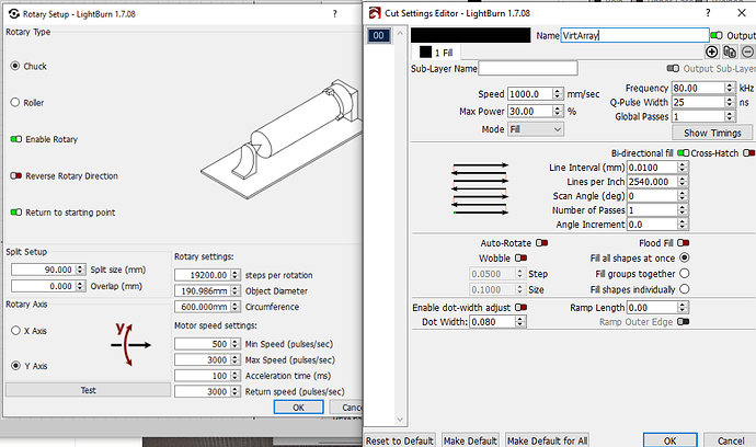

I believe I have the scan angle set up correctly based on y axis rotate. Here are some updated screens without beginner mode on.
If I misunderstood and I have something set wrong let me know.
I really appreciate everyones help on this. This software is awesome but it is way more advanced then the last one so I have learned most of the other stuff but struggling to get the rotary right.

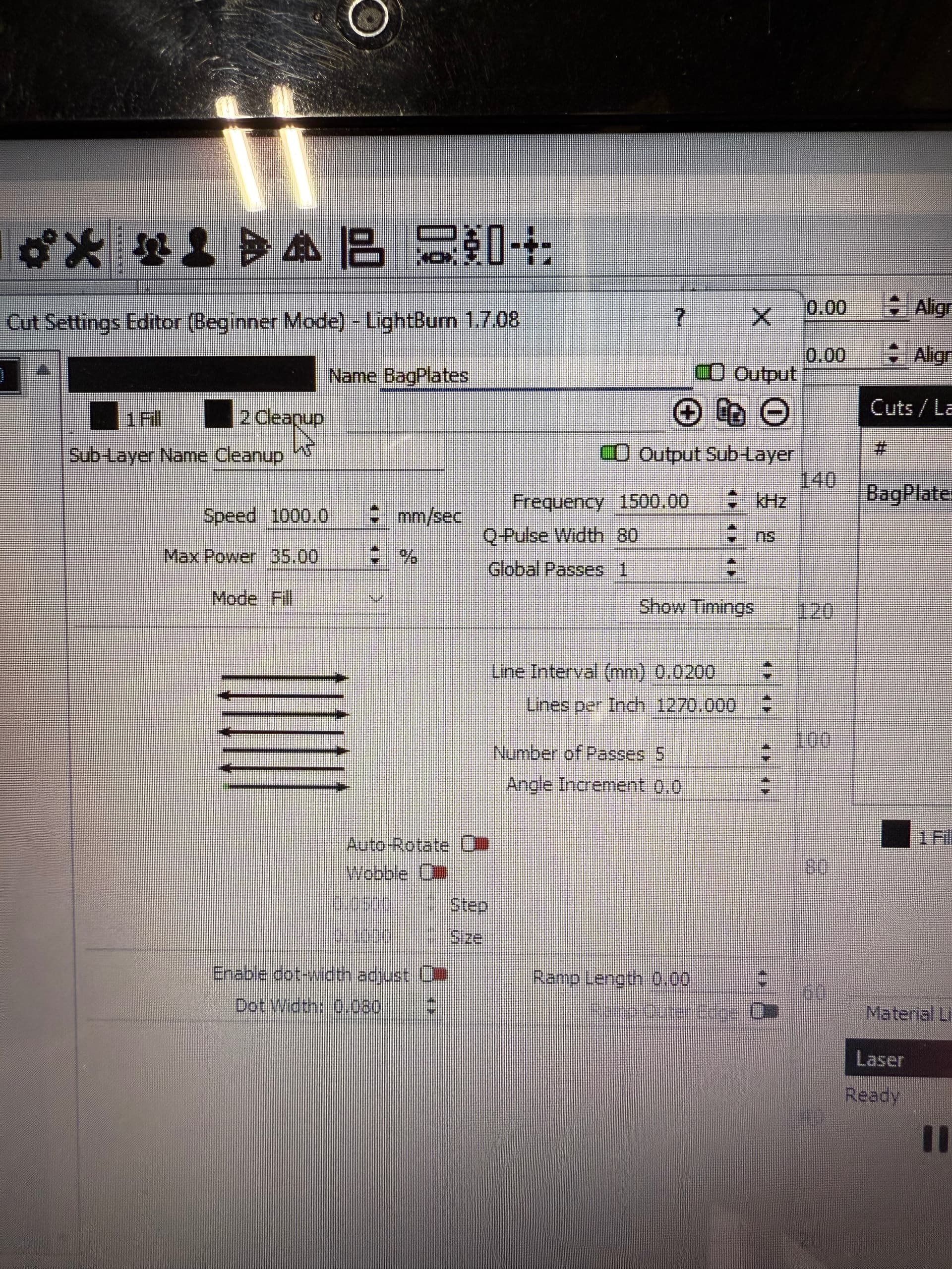

Thank you for the screenshots.
The Rotary Axis and Scan Angle look fine!

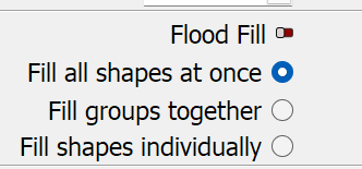

You should disable Flood Fill on the Cleanup pass to minimize the rotary jumping between the splits. - To rule it out as the issue, best disable the cleanup pass alltogether for now.

I will check that flood fill setting and run a test triangle and see. Running them flat without rotary I did get a better result. That is why I am convinced its just a setting I am missing. I will give that flood fill and even disable cleanup pass altogether and see what happens.

Also, just curious, where did you get your parameters? They are not typical of what I would expect. Not saying they are not good settings, just unusual. Seem to be working for the most part.
I just had a minute to go back and test them again and I am not sure what did it but it is working better now. I did one thing at a time and it worked on the first thing. Just putting it into advanced mode seems to fix it. I did later turn off flood fill and there was no change so I will just leave that off.
I have advanced off because for my normal every day marking that does not use rotary in beginner mode it engraves in 4 minutes but when advanced is on it estimates it at 59 minutes. So I have not found what is in advanced mode that is causing such a difference. Might have to dive into that now and figure it out.
Thank you both for the help and tips!
Found some that were very different online and weren’t working how I wanted so just kept changing numbers until I saw gradual improvements. Those are what I ended up with. Probably better ways to do it and probably faster but my first time doing drink tumblers so just trial and error at this point so I can get an order done for a customer. Got a bunch to do so faster would be better but current settings get a pretty good mark and don’t have to wipe with magic eraser sponge like I see a lot of online videos do.

I see on your image a lot of artifacts that suggest your rotary setup is incorrect. So once you get your parameters looking good, you need to burn some shapes and get your rotary dialed in.

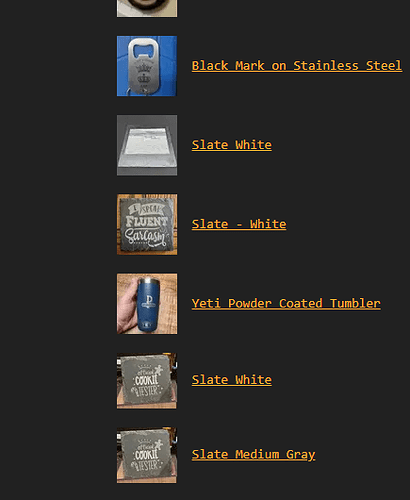

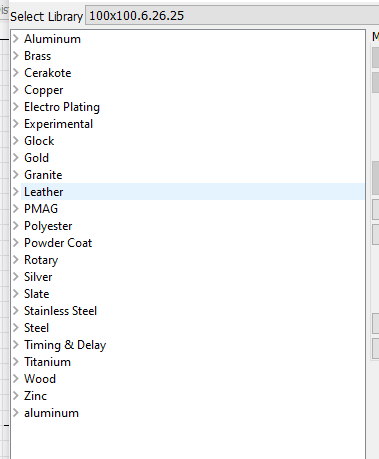

Not a video, it is in the user database where we started posting parameters that work. It is using a 60W so you would have to convert the power, but we have one of those available also.
Also have a huge starter library for just about every laser.
