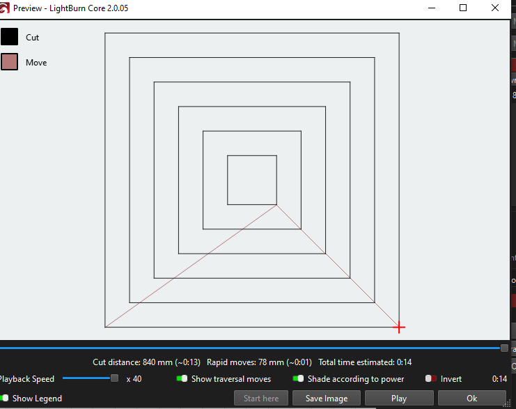

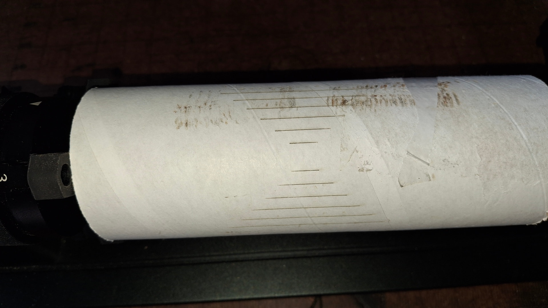

The problem I am getting is when I do a burn the laser is not burning in the Y Axis
Test burn below
Test Preview

If it hasn’t been done yet, what I would do is check if the laser is actually activated or not when the Y-axis is occurring.
I don’t believe that’s the case, but in laser modules where the focal point is rectangular instead of square, and the laser power is at the minimum limit to burn the material, it may happen that where the focal point covers more material there isn’t enough power to burn it.
Increasing the power by about 20% in a test clarifies this doubt.
The only thing I have tried is far is to import the falcon2 config file, But there was no change.
I pretty sure the laser is not activated when traveling in the y axis

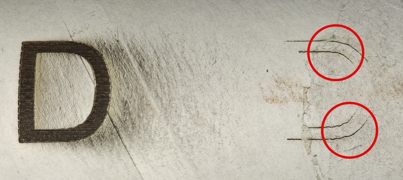

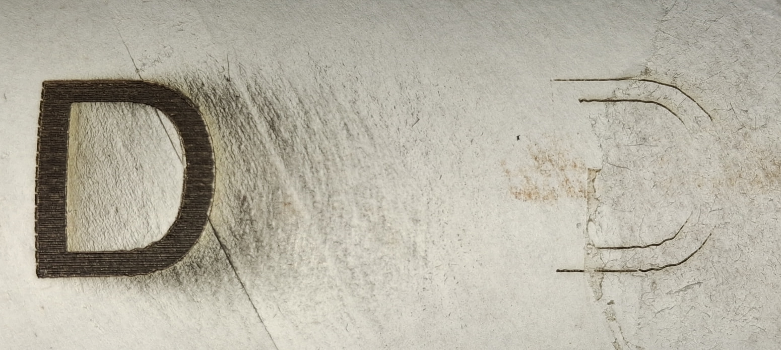

I have also ran another test just doing the letter D one with “Fill” and the other with “Line”
As @Kuth points out, this most likely due to the rectangular shape of the focused spot. If it’s wider than it is tall, then horizontal motions deposit more energy = burn darker than vertical motions.
That’s obvious in the D shape, where the burn simply fades away as the angle goes beyond 45° to the horizontal.
The solution is to use more power (or less speed) to deposit enough energy for the results you want. This will be a delicate balance between too much in horizontal motions and too little in the vertical, but … that’s the story of lasering. :grin:

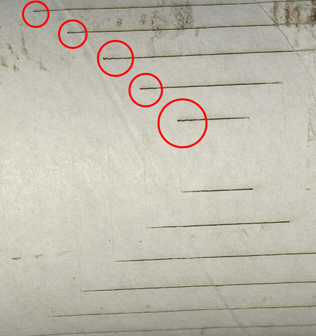

This image tells me two things:
1 - The wiggly line means that the machine is probably working at speeds that are too high to properly handle inertia and small mechanical clearances.
2 - The line at letter D, as it increases in length towards the Y-axis, should widen if the focal point is rectangular, and this does not seem to be happening.
Think of it this way: the middle part of the rectangle gets slightly more energy than either end, because the middle has hot neighbors on both sides. Even when the rectangle is uniformly illuminated (as it should be), the middle will be hotter.
As the laser head motion becomes more vertical, the middle of the rectangle continues to char because it’s hotter, but both ends fade away and the mark becomes thinner. As the speed parallel to Y increases, the middle of the beam just isn’t hot enough to char the material.
