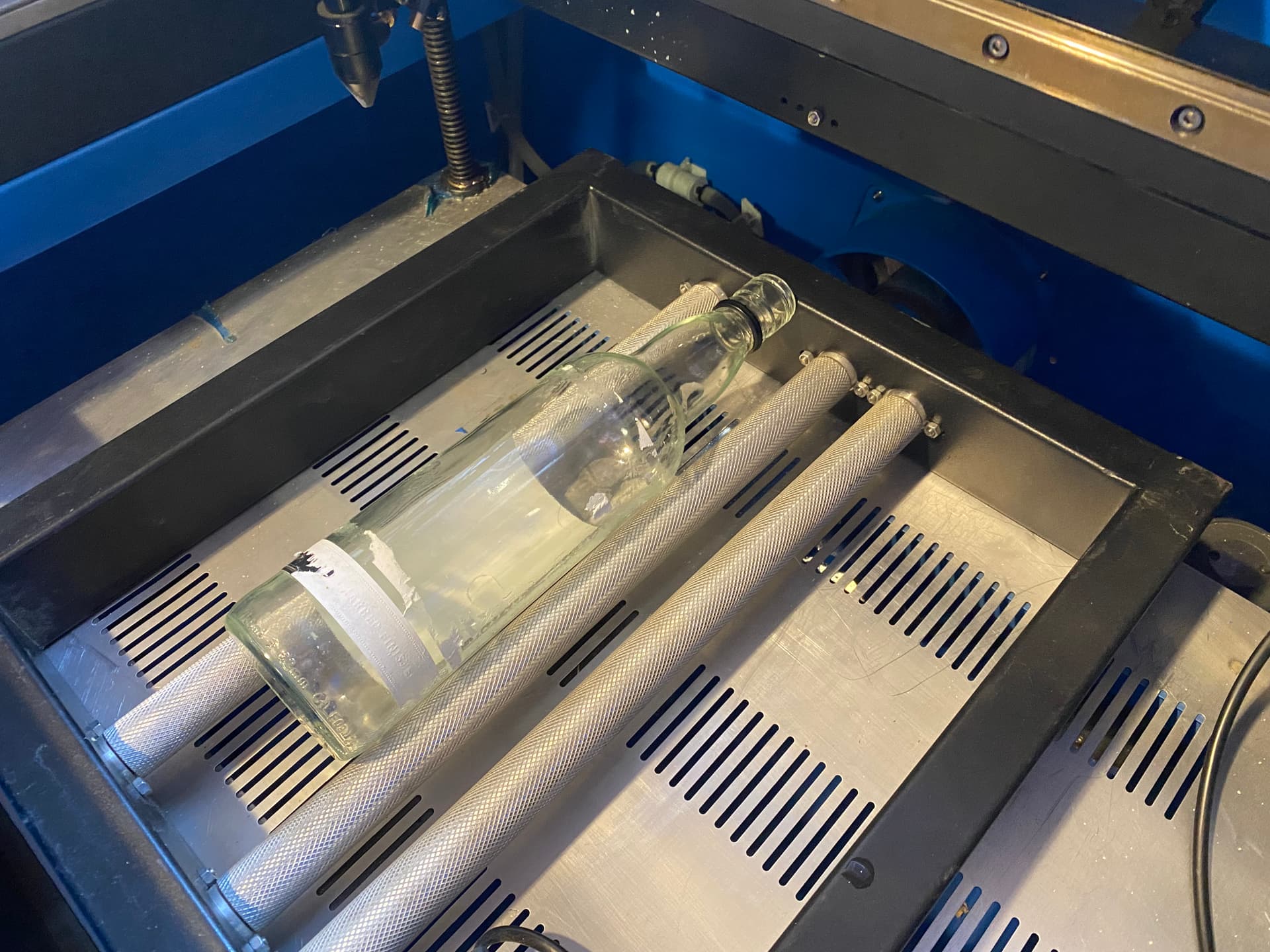

FINALLY got my big K40 up and running, on Sunday. Plenty of successful tests on acrylic, stone, metal. Today I decided to tackle bottle etching.
LB sees the roller, communicates. I did the requisite setup in the file (diameter, enable, etc). Here’s the key thing I don’t understand…where do I place the art on the work board, and what orientation for the laser do I use? Upper left (home)? Center? What’s ‘home’ for a rotary setup?
How does one go about orienting a bottle on this thing?
My first test - the ‘well, let’s make a mistake’ test - had the thing behaving oddly: It went to the neck, tried to burn a hole in it, then went to the left of the neck, sat for a minute, then the right of the neck, and sat there. Did nothing else.
I would much rather me be doing something wrong, than have something be faulty.
Not my kind of machine, but the rollers should be parallel to the Xaxis. You want the sweeping motion to be along the Xaxis and the rotarry making small steps in the Yaxis.

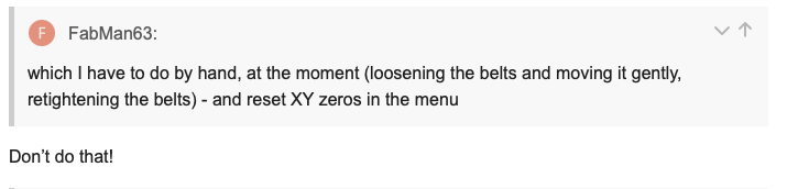

It seems the rotary somehow jacked something up and my Y axis is almost non-functional. I won’t go into the lengthy detail of everything I tried, but the bottom line is this: When I zero the gantry (upper left) - which I have to do by hand, at the moment (loosening the belts and moving it gently, retightening the belts) - and reset XY zeros in the menu, the X axis works just fine, but the Y axis moves maybe half an inch and the coordinates read it went from 0.0 to 299.7.

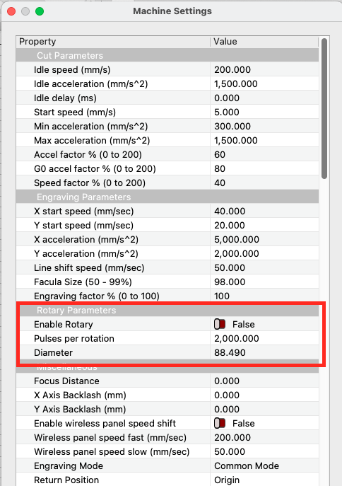

In Lightburn go to Edit Menu> Machine settings. Verify Enable Rotary is off.

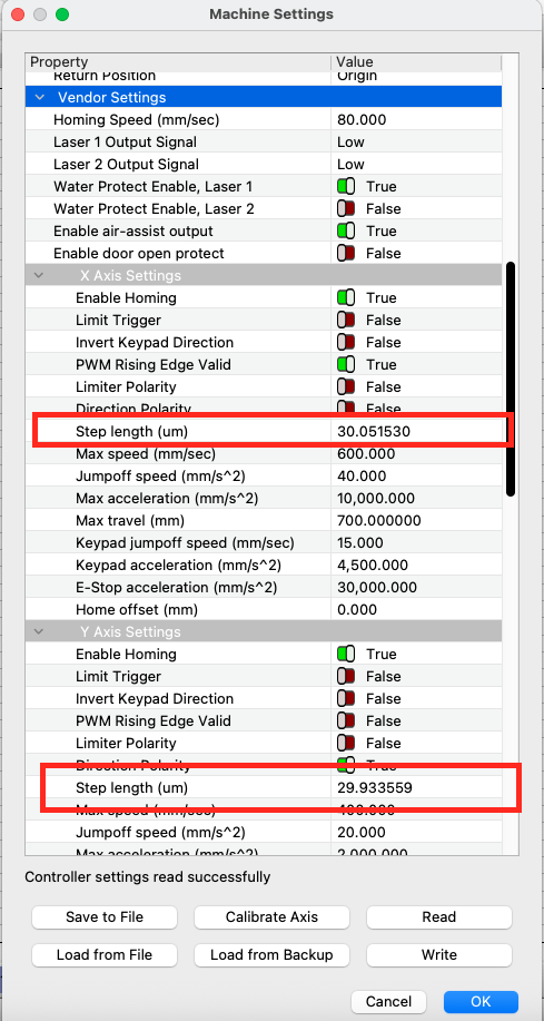

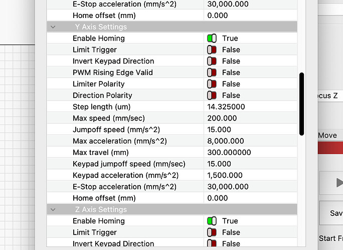

If it is, click Vendor Settings and Yes to continue. Verify that the X and Y axis step length are t least close to each other. If the Y axis is way off, change it to match the X axis. You will need to do a calibration after making this change.
I don’t know what the correct settings for your machine are. I’m sure they are different than mine.
well…s**t.
The step lengths are identical.
Now, there was a difference in rotary enable settings, between the handy little icon up right, and the machine settings menu; the icon setting said it was off but machine said otherwise.
That’s why I had you check in Machine Settings. Iv’e had that before where I had it off in Lightburn but the machine didn’t register the change.
Apparently, the rotor enable setting in Machine Settings, did the trick. Why the interface icon can’t communicate that to Machine settings, I don’t know.
Question, though…should ‘invert keypad direction’ and ‘direction polarity’ settings be the same for both axis’?
Oh, I forgot to mention… I disconnected the motor from the driver before I did that… :face_with_hand_over_mouth:
Not neessarily. If it works, don’t change it.

That’s good, but moving it manually is a bad habit to get into.
