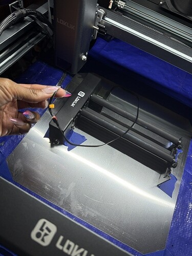

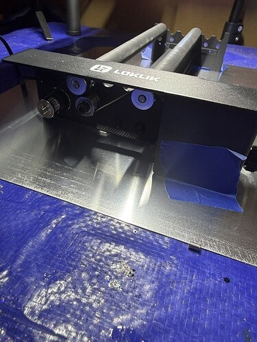

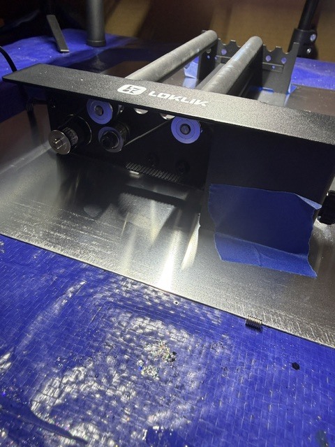

I’m having issues getting my rotary roller attachment to work. Rollers don’t turn during test or when engraving begins. I’ve checked all cables, Y connector is attached to rotary cable. I’ve adjusted the tension to tight and loosened it (not sure how tight the tension should be).

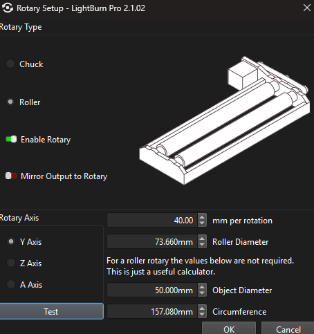

Rotary Setup Settings:
In the Move window, left and right arrows work, but up and down do not move the laser module/support foot.
Based on the size of your hand and the rollers in the second image, I doubt your rollers are 3” (73.66mm) in diameter. Did you enter the circumference instead by chance?
You unplugged the cable from the Yaxis motor and plugged it into the rotary motor, right?
Does the motor make any sort of humming kind of noise, or sort of jerk, when you click the rotary Test button?

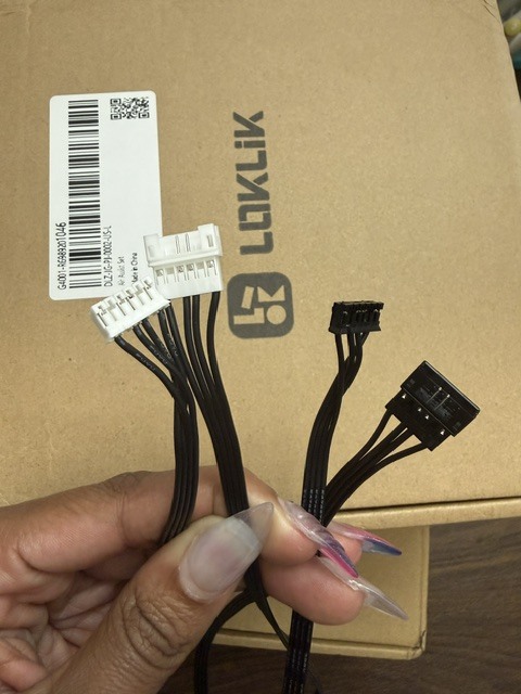

Did your rotary come with a short cable that has two wires crossen on one end?
Thank you for catching the diameter typo. Corrected to 15.5mm.

There were two cables included with the rotary - one black-end and one white-end and I’ve tried to work with both:

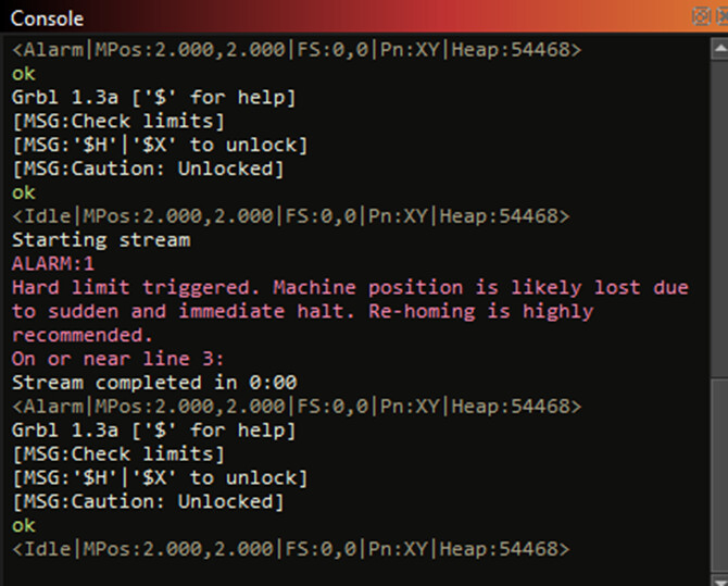

Tried to frame and test again. No luck. Tried to go to origin. Tried to go home:

You cannot Home with a rotary. It has no limit switches.
Turn off GRBL Homing (parameter $22=0) and turnoff Auto-Home on Startup in Lightburn Device Settings, Basic tab.
You will also be using Current Position instead of Absolute Coords in the Laser window.
As for things not moving, leave the settings alone, plug the Yaxis motor back in, and report how it behaves.

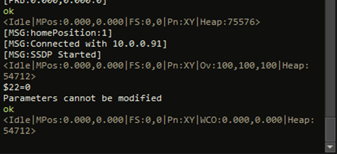

Auto-Home on Startup was already turned off. Tried to turn off GRBL Homing:

Reset during homing fail suggests a power connector issue.
Parameters cannot be changed is a real bummer. If you cannot set $22=0, that is okay. Just do not Home with the rotary attached.

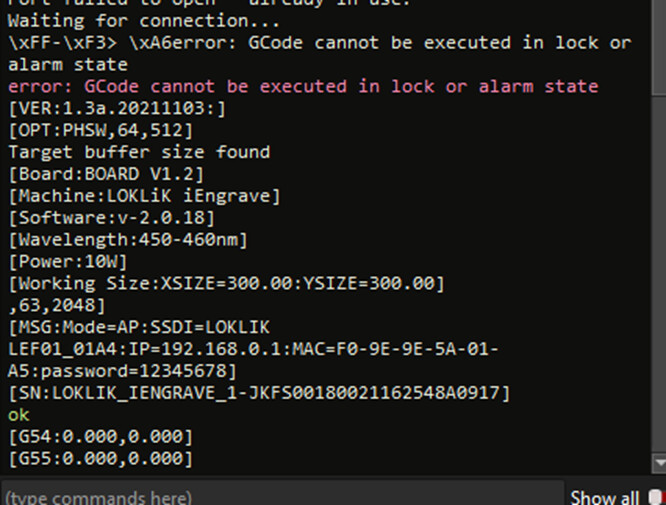

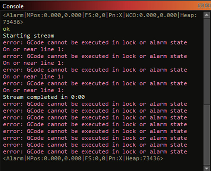

I unplugged the machine for about 30 seconds and plugged back in. Set origin to front left, but as soon as I turn the machine on there’s the error. From console:
Waiting for connection…
Port failed to open - already in use?
error: GCode cannot be executed in lock or alarm state
[VER:1.3a.20211103:]
[OPT:PHSW,64,512]
Target buffer size found
[Board:BOARD V1.2]
[Machine:LOKLiK iEngrave]
[Software:v-2.0.18]
[Wavelength:450-460nm]
[Power:10W]
[Working Size:XSIZE=300.00:YSIZE=300.00]
,63,2048]
[MSG:Mode=STA:SSID=Lair:IP=10.0.0.91:MAC=F0-9E-9E-5A-01-A4]
[SN:LOKLIK_IENGRAVE_1-JKFS00180021162548A0917]
ok
[G54:0.000,0.000]
[G55:0.000,0.000]
[G56:0.000,0.000]
[G57:0.000,0.000]
[G58:0.000,0.000]
[G59:0.000,0.000]
[G28:0.000,0.000]
[G30:0.000,0.000]
[G92:0.000,0.000]
[TLO:0.000]
[PRB:0.000,0.000:0]
ok
<Alarm|MPos:0.000,0.000|FS:0,0|Pn:X|Heap:54680>
error: Before resetting, it was in an alarm state,please unlock first
Reboot the PC and the laser.
When I open the software, it defaults to COM5 and I have to change it to COM9 (when the laser is powered on.
I’ll reboot my PC now and see what happens.
Restarted both devices…same errors.
When I connect to COM9 I get the following error:
When I hit home I get this error.

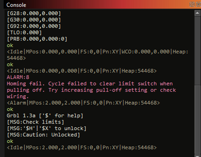

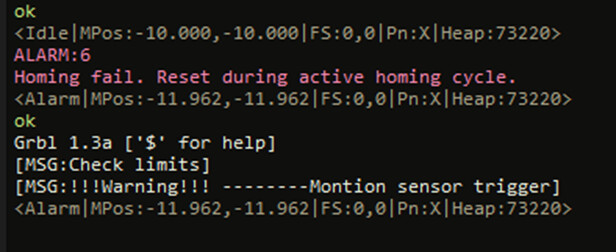

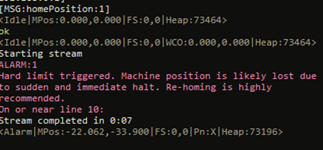

Can you show us what is in the Console window? We need to know what alarm was reported.
ok
<Idle|MPos:-330.000,-330.000|FS:0,0|Pn:X|Ov:100,100,100|Heap:54460>
ALARM:6
Homing fail. Reset during active homing cycle.
<Alarm|MPos:-9.712,-9.712|FS:0,0|Pn:X|Heap:54460>
ok
Grbl 1.3a [‘$’ for help]
[MSG:Check limits]
[MSG:!!!Warning!!! --------Montion sensor trigger]
Entered $ in console for help and got this (Not sure what I’m looking at):
[HLP:$$ $+ $# $S $L $G $I $N $x=val $Nx=line $J=line $SLP $C $X $H $F $E=err ~ ! ? ctrl-x]
ok
<Alarm|MPos:-9.712,-9.712|FS:0,0|Pn:X|WCO:0.000,0.000|Heap:54460>
