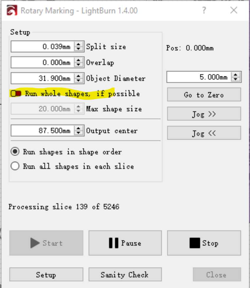

I understand that in 1.7 there was a setting in rotary “run whole shapes if possible? Is it no longer available in 2.04?
Seems like I used the release candidate the other day and it was there. I use it all the time and usually have the latest ver running, I think I would have noticed.

This is old but it was in the same place when I was in my shop a little bit ago with the latest ver

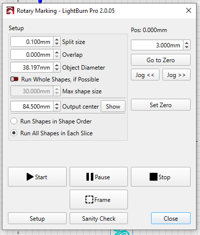

I had 2.0, it was there, and upgraded to 2.0.05 tonight and it was there.
I didn’t try 2.04. Sure you have galvo selected? What does your rotary marking window look like? Post a screenshot.
