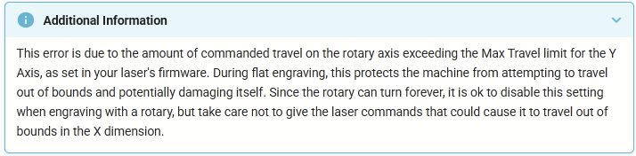

Rotary Settings too small
Hi Johann,

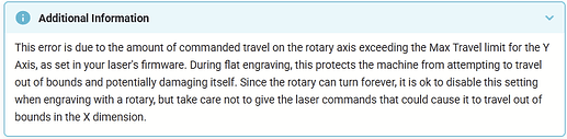

Absolutely. You are likely getting ALARM:2 in the console window.
Here’s a screenshot of our docs that explains what’s happening:
Your idea to increase the Max Travel with the firmware values $130 or $131will work, but yes, there is a better way :slight_smile:

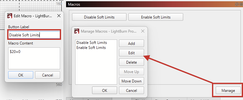

Temporarily disable the Soft Limits by entering this command in the Console window: $20=0
Enable them again with $20=1
You can add macros to run these commands:
