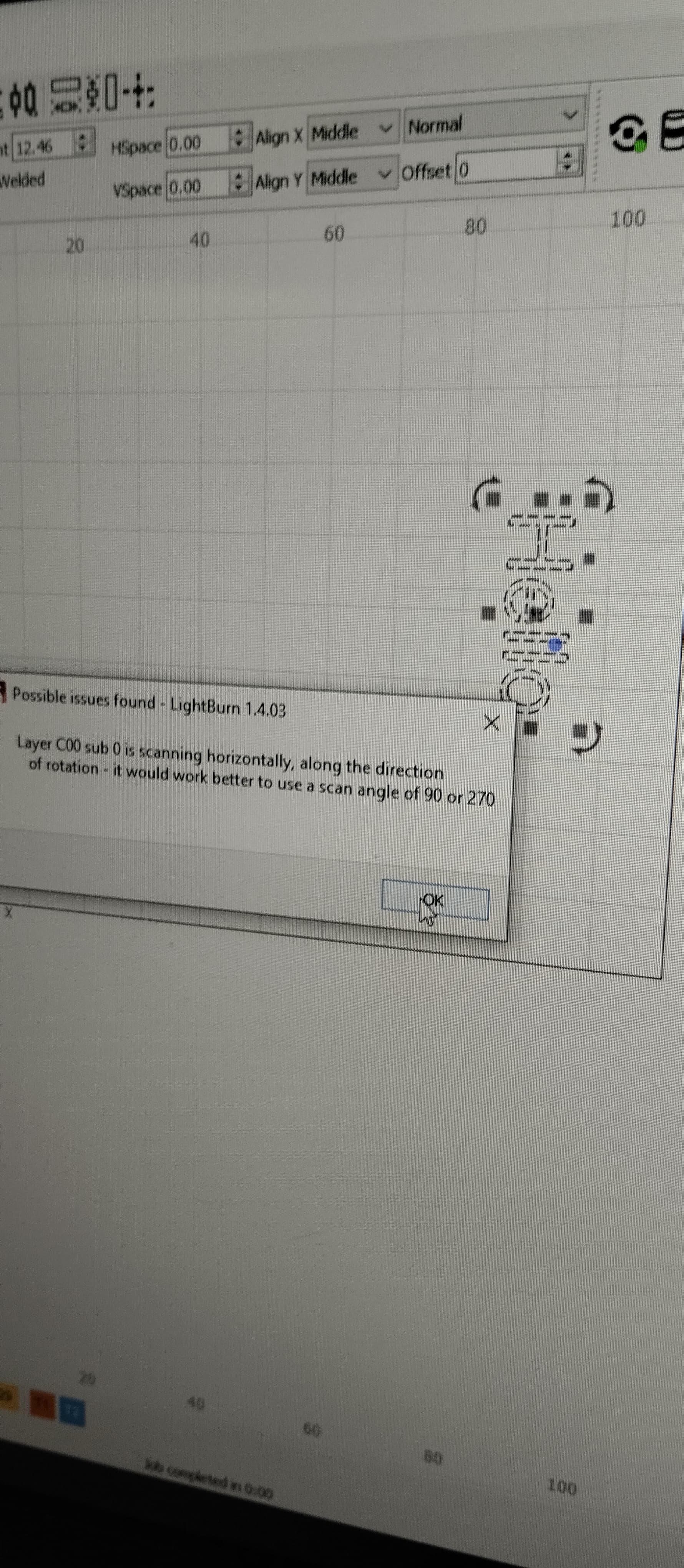

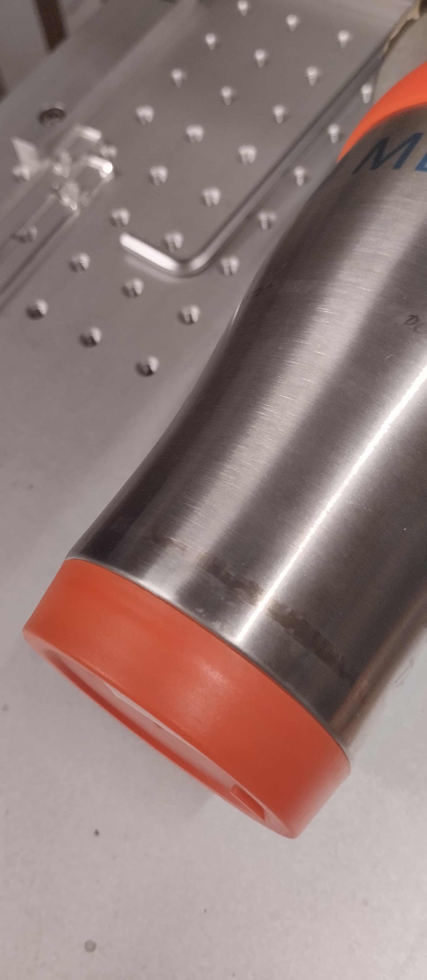

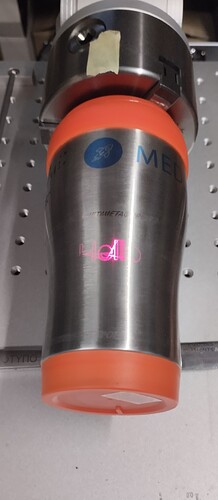

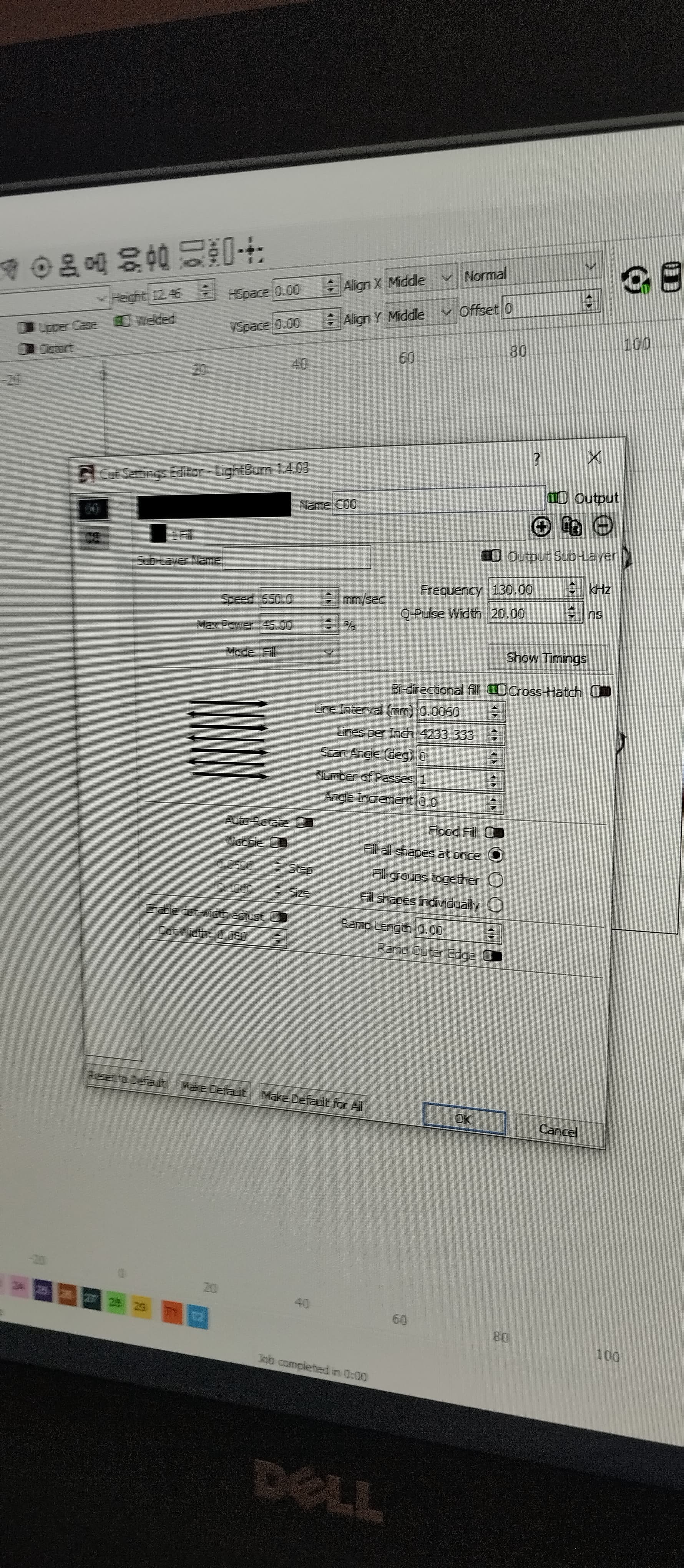

Hello,
I have a MOPA 80W laser. I have set up my machine, works flawlesly. When I try to use my rotary chuck, there is this weird behaviour.
When I try to engrave HELLO, it starts engraving the ‘‘HELLO’’ cut on half and the other half ovelapping each other.
Video following.
Steps per unit are calibrated correctly!!

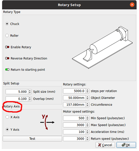

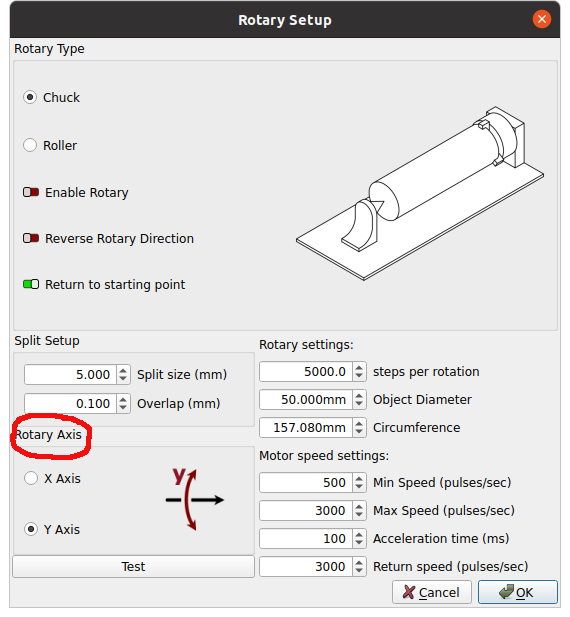

Your configuration needs to be fixed, then we’ll proceed
![image](https://forum.lightburnsoftware.com/uploads/default/original/3X/1/2/12877b2338847699d9f43da429d59fc3b7927721.png)
You mug is laid out properly, but the waring is saying you have the device configured to be along the X axes and it looks like it should be set to Y axes.
 ![image](https://forum.lightburnsoftware.com/uploads/default/original/3X/0/e/0e028e8f37143f93f8cfe71db07b261c6bc0a754.png)
My rotary axes runs along X, so it’s rotation is around Y…
Make sense?
