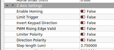

Does the controller have that axes enabled to home?
‘Edit → Machine Settings → Vendor Settings’
Screenshot from 2021-12-03 11-13-35
These are the current settings I have Jack - Don’t know what I should change to make the 3000 read 0???

The 3000 is the max range of the Z axis. It seems like it doesn’t know where home is, so it gives you maximum range as a default. It does likewise when you halt a homing cycle, x & y are set to 10,000.

Sorry I missed this before - The Z axis defaults to 3000 when not homed, just like X & Y default to 10000 when not homed - it’s just what the controller does. You could possibly enable homing on the Z axis for the controller in the controller settings, but I’m not sure if that will do it on startup, or only when you trigger the Z focus.
