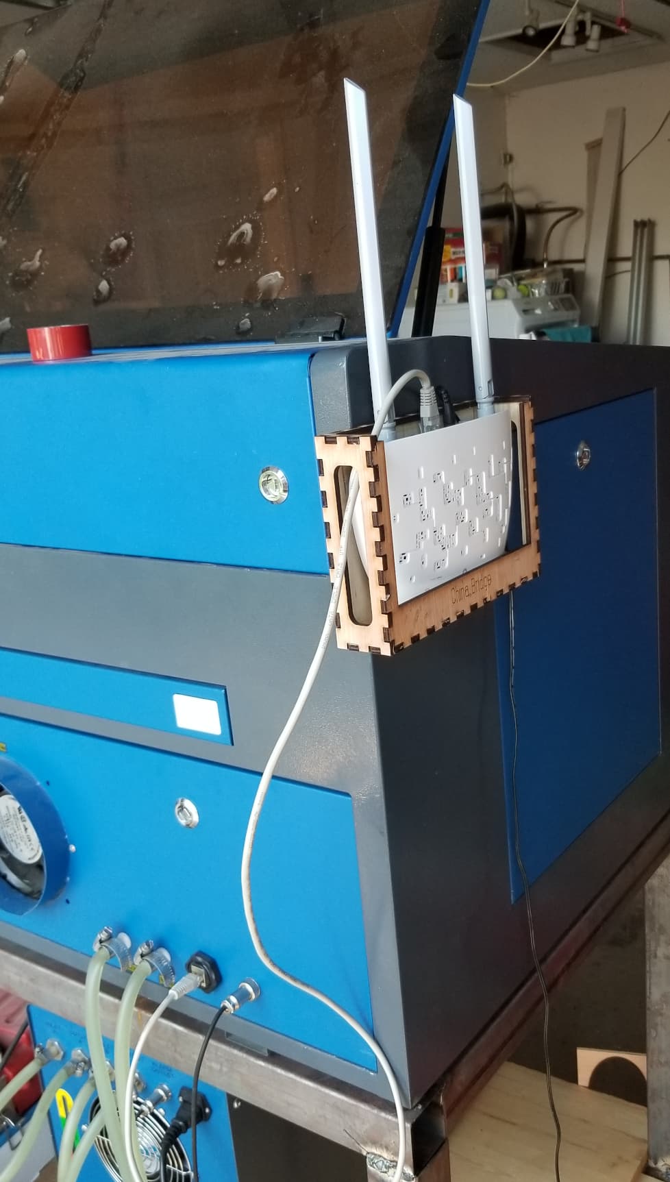

This is what I use to connect from my laptop to my Ruida China blue. It has worked more reliably than any other solution I have tried. Maybe 2 :busy or not found errors in a year:
I prefer this wireless feature since I tend to walk away from the laser when done and forget to unplug the USB cable!
Yes, it’s a relatively slow serial connection. If you add low cost parts along with poor cables it stacks the odds against you… Add that to the Rudia being a controller not a communication device… they can be a pain…
I have usb on the fiber and it fails now and then… wish it had Ethernet.
I ran a similar wifi bridge, similar to @patricr post, on mine until the Lightburn PI bridge was released.
