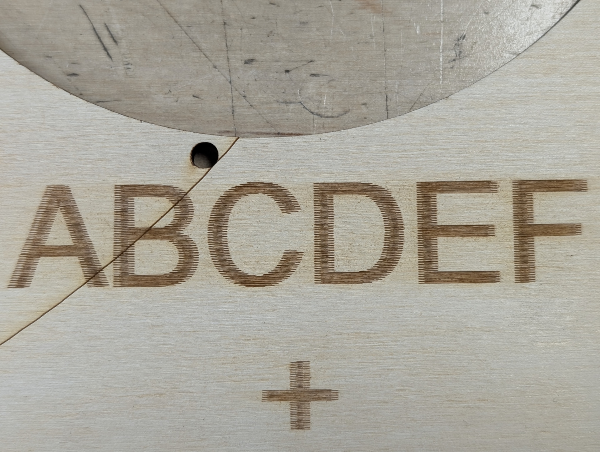

Recently saw a user who had glitch mid-raster and mostly ruled out any normal cause- then I found the user had set the raster speed to 1200mm/s, but the x-axis speed limit is supposed to be configured for a 1000mm/s limit. Ruida 6445.So this begged the question, what happens if you ask for a raster (fill, in this case) speed it can’t reach??Now if I asked for 5000mm/s vectors, it would probably scale back power just like it does whenever it’s not at the commanded speed. 5000mm/s 100% max/1% min power command, when it’s doing 50mm/s it will be 10% power. If given enough room, it should max out at 1000mm/s 20% power.
But raster doesn’t use power scaling. At least it’s not supposed to, except in grayscale, which is a very different thing.
I did some tests on a Ruida 6445 with closed-loop steppers and a 6442 with open-loop and asked for 5000mm/s 100%max/1% min power when they were supposed to be limited to 1000mm/s. Lightburn won’t stop you.
Best guess:
  1. neither one scales back the power.
  2. The 6442 seems like it decided to just override it and run at 1000mm/s
  3. The 6445 tried to go way faster than allowed, but the closed-loop drives allow you to get behind some amount before latching into a fault state. The fault state didn’t trip, but the drives appear behind by quite a bit. The motor drive itself may have imposed a speed limit on what it puts out, but may still be counting steps in correctly (not certain).

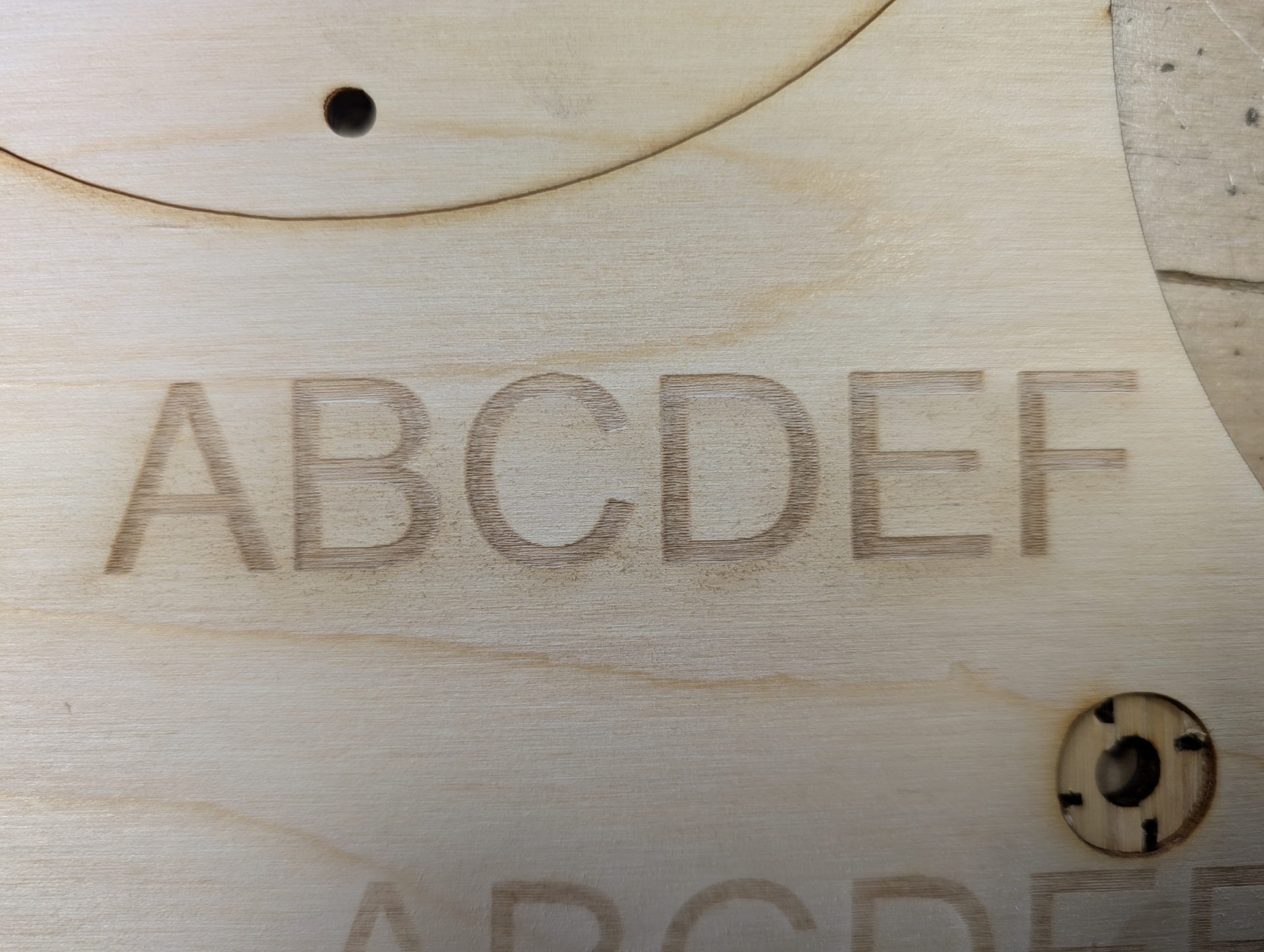

This is the 6442 with open loop steppers, those can just stall. It didn’t stall, and the raster is normal. 20% power 1000mm/s would not be enough to make a mark on this laser, so it didn’t scale. The panel said the job was 5000 99% but the top of the display said 1000 99%. But the 6445 seems to have read like that too. Thus my conclusion the 6442 just changed the speed and didn’t scale power

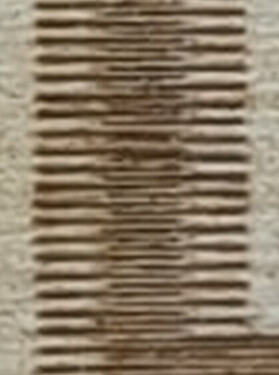

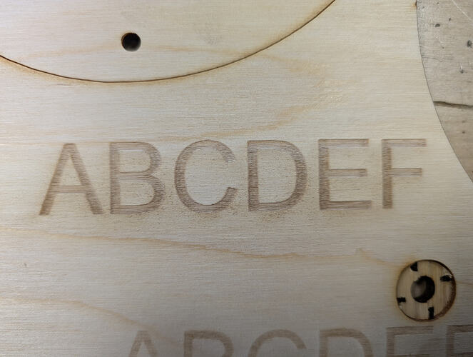

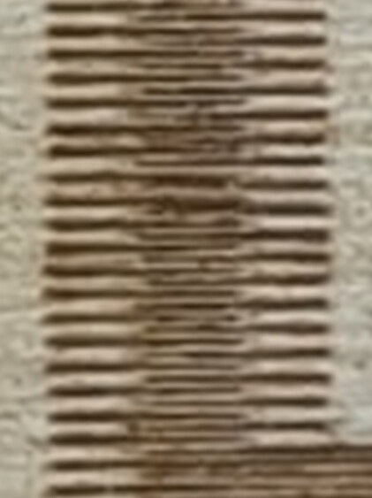

This is the 6445 with close loop steppers. There’s now an quasi-backlash in both directions, but no drive fault. What seems unusual now is the backlash doesn’t seem to catch up over distance, given more time to accel. Again, close-loops do not have a high speed stall like open-loop, they track rotor position and continue to drive out speed and torque when pushed too far, but can lag behind by a limited amount. Also, the burn is too dark for the power to have been scaled back. It’s something over 1000mm/s but I don’t know by how much, drives tried to go as fast as they could but lagged the whole line, then caught back up on the reversal.
If this were open loop on a 6445 asking for an impossible speed, I expect a stall and axis crash soon to follow. But the machine with open loop drives was a 6442, which looks like it made a saner decision to limit the x axis raster speed.
