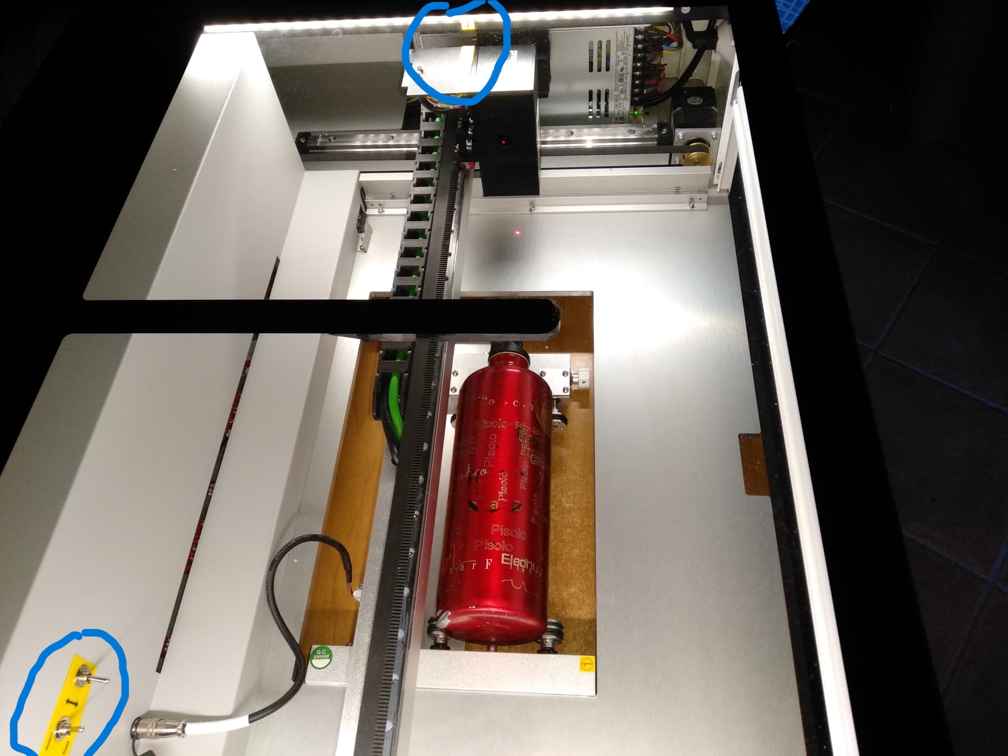

Hi, I just bought a Gweike Cloud RF laser, I’m’ learning how to use it with LightBurn, everything works fine, but I just have this problem with the rotary:
I place the laser at the desired position, select the option Star From = Current Position and select Job Origin to center, I play but the red light appears immediately and it doesn’t start.
Whereas if I select Job Origin = Top Right, it works correctly. Is this really a laser problem or am I doing something wrong ?

If you set your job origin to the top right, the job will engrave down and to the left of where you are. If you select bottom right, it will engrave up and to the left…
Make sense?
You are driving your machine out of bounds is what give you the error. It would be nice if those had a control panel… It would tell you …
Is there a way to set a user origin on that machine?

I will tell you the problem I need to solve:
I have a can of coke where I need to engrave a name in the center of the can in a certain position.
If I use absolute position, the inscription is printed in the center only the can turns 180° in makes me the name on the opposite side.
If I put current position with job origin = top left the print is correct only I can’t keep it in the center of the point. I should use the job origin = center, but that gives me the machine to go in error. Only the center because the others work correctly.

1)This is my machine, you can’t turn on only part of it, when you turn it on it starts all together and the fans make a lot of noise, I don’t have coolers or other kinds of external things connected it’s all one.
2)This is the rotary connected, the switches for lightburn must be in this position otherwise it doesn’t work, I placed the X-axis at the point indicated 1 (because I am using rotary number 1)
3)This is the initial position, as you note it marks everything to 0 because I am at Home
4)I insert the lettering in the center of the black point I had marked, place Job origin = center and position the laser in the center of the black point by moving the x-axis
5)I press play, the machine turns on the intake fan as if it had started but the red button immediately appears and does nothing. At this point instead of pressing the stop button I press the pause button, the machine magically starts but only prints half the writing.
I cannot understand all this mystery.
It would seem that lightburn at first sends some command that angers the machine, but then however the rest works. I tried repressing play instead of pause but it does nothing.

Thanks for the extensive setup… I will have to think about it a bit to give you some kind of suggestion. It still sounds like it’s going out of bounds…

Yeahhhh IT WORKS !!!
Your off-axis theory was correct. I understood why, when I positioned the laser, the Y axis was set to 0 not accepting the negatives, it could not go back to do the rest of the writing and went off axis causing the machine to go into error. to avoid if the machine has to go back and forth on the y axis, I position the y axis in the middle of its scale y= 145 which is that of the complete rotation of the rotary in my case y=290. This way everything works perfectly.
Thank you very much for your help which has helped me to think about the out of scale.
Aurelio
