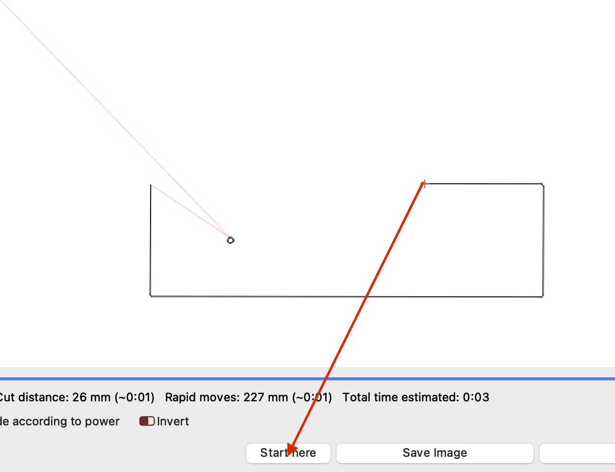

Windows decided to update halfway through a fill job and it terminated. Is there a way to run the fill backwards so I can just stop it when the points meet so I don’t have to start it all over again? I tried messing with the Optimization settings but no matter what I did it always started filling from the bottom up. I’d like to start it from the top and work down. Thanks.
There is a super nice feature for just this problem, give it a try.
Go to the preview menu and set the slider to the position you want to resume your work process from and start it
