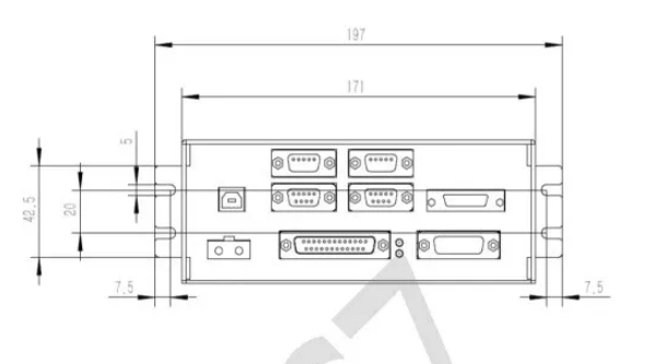

I was poking around in what little documentation was available for JCZ Lasers. If your interface looks anything like this (below), I think you’re SOL. They seem to be using technology from the 80s. Even their video setup looks like it was done on Windows XP machine. The USB port they show is a USB 2.0 Type-B that won’t accept a thumb drive. The large connection at center bottom looks like a parallel printer port. I haven’t seen those on a PC since about 2005. The four ports above that are serial ports. No better than USB 2.0. I’m affraid you’re stuck with outdated hardware.

We have nothing like that. The back panel is solely power, one connector each for galvo and rotary, and the USB port. It would be a simple enough affair to pop a hole for any other type connector, but I don’t know if there is even the base line capability for the machine to accommodate such a concept.

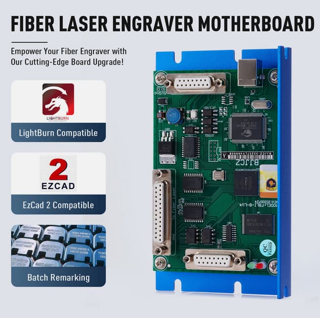

Most of these boards look something like this
As far as I know, there is no other use for the usb port except to talk to the device and it’s a type B connector on my machine.
I still only see two serial and a parallel port. I guess that silver box at the top must be the usb port. I didn’t see anything like that. I must have been looking at old-er stuff. :wink:

Yep… it’s a type B usb connector.
