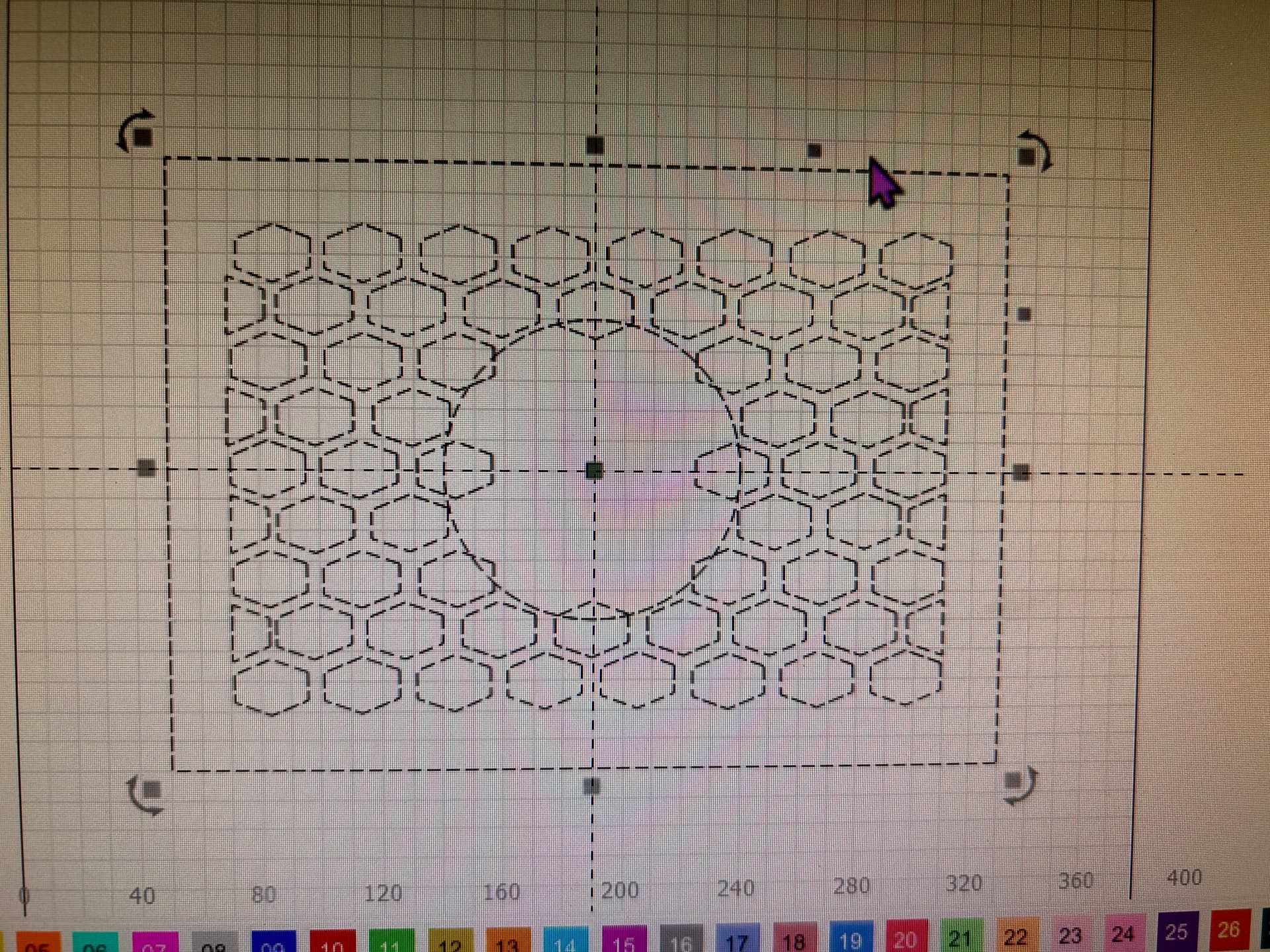

i have created box lid with mosaic diagram as per the photo.
I want a clear circle (not to cut) in the center, so i wanted to know how to remove the pieces of mosaic which encroach into the circle…
  1. Ungroup all
  2. Group all mosaic pieces
  3. Select mosaic group
  4. Add circle to selection
  5. Tools->Boolean Difference
Here’s a good video on using boolean operations…
