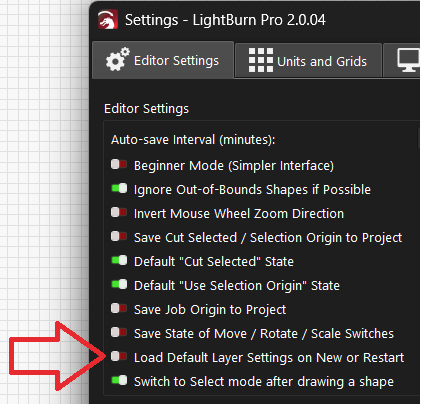

Check to see in your LightBurn settings–> Editor Settings, that you don’t have “load default layer settings on new or restart” enabled.
I have neither of these issues so it likely is a settings thing.
