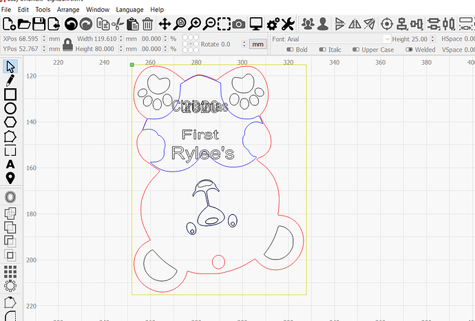

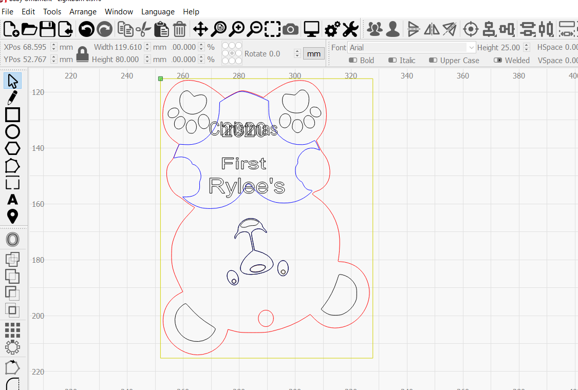

Can you show me a screen shot of what you mean? You say “results in things out of alignment or inverted” - what kinds of things?
So this example after saving and re-opening later the bear is flipped upside down, some of the text lost its alignment and flipped…
You didn’t include the rest of the window, so I can’t see where your origin is, but that’s likely the issue - you’re loading a file saved with the origin in a different place than when you loaded it. Have you moved the location of the machine origin since you saved that file?
