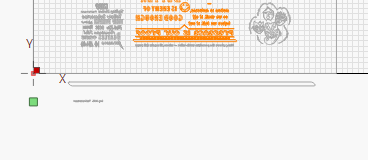

  1. I have a project in LightBurn using Absolute Coords.
[image]
  1. My Machine is set as GRBL, Using OpenBuilds X32 Controller.
  2. My Machine is oriented with home being at the bottom left corner (its where I always start my work.
  3. I do not use Lightburn to run the job. I use OpenBuilds Control software as I find it much easier to use, and has the ability for me to use my iphone to home the machine to where I want to start my project on my table.
  4. I Save GCode.
  5. When I open the gcode in note pad you can see an issue right away. Its wanting to move into the negative space outside of the bounds of where my machine is already homed: (What am I doing wrong?)

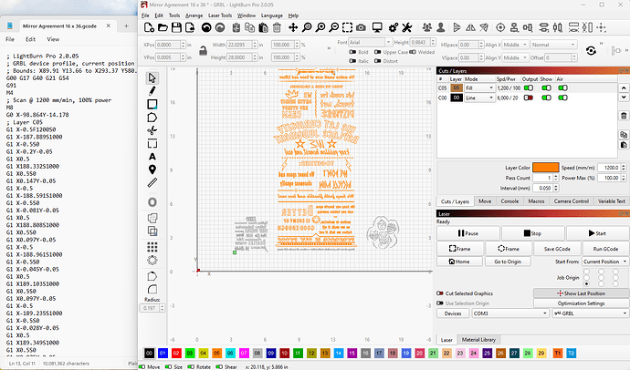

I think I may have figured it out.
I tried to restart lightburn and tried to save Gcode again and possibly fixed this issue? Is this a bug in lightburn?

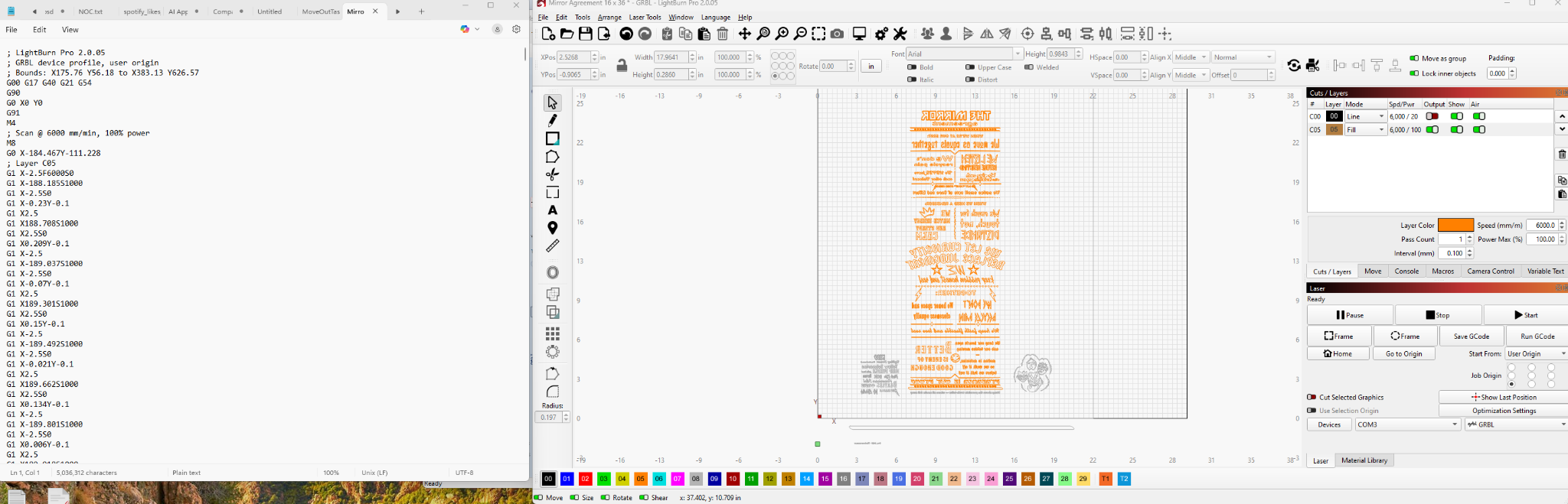

looked closer and its still trying to move the head -187
; LightBurn Pro 2.0.05
; GRBL device profile, user origin
; Bounds: X177.68 Y58.18 to X381.14 Y624.57
G00 G17 G40 G21 G54
G90
G0 X0 Y0
G91
M4
; Scan @ 1200 mm/min, 100% power
M8
G0 X-186.636Y-111.203
; Layer C05
G1 X-0.5F1200S0
G1 X-187.889S1000
G1 X-0.5S0
G1 X-0.2Y-0.05
G1 X0.5
G1 X188.332S1000

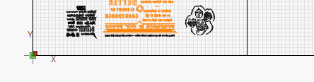

Your screenshot shows you’re using user origin rather than absolute coordinates, as you stated in your initial post, with your origin point (green square) outside the work area. If you’re not connected to your laser through lightburn I don’t think it can know what your origin point is so it’s assuming it’s the machine origin (red square) position. Move your graphic so the origin point is within the workspace and see what that gives you.

Is there any way to move the Green Square to x0y0? (like the red square)?
Yes, move the graphic up or use absolute coordinates. In user origin the green square is at the location of your graphic that you chose with the 9 dot selector. You will still need to move the graphic up in absolute coordinates because it’s outside the work area.
Try using current position rather than user origin.
AHH So its looking like regardless of my layer C00 being set to output. It always puts the Green Square to the same XY axis to that.
When I remove the graphic (which I moved as I wasn’t sure if I wanted to add it).
It moved the Green Square to the proper place.
Using Current Position and Job Origin to lower left corner.
Looking Better, but seems strange that unlike in VCarve where you setup a job and define the material, place your design on the material, and set your origins it just works regardless of what you have on the screen you only generate gcode for the items you have created cut laser layers for.
His should solve that issue. Use the cut selected graphics AND use selection origin switches. That will cause it to only look at the selected item for origin placement.

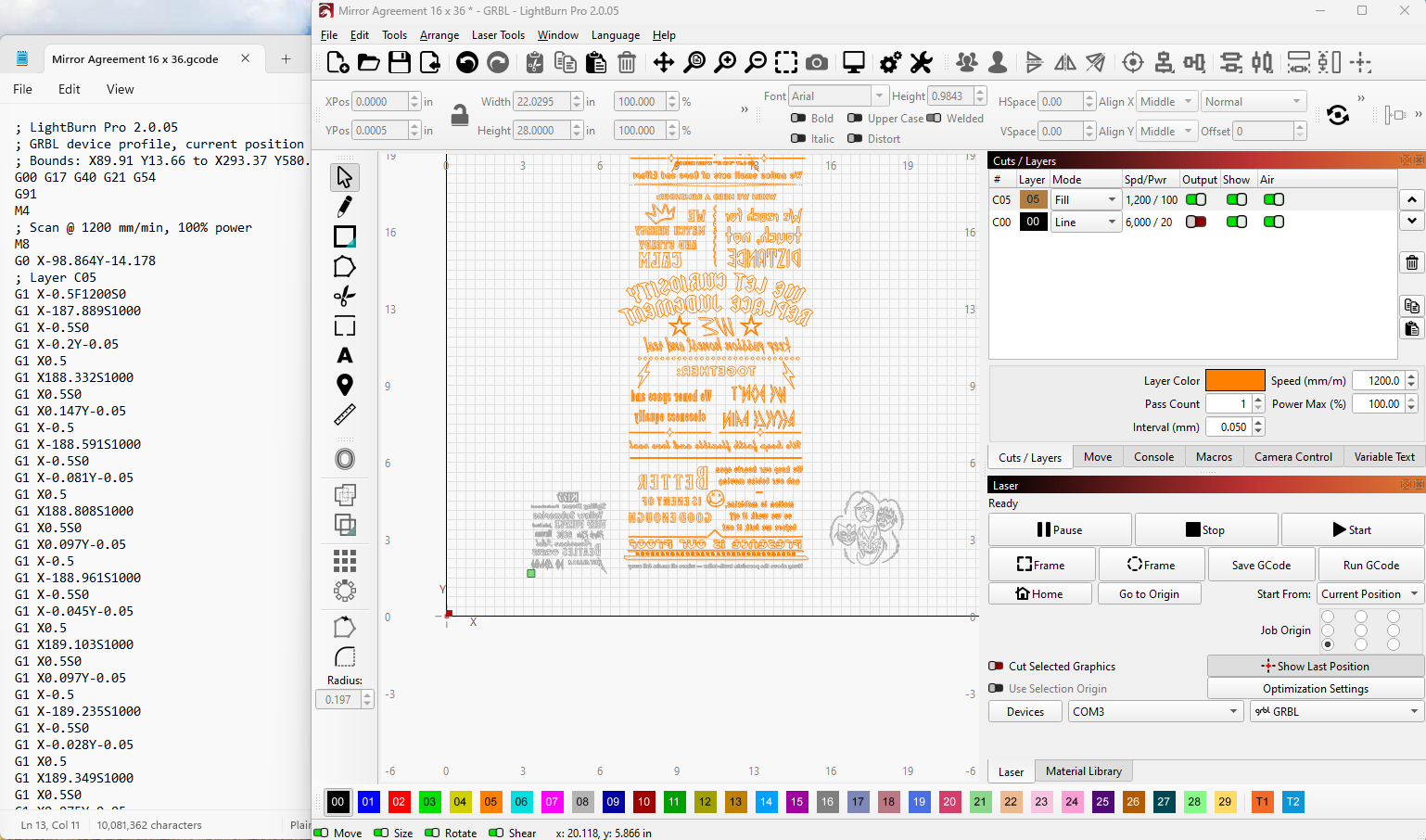

Your machine origin is probably in the back right corner, so when you try to run any absolute coordinate jobs all the values will be negative.
To fix that usually you would need to set the device origin to back right, and enable the ‘CNC machine’ option.
So it was the Enable CNC mode that tripped up the entire process.
Once I turned this off it worked as normal.

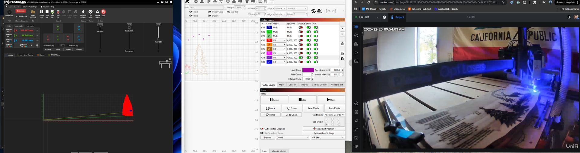

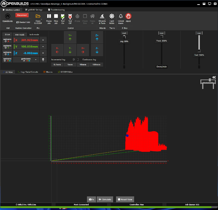

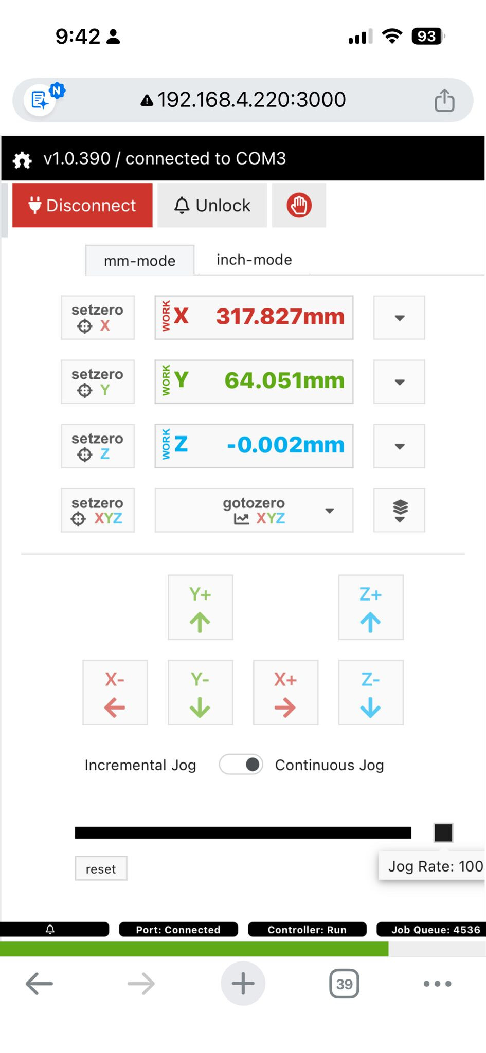

I tried to use LightBurn to design and run the job but I cannot STAND the jog controls built into the software, then again coming from OpenBuilds Control, its like going from a BMW to a Pinto IMO.
My favorite Feature of OpenBuilds Control is the Remote Control on your Phone:
I use this to set my machine where I want to start the job, often Im running different jobs that require a new origin. With LightBurn I have to walk back and forth trying to Guess how many times I need to jog the machine (annoying). My computer is on my workbench with my machine about 10 steps away.

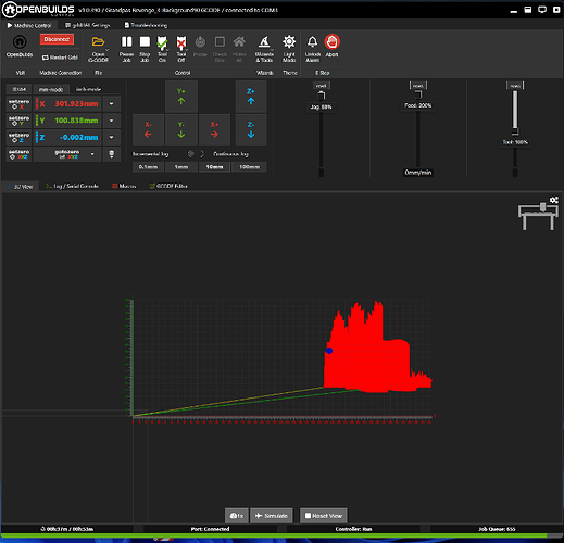

And then the main screen has so much control and job recovery which makes life so nice:
So my workflow is as follows:
  1. I layout my design on my office computer.
  2. Save the Gcode to my Server
  3. Workshop computer loads the file into OpenBuilds Control.
  4. Using my Iphone to control/jog the machine I can precisely set my origin. Or Move the head out of the way when I am inspecting the job.
  5. I can continue to work on other projects in Designer like LightBurn or VCarve.While watching the job remotely in my office (Next room over).
