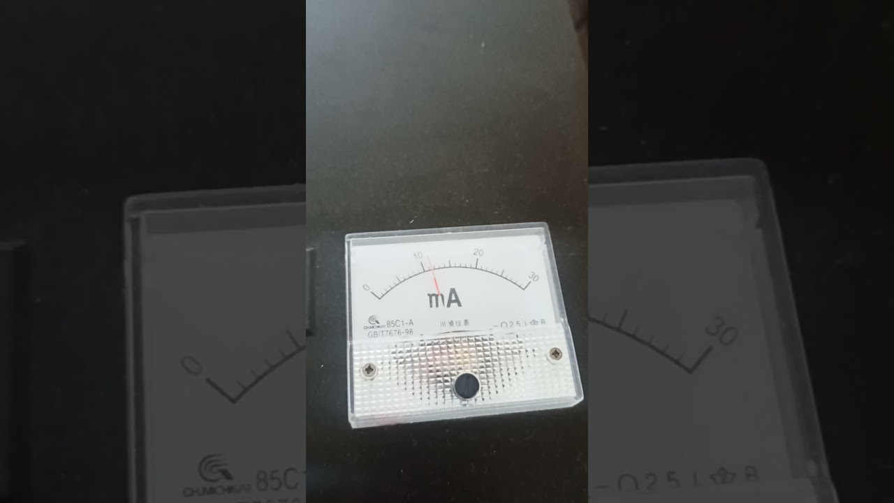

Hello,
if i use my laser with my Win10 pc it have short braks in the job.
if i use my laser with my notebook, all is fine.
i use lightburn 9.20 with mks sbase an have win10 pc with ryzen 1800 and MSI X570 Board.
Bios and driver are up to date.

If i cut a line, the problem isall time the same position.
[![](https://img.youtube.com/vi/s_AkYUa6Sjs/maxresdefault.jpg "4. August 2021") ](https://www.youtube.com/watch?v=s_AkYUa6Sjs)

In preview from Lightburn i can see the probleme
So it is a problem from Lightburn ☹
if a tool availeble for clean uninstal lightburn
so that lihgtburn after new instalation no old data used.
<div class="post-metadata">
**Author:** ![Alf3181](https://forum.lightburnsoftware.com/letter_avatar_proxy/v4/letter/a/3d9bf3/32.png) [@Alf3181](https://forum.lightburnsoftware.com/u/Alf3181)\
**Post date:** [August 8, 2021, 6:52am UTC](https://forum.lightburnsoftware.com/t/sbase-short-breaks-with-pc-but-no-problems-with-notebook/45127/7 "2021-08-08T06:52:20Z")
</div>
Tabs must set to disable !!!
