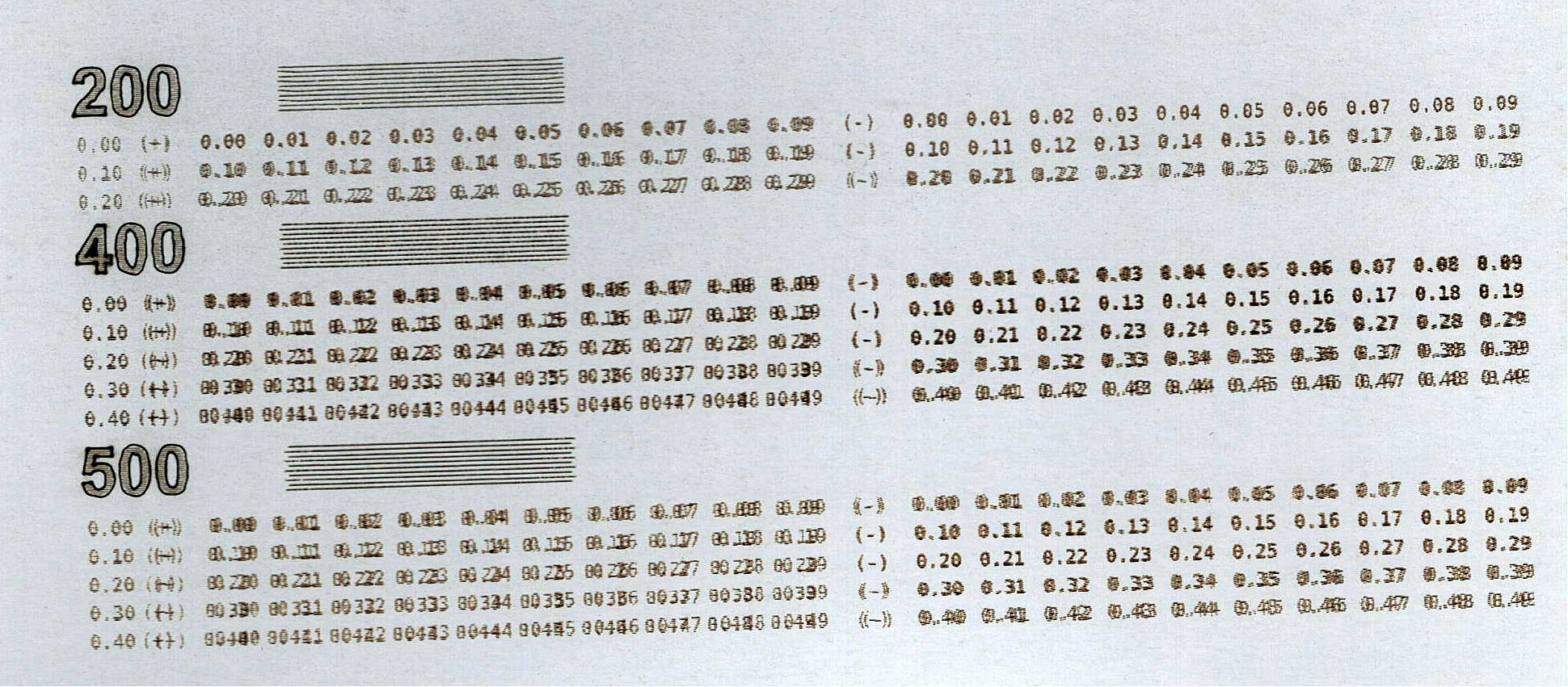

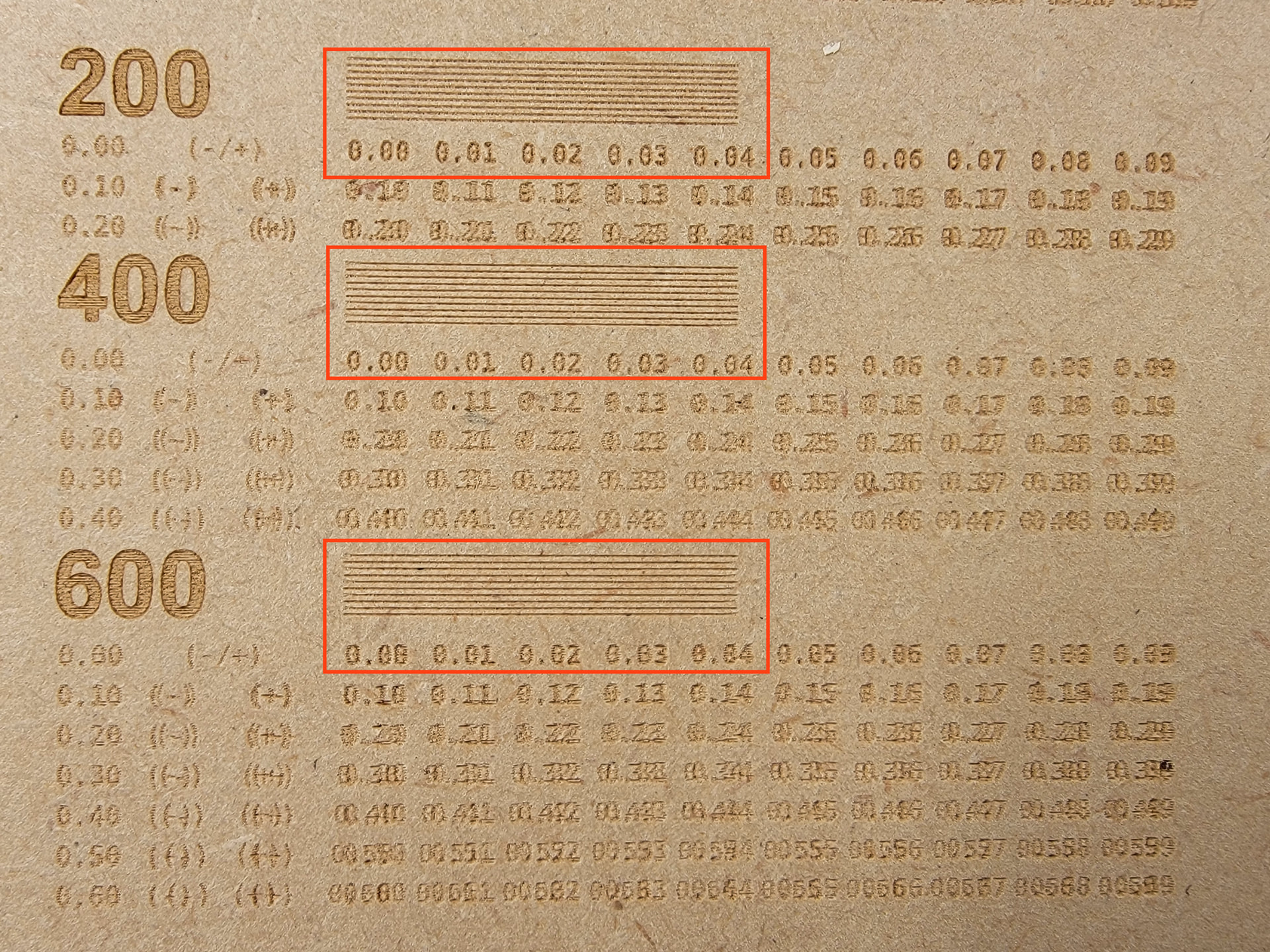

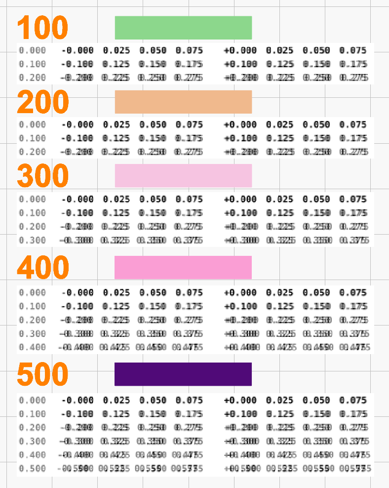

I’ve just been playing around with this calibration image which, when output (using bidirectional engraving, ‘Threshold’ mode, and 0.1mm line interval), should immediately reveal the correct “Line Shift” value for any speed you run it at:
This project shows how it can be used : scanning_offset_grid_v1.lbrn2 (328.5 KB)
It is currently set with power values to suit an 80W CO2 machine so adjust the power % to suit your machine:
How to use/example output:
Disable any existing Scanning Offset Adjust and run the “scanning_offset_grid_v1.lbrn2” test file, circle the sharpest most readable figures, these are your ‘Line Shift’ readings:
Where there are several in-focus, just bracket the sharpest group and select the middle one.

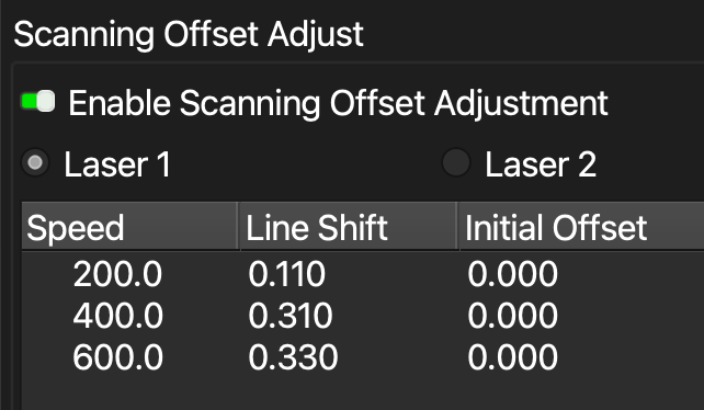

Enter those figures into your Scanning Offset Adjust and toggle on ‘Enable Scanning Ofset Adjustment’ :
Run the test again.
You should now see the edges of the rectangles are no longer fuzzy and all the other figures in the grid should be fuzzy except for the first few in the 0.00 row.

-The large numbers are filled with a vector outline intentionally to confirm the fill is in alignment with vectors (‘Initial Offset’=0).
-I used 200, 400 and 600 because I mostly engrave at around 400mm/s, and I’m happy that any other speeds will be covered by interpolation, for example, in this case:
300 will be 0.21
500 will be 0.32
-Don’t scale the image since the pixels are arranged to line up with a 0.1mm line interval. (It might be possible if you were careful to do the same with the line interval, haven’t tried it).
-Polarity: The calibration image includes a positive and negative sign at the start of each row, if you only see a (-) at the start of the row, then your machine is different, let me know and I’ll post a different image (or use the figure in the leftmost column). And if you enter the value but the results are twice as bad, then change the polarity (-/+) of the Line Shift entry in LightBurn.

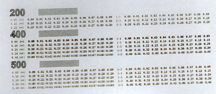

Definitely the case with a KT332N controller with a 500 mm/s speed limit:
The measured values I’ve been using seem fairly small:
Try this one, but ignore the polarity when you enter the figures:
scanning_offset_grid_v2_dual_500.lbrn2 (195.9 KB)

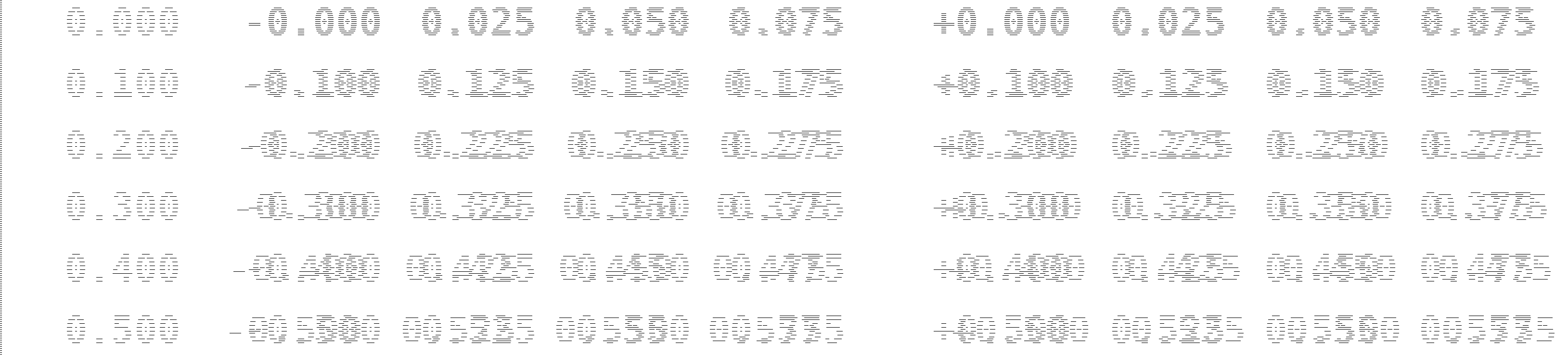

Thanks for the nice test. However, I have more difficulty finding the appropriate number than comparing the ends of the lines.
With a good magnifying lens and a little patience it works.
And for the final fine tuning, patience is always needed. :+1:
Looks better:
The best matches over on the right agree closely with my original values.
The sign, as you suggest, is wrong, but the KT332N has other peculiarities.
Being me, I want more granularity in the speed, maybe steps of 100 mm/s from 100 to, say, 700 mm/s for the speed demons out there, but that’d make a daunting layout.

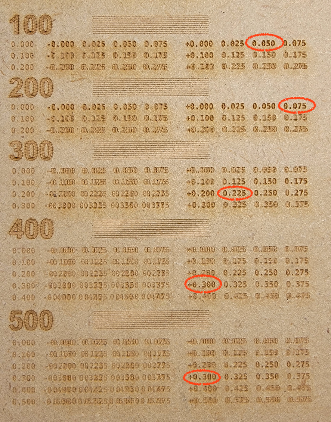

Because I don’t know how precise LB interpolation works with my machine, I’ve done tests with 50mm/s interval.
Although I also end up at 500mm/s, on my machine (same as @ednisley ) it is unrealistic or better said, not advantageous. Between 250 and 300 mm/s for not too big shapes, is the breaking point where higher speed means higher total times.

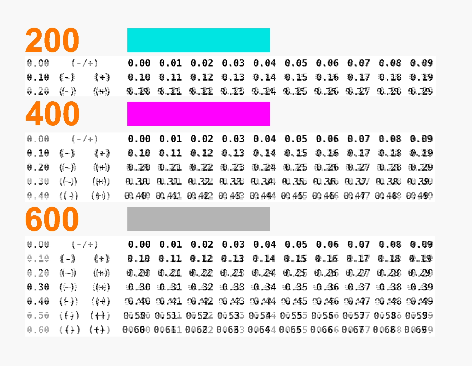

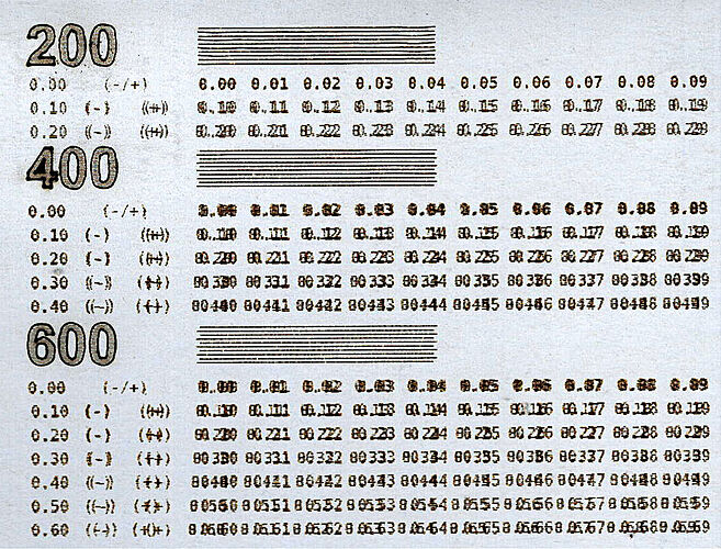

Here is an updated version of this tool. I discovered a mistake with the last one, I realized that it wasn’t actually being sent to the machine at the resolution I was expecting (the line interval was affecting/capping the horizontal resolution).
This one works at a higher resolution, so is more accurate. I’ve added in extra bands, at 100mm/s intervals, but not to 700mm/s - anybody can modify this project and duplicate the 500 image to use with faster speeds if needed (all the images are exactly the same and have just been duplicated and cropped for the lower speeds to save time).
scanning_offset_grid_v3_dual_500.lbrn2 (248.5 KB)

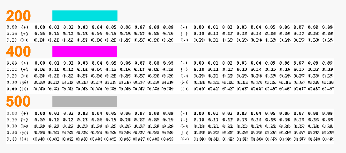

Test result:
Line Shift Entry:
Note: I set 500 to slightly more than 0.31 just to keep the interpolation working correctly for the higher figures.
Final result with Scanning Offset Adjustments enabled:
You should see crisp edges on rectangles and the first row of each block.

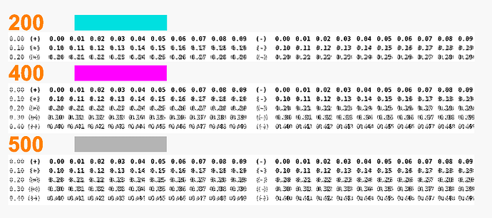

Ran without complaint here with “the same” KT332N as your machine. :exclamation_question_mark:
Apart from flipped signs (which may be an intractable issue), the results again agree with my previous measurements:
I dial the power back to 10% under 300 mm/s, but the tight line spacing hits the cardboard hard and the 200 mm/s image is overcooked.

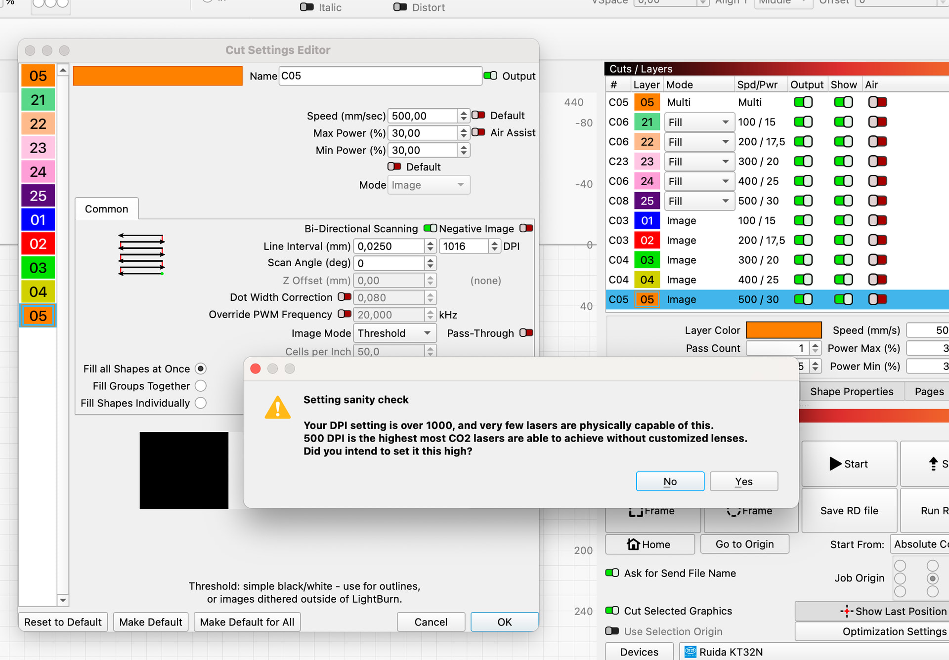

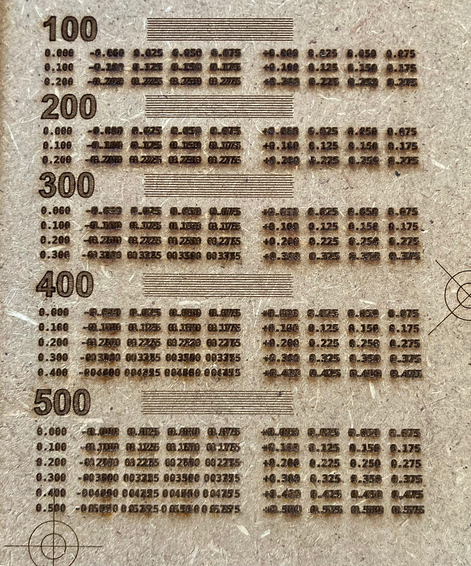

I’m on the latest Beta version of LB, but I get what I sent, it’s strange.
The modified test, with a line spacing that makes more sense, I get this result. I also had to adjust the power setting a little.
But, I don’t get any usable example with these settings and without offset compensation.
On the left is the same engraving with my correct offset compensation values, on the right without.
I will try later on white cardboard, but the error message/warning I don’t know why it’s only here with me.
Ignore that message and don’t change the line interval, otherwise it won’t work. The line interval is ridiculously small to make sure the bitmap is processed at a higher resolution. I does result in a lot of activity which is a pain, but still works if you reduce the power.

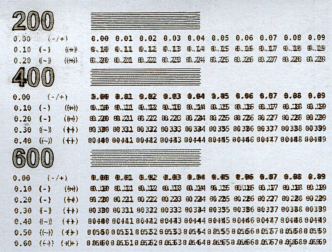

Alternatively, try running this image with “Pass-Through” enabled, it will use the high resolution of the file to resolve the small horizontal shifts, and with the help of Claude I “thinned” the image by 75% to prevent the small line interval that was hurting the last version. There is a thin “timing” band on the left hand side (don’t crop it out, or change the size of this image), intended to keep the return scan at a regular interval so the polarity feature stays intact.
ok, I’ll try it as soon as possible, thanks
Hi Nicholas, I have repeated the test as recommended and can clearly see the difference, even though it is on MDF, which is not particularly suitable for this type of tasks.
There are a small error in your version 3, 100mm/s has become 200mm/s…, but I could easily fix that :wink:
On the right material you can quickly and easily find the clearest values, then just choose the middle one.
It should be included in the LB official test series. :+1:
Thanks
Thanks, good spotting, I’ve updated that, and added an example on the right side using the newer (faster) grid.
