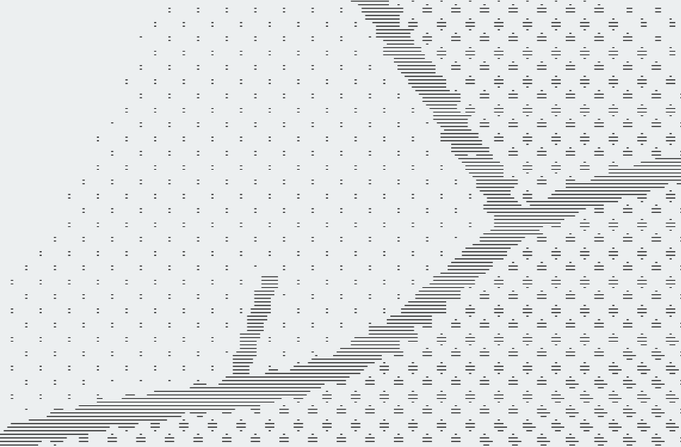

Proof-of-concept method for creating screen printing stencils with a laser:
This eliminates the messy part of stencil production with the traditional UV exposure method and cleaning.
A test on paper looked convincing.
 ![PXL_20251121_230201109 (2)](https://forum.lightburnsoftware.com/uploads/default/original/3X/d/1/d158d53f1f2ea887088292154932152734aaec3f.jpeg)

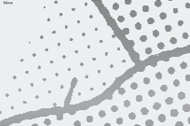

The [Image Mode Newsprint](https://docs.lightburnsoftware.com/2.0/Reference/CutSettingsEditor/ImageMode/#newsprint) works, but I later found out that Halftone is even better suited to make bigger dots for more paint to get through.
Newsprint vs Halftone @ 0.05 Line Interval:
 ![image](https://forum.lightburnsoftware.com/uploads/default/original/3X/2/3/2341dfa3733a30053e4f8081aa2622e6b6d3972e.png)
 ![image](https://forum.lightburnsoftware.com/uploads/default/original/3X/5/2/5268b93888995ab4b44eba48392161b993cc975b.png)

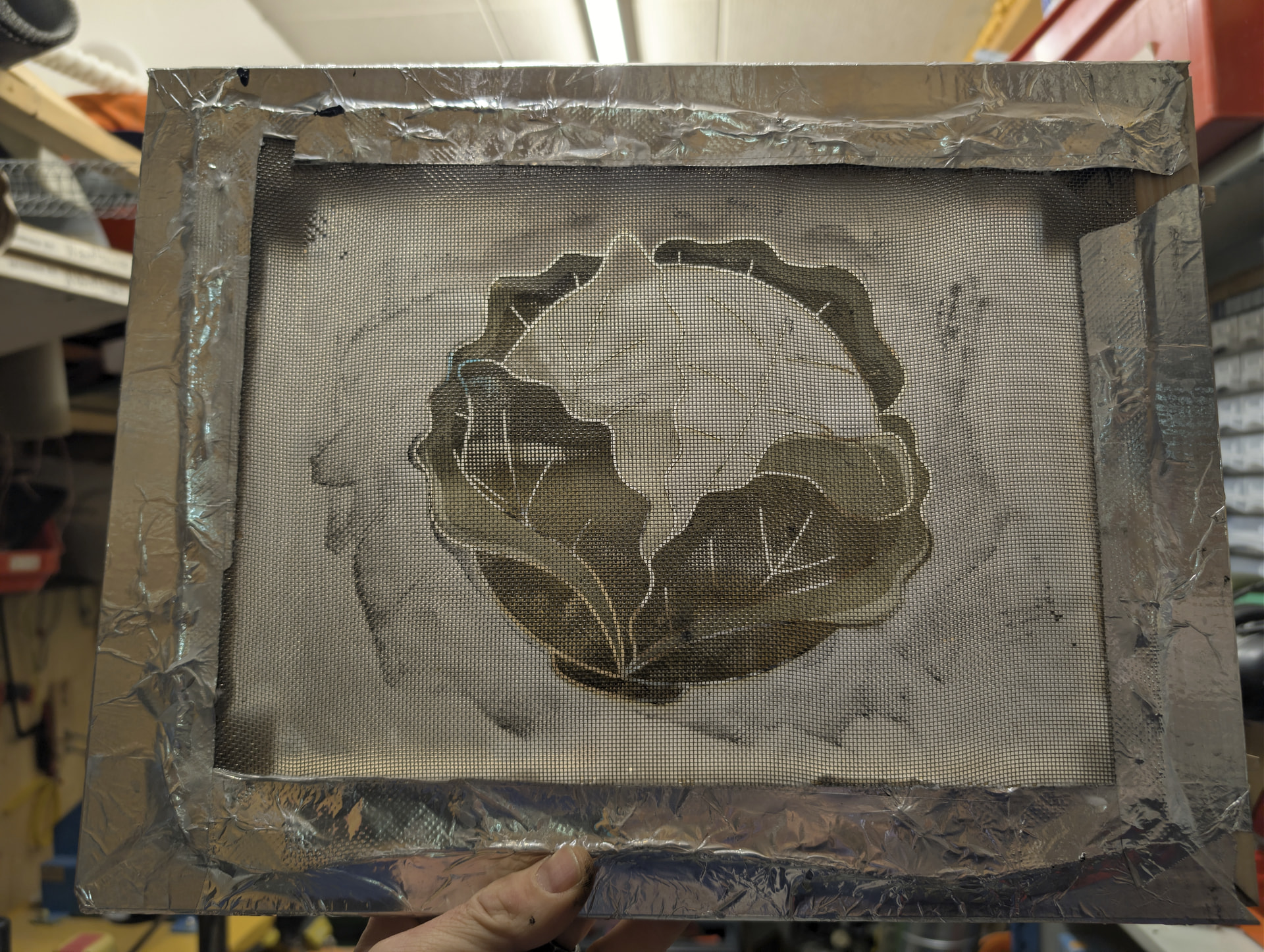

I stretched stainless steel mesh over a picture frame, coated it with **white glue** , and etched it on a CO2.
A diode laser should work; however, the lower wavelength heats the metal more, which makes it somewhat more challenging to find the correct power settings.
 ![PXL_20251121_230243443 (1)](https://forum.lightburnsoftware.com/uploads/default/original/3X/e/1/e153d48164c630e3ba7fc6b3de53b2f3f5568055.jpeg)

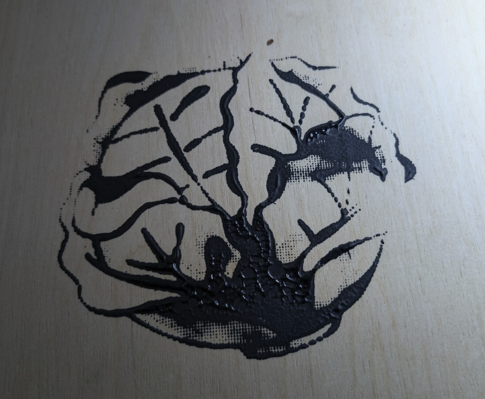

Did a quick print with way too much acrylic paint, and the mesh wasn’t flat enough, but it works! 🙂

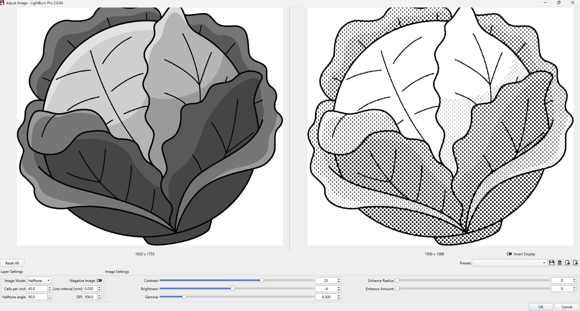

Okay, [Halftone Image Mode](https://docs.lightburnsoftware.com/2.0/Reference/CutSettingsEditor/ImageMode/#halftone) will work _way_ better!
The Cells per inch value is a helpful variable.
