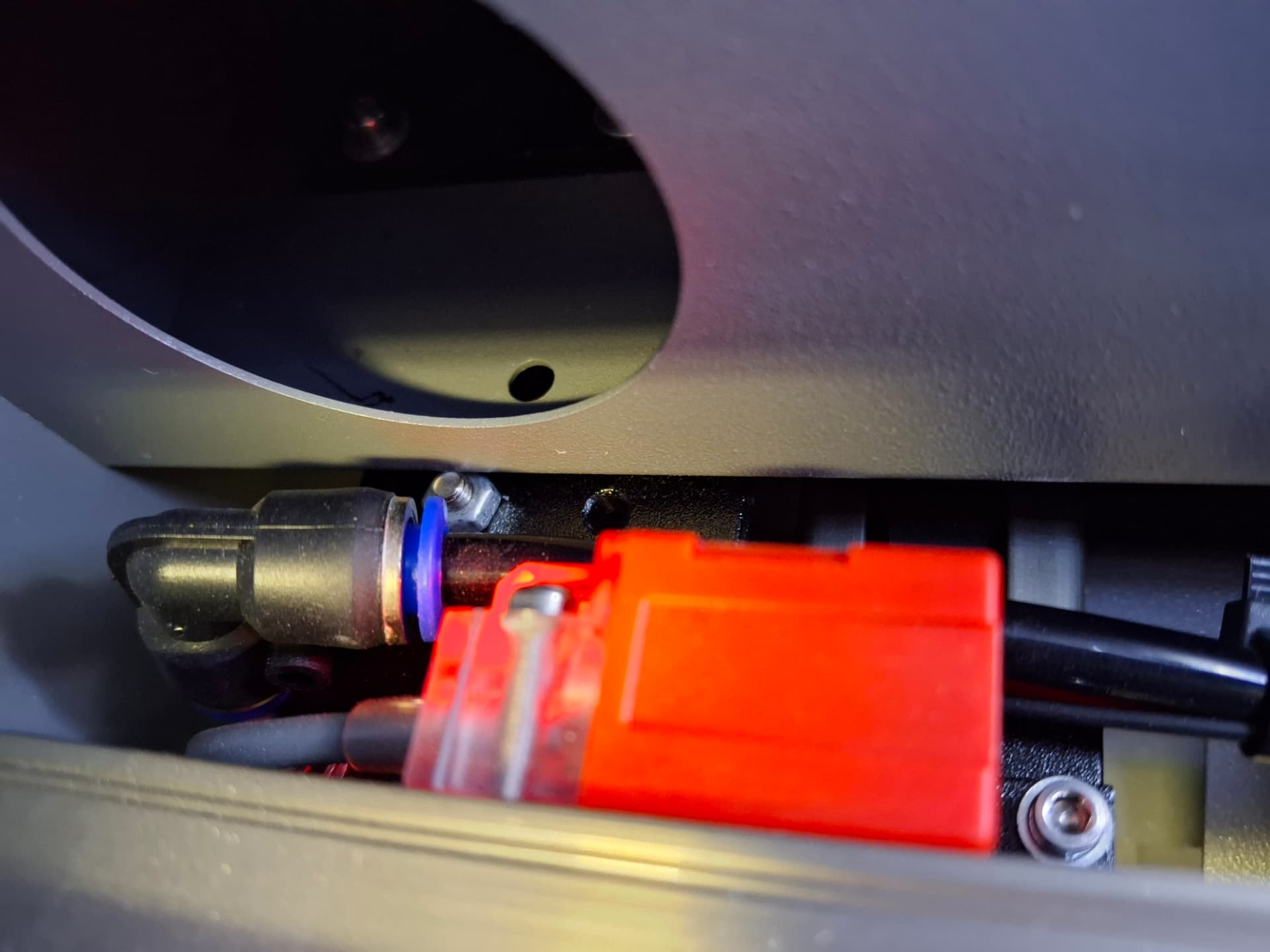

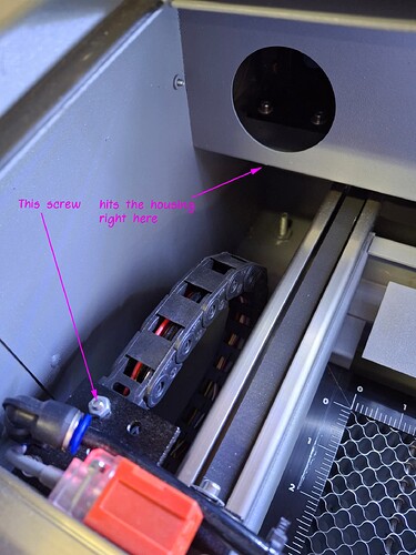

This is an Omtech K40+ only a few months old. I wondered why homing the machine would have the test burn spot so far ahead of the edge of the honeycomb insert. To reach the upper back of the honeycomb table, I need to reposition it up next to the drawer front. Hmmm.
Today, I was pushing the head back to home manually and it clacked, for lack of a better word. On looking closely, it appears that there is a screw on the left side that hits the housing of the machine itself. It’s always been like this. Clacking away, I mean.
My question is whether I should grind down this screw so it clears the metal in the back. Is this even normal? The machine actually seems to run just fine, but I worry that something’s off and I should try to fix it.

If you use a smaller screw (to have a smaller nut) with washers?
I was kind of thinking along the same lines as you, but gads, getting in there to change it out looked like it may be a major undertaking. LOL, that’s where the idea of grinding off the excess came from. I wonder if others are assembled this way. Or if this is even a problem. It definitely hits first when it goes to home, but then the machine and lightburn don’t complain about that fact, either. Hope I’m not borrowing trouble where there is really none. Thanks!
Which means the home position is just slightly inconsistent: definitely not what you want.
I regard my OMtech laser as a large parts kit closely resembling a functional laser, ao I feel free to crawl in there and make it work right (according to my definition) by applying enough labor and material to finish the last 10% of the manufacturing job.
Like, for example, all the latches on my machine now work the same way. :hammer_and_wrench:
It looks like a pan head screw would fit under that housing / vent / whatever, with the nut on the inside of the drag chain where it’s really hard to tighten. I betcha that’s how it was specified on the prototype of that machine, but the assembler just couldn’t be bothered with fussing around.
Alternatively, stick a sheet metal snippet on whatever surface the proximity sensor detects to move the home position few millimeters inward, thus ensuring the screw doesn’t quite kiss the housing.
Make it work right and sleep well at night … :grin:

I doubt it’s going to cause positioning issues, but it will cause a speed change when it rubs during a job.
It doesn’t really rub anything during a job at all, so I wasn’t concerned about that. It just seemed weird that when I manually push the head back while fooling with positioning the next project I’m going to wreck (JK) that the screw would slam into it like that. Just didn’t seem right.

I got out my ancient Dremel, and a metal cutting disk and whacked it right down to the top of the nut. Plenty of clearance now! It seemed like the easiest way. I didn’t relish the idea of digging down into it to replace the screw with a smaller one.
