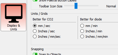

After spending 2 days to connect my Sculpfun S9. I finally started to engrave so test runs. The weird thing is that my laser only starts engraving if I put the power to 100% and at speeds of 100 to 300 mm/s. That is really strange since I keep seeing tutorials with speeds around 2000 mm/s and more.
Do you know what is going on ?
Thank you for your help.
You are probably mistaking mm/s for mm/min
You are a boss !! Thank you, that was a quick fix.
