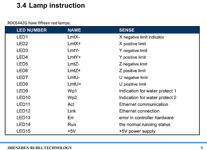

I purchased this machine used and partially apart. They had installed the laser power supply and the 100 watt tube. the interface panel on the top of the cabinet was installed but the controller was just in the box. I never saw it work. So I am very new t o all this and am learning fast. indicator led lights, #3 lights a couple times when first starting up, once the head stops 14 comes on and flashes, #15 comes on when powered up and stays on. I go to the diagnosis panel and I cant access anything there
the only thing that I can get to light up is the read button and if I hit enter, no changes
Your controller usually has the legend to the leds, doesn’t yours?
If 13 is lit, you have an internal hardware error. 15 (5V) is usually lit and run flashes. Link also flashes if you’re using Ethernet and moving data.

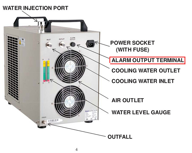

Thanks for patience and for your help so far. I finally got time to spend getting my head wrapped around these concepts and watching the machine to understand what was happening . I think I have my movement and distance problems solved. I have the settings close enough to be able to wait now until I can actually cut something and then finally tuning to get it exact. Next step, get something set up for protection with water flow. I have a CW-5200 Chiller. is there any circuitry built in to tell the laser controller if it is running or do I have to purchase a flow meter / switch or such

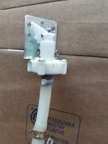

My laser had a pressure switch that grounded the CN5-4 or WP1. Looked like this.
I used it’s wiring from the connector to Ruida, since it was in place and the switch was near where the coolant entered.
With a chiller, it monitors not only coolant flow but temperature. Ground H1 and wire H3 to CN5-4 or WP1 on the Ruida or vice versa.

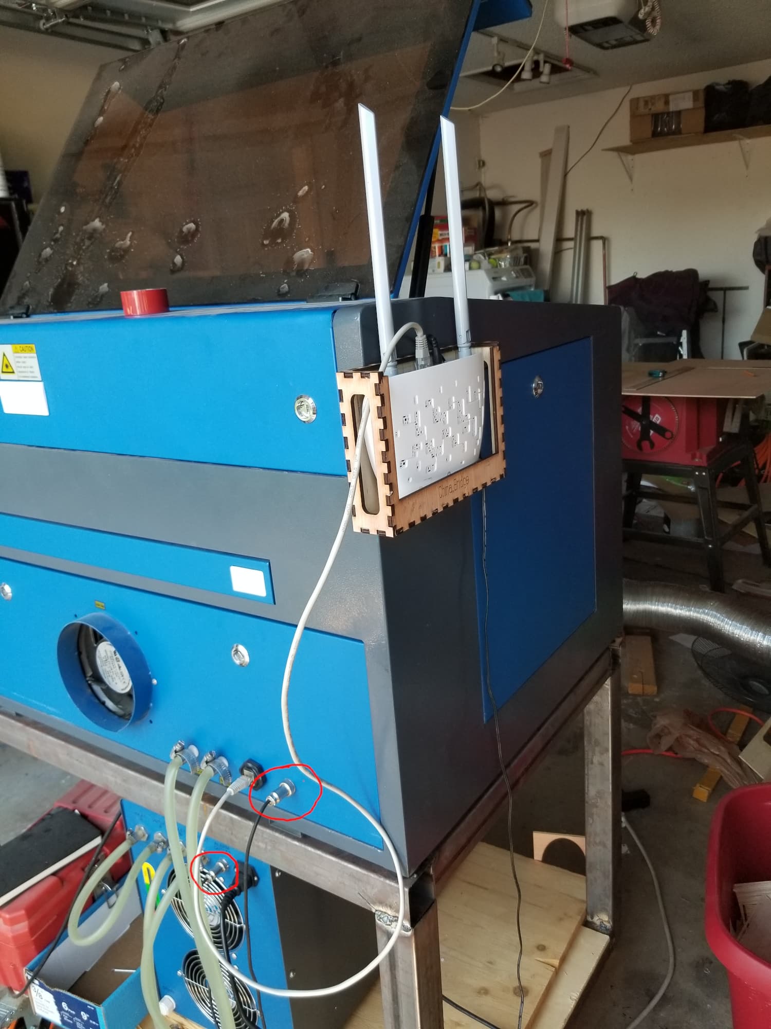

This is mine, with the chiller connections circled in red.
Make sense?

As @jkwilborn points out, all you must do is wire the chiller to the controller’s WP1 input and you’re good to go.
My LightObject Q600 chiller has slightly different plug wiring and I added a matching aviation connector to the laser cabinet:
The machine had an internal flow sensor, so I put the chiller’s alarm wiring in series with it so they both have veto power.

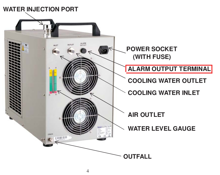

can someone tell me what plug I should look for on the CW 5200 chiller
I think this is the 16mm plug on the chiller… Others can confirm. It was so long ago I purchased one, that Amazon can’t find it in my orders.
There isn’t much choice as there’s only one.

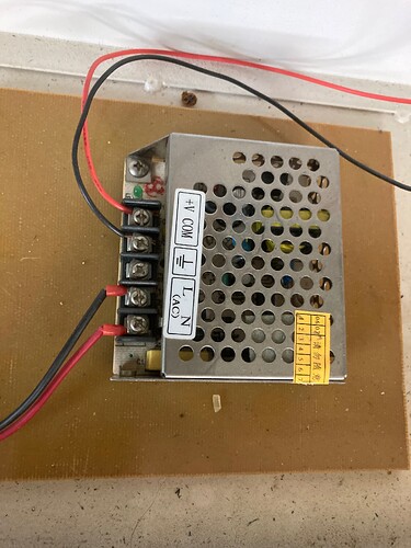

Wow, Thanks to you folks I am just about ready to see if the laser will fire. Then I can start aligning the beam and mirrors. I have the water protection cable wired from the chiller to the controller. One more small detail. The little light that is mounted down on the laser head that is suppose to shine onto your workpiece showing where it will cut… the two wires are connected up to the laser head light… where do the other two go that powers it?
