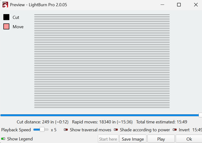

When I would open a saved file it would import all the speed, heat and interval settings. Now, those settings are gone. I manual reset the settings and the interval is way off. I usually engrave on wood with a .06 interval but now a .06 interval is spaced out way to far. Any suggestions as to why this would be happening? Thank you.
I have tried several different files going back 4 years and a newly created file. Just installed update too (after problem, hoping it would fix it.). What used to take 45 min to engrave is now saying 15hrs! :thinking::roll_eyes: ugghhh..
Make sure you’re using the open command and not the import command. Import only opens the artwork but doesn’t bring any settings in. Open brings the saved settings with the file.
Share a screenshot of your entire Lightburn screen with the Cuts/Layers window and Laser window showing.
That is 15 minutes and 49 seconds.
In the preview window, zoom out until you see the green square around the image. That green square is your boundries. Post a capture of the Preview window then.

The units in the preview suggest the machine is now set up with inch distances. If it was formerly set to millimeter distances, the same numeric value will produce results 25.4 times larger:
