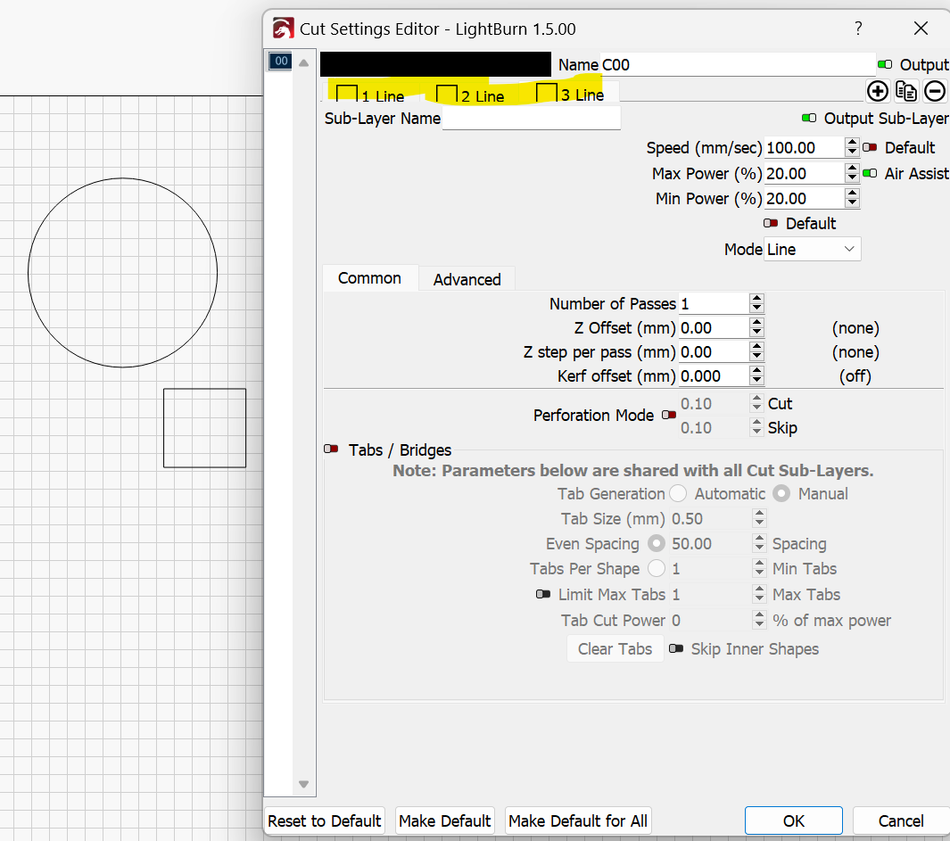

This problem was also listed here:
> [@First cut all objects on the same layer, then repeat](https://forum.lightburnsoftware.com/t/first-cut-all-objects-on-the-same-layer-then-repeat/24229):
> I’ve been looking for the following in the settings and on the forum but I couldn’t find what I am looking for. Let’s say I have 3 shapes, all on the same layer, and I want to cut it with a diode laser. For this I need multiple passes. So I set the layer’s pass count to 8, for instance. What I would like is that it first goes over all 3 shapes, and then repeats, cuttin the whole layer each time. I have a workaround now, by exporting the GCode with the layer pass count set to 1, and then inser…
and probably was asked several times before.
This is a deal breaker for me because I need to cut small holes, and the ideal way is to work on each line/object from the layer once on each pass, instead of applying all passes to same object/line before jumping to the next object/line.
Almost 4 years have passes since that question. Do you support this feature now ? Should be easy to implement - just copy-paste all g-code commands generated for 1-pass job as many times as amount of passes specified by user.
Thanks,
Dima

If I’m reading this correctly what you’re describing can be accomplished by having multiple sublayers of the same operation for as many passes as you want.
For example, in this example, you would get 3 full passes of the circle and square.
 ![image](https://forum.lightburnsoftware.com/uploads/default/original/3X/8/4/84be68ff6536ad6e98786235da05e535ed375368.png)

Not sure I understood your idea, but you brought a great example: a circle and a square.
So I want to have 3 passes, and I want sequence “circle, square, circle, square, circle, square” instead of “circle, circle, circle, square, square, square” which is currently I’m getting.

did I get you right - instead of adding let’s say 15 passes you suggest to add 15 lines on the same layer with offset 0.0 for all these lines, so they overlap each other ?

No.
Take a look at the yellow highlighted section of the screenshot. There are 3 sublayers, all of type Line.
So what will happen is that you get:
1. Circle, square
2. Circle, square
3. Circle, square
Once for each sublayer.
From what you’re describing that’s what you want to have happen.
More information on sublayers here:
[Overview - LightBurn Software Documentation](https://docs.lightburnsoftware.com/UI/CutSettings/index.html#sub-layers)

Each sublayer will act like a separate layer, it will complete all work in that layer before proceeding on to the next layer.

yeah, seems like I need to clone the first layer as many times as many passes I need to have. Yeah, that works, but it’s kind of a hack, from my point of view.
I’m just looking for a software to cut a plywood with cheap diode lasers, usually these diodes can’t make a cut with the one pass, you need to apply more passes, and you can’t hold your laser too long over some region - it’s gonna destroy the area or cause a fire. Imagine a hole 3mm diameter of 8mm plywood and laser which has 5W power.
So for cutting material in such cases it’s better to have this tiny switch in the software.

Seems like I can’t clone it more that 10 times 🙂

You have very specific requirements. Sometimes a hack is the most straightforward approach. The “normal” way to do multi-pass is through the “Pass Count” field but doesn’t work for your specific requirements.
> [@dimagorbenko](#):
The total limit for sublayers is 11. Do you need more passes than that?

I had the some problem, solved with cloned sub-layers then suggested to developers the possibility to repeat complete jobs. Let´s wait for 1.5.00.

yeah, I need more than 11, right now 15 passes work fine for me, they cut my plywood. So I ended up with some sub-layers having 2 passes, and the rest - 1 pass. In total I get 15. 2 passes (one after another) don’t burn to much the plywood.

The 11 is an arbitrary limit. You could potentially request for more to be allowed at the Feature Request page.
