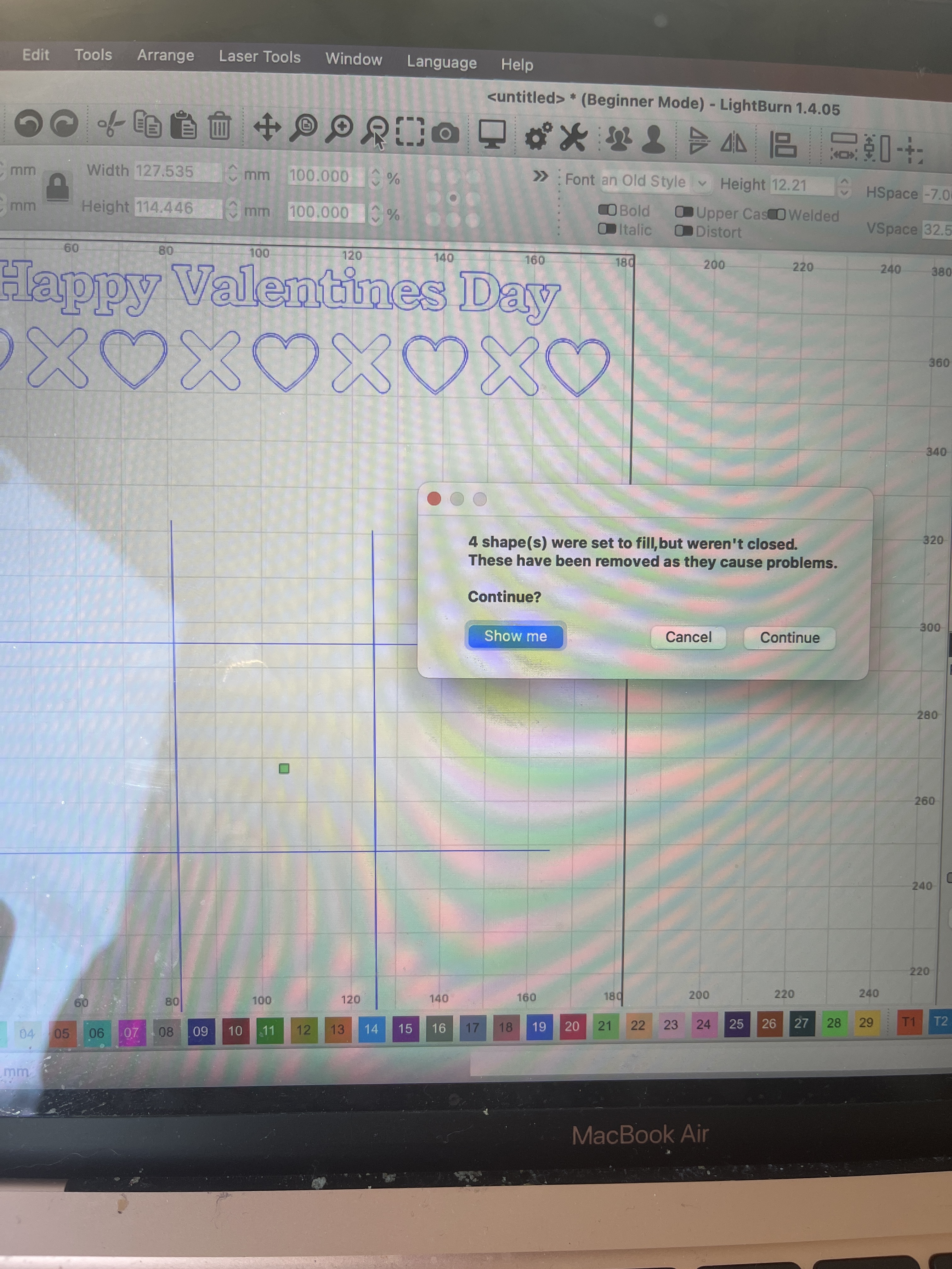

All I want to do is have an engraved line to create a small noughts and crosses board but I get this warning sign come up I appreciate it will be a simple fix but just can’t seem to do it. Only had for a week so understanding not great!
Best guess, you have the blue layer set to fill but your # shape isn’t capable of being closed. If you want the # lines as thin as possible, you can simply move those four lines to a different layer and set it to line.
If you want the # lines to have some added thickness, you’ll need to make some changes so that each of the four lines are thin rectangles, HOWEVER, at the four intersections, you’ll need to break them and join them so that you end up with two closed shapes. A square in the middle and a sort of # without the hole in the middle. Hard to describe and I’m at work.
Just to say Thankyou I did offset fill and then deleted the middle line and welded together thanks
