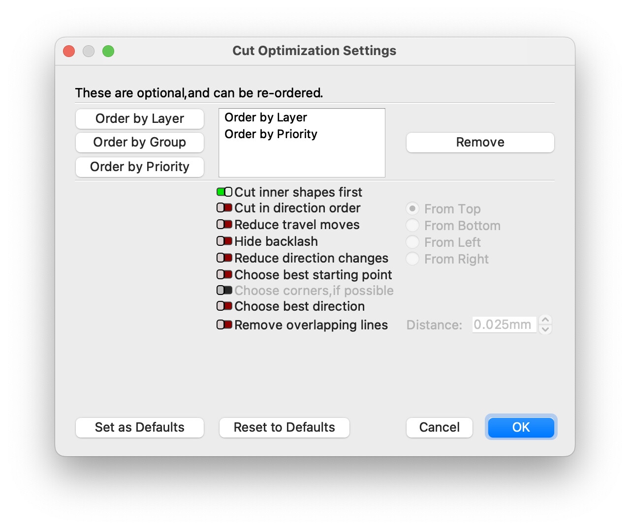

After upgrading to v1.3.01 shape starting points are ignored if the “cut inner shapes first” optimization setting is not set.
See attached file for example. Lines are set to cut starting from bottom:

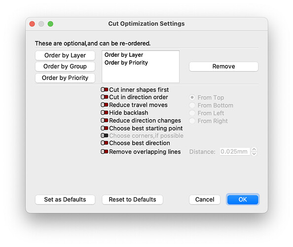

All optimization settings are turned off:

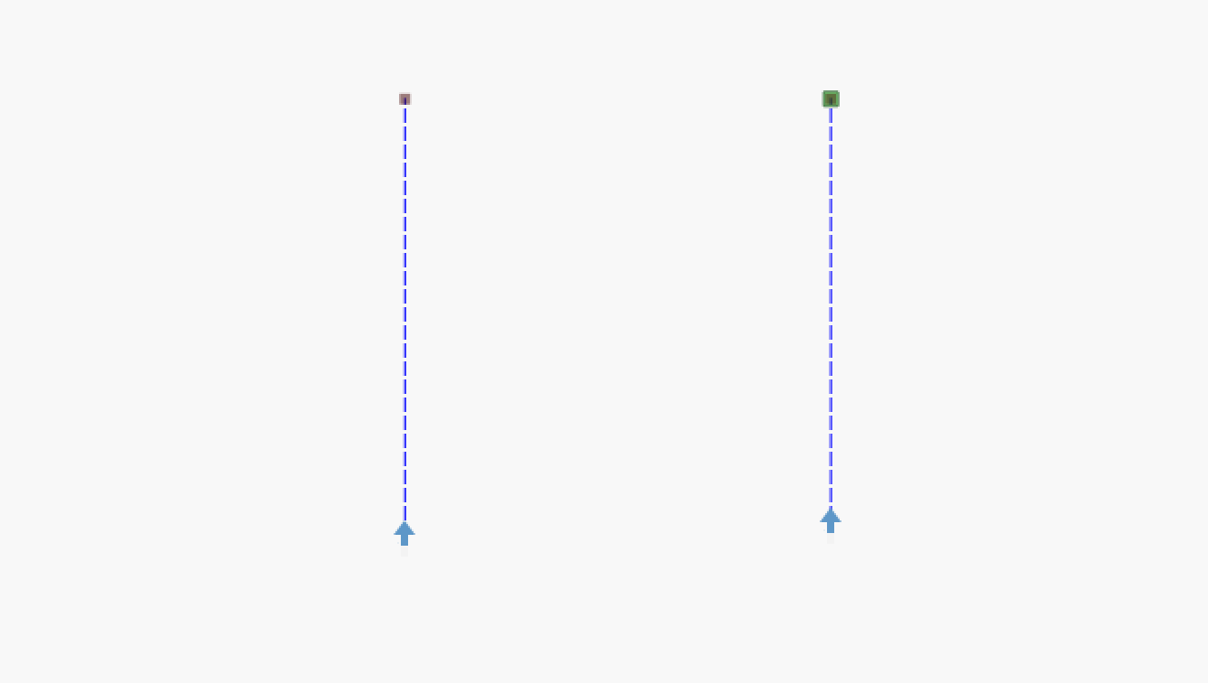

However the lines cut from the top:
Enabling “cut inner shapes first” and Lightburn again correctly follows the start point.

I can reproduce this. But it occurred to me that I don’t think I’ve tried this without “Cut inner shapes first” enabled so can’t confirm if this is a regression.
Thank you for bringing this to our attention. Oz has assigned this post to self for further investigation and will provide feedback once better undeerstood. :slight_smile:
