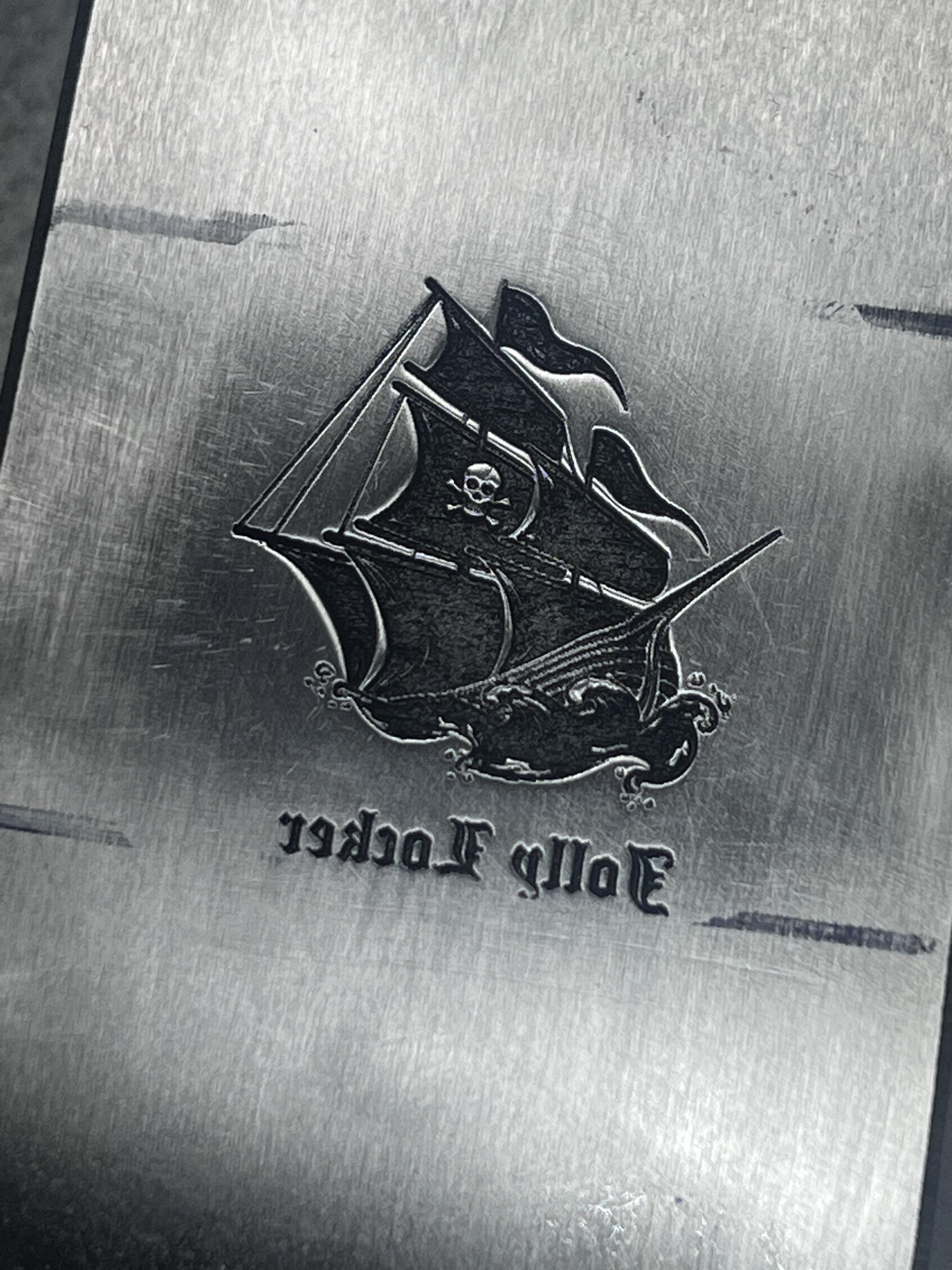

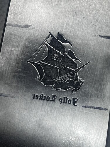

These hardened steel dies, the first one, the pirate ship. It only took me about 6 hours. 110mm lens, 300 speed, 100 power, 30 frequency.
i achieved about .54mm depth and it worked well.

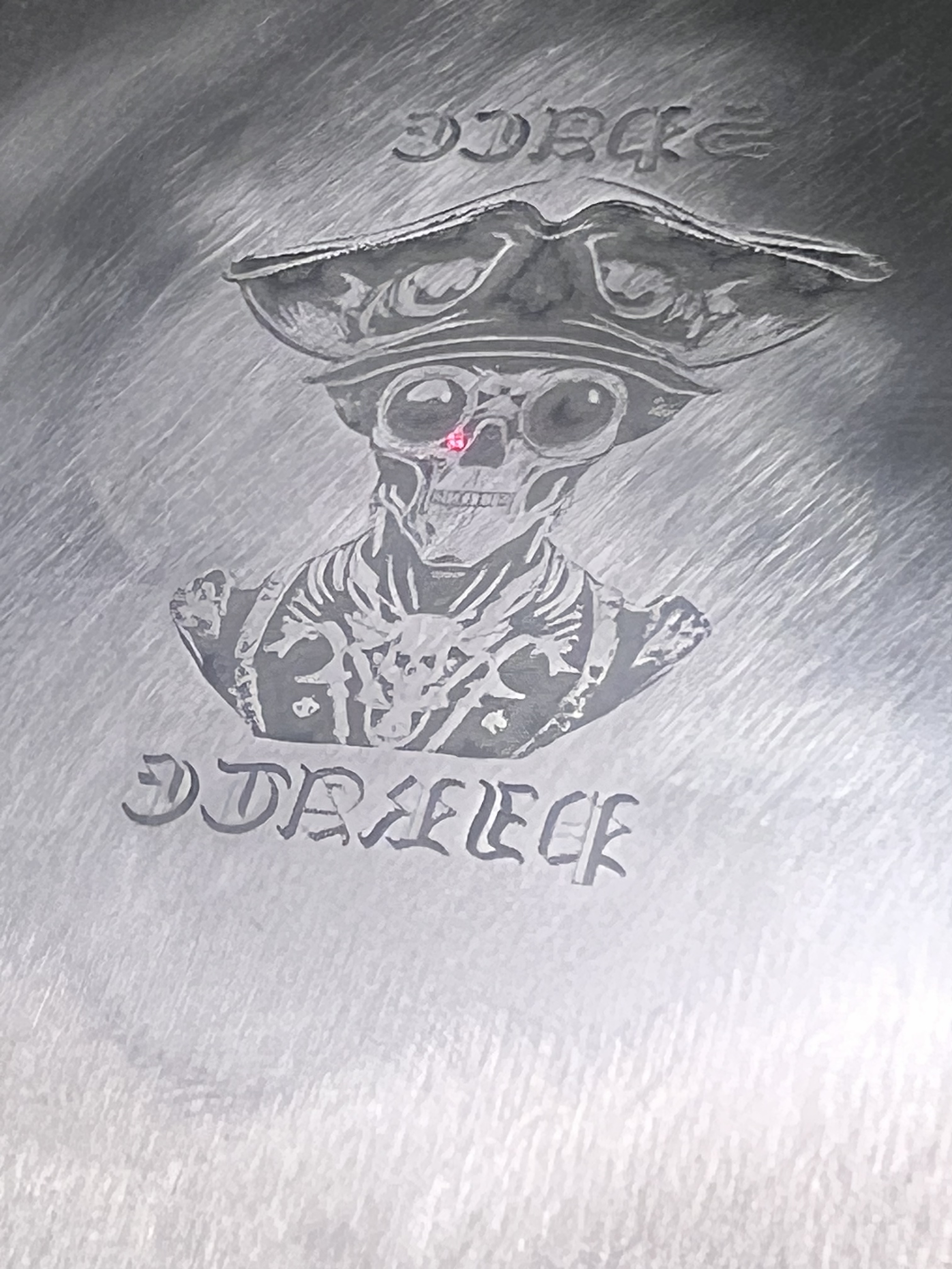

This second one, the Space Pirate, has been going for 15 plus hours and I’ve barely scratched the surface. I’ve tried lowering frequency and I’m still not getting improved results. (Similar to the pirate ship)
Can anyone tell me what I may be doing wrong?

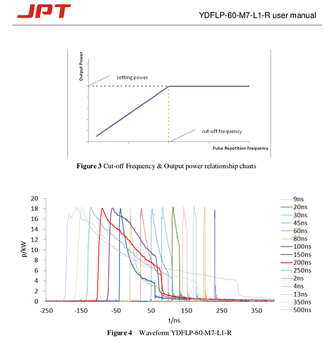

I have an JPT M7 60W MOPA… the manual for the source states it’s maximum power output at a frequency of 40kHz.
The dept of field or focus for a 110mm lens at 1064nM is computed as only 0.76mm, so focus is extremely critical.

From my manual:
Above the cut-off Frequency value is the fiber laser full power output range, oppositely,below the cut-off frequency value is the cut-off power output range. That means the fiber laser will reduce the output power to protect the fiber laser when below the cut-off frequency value. Below is the chart that shows the change between frequency and output:
