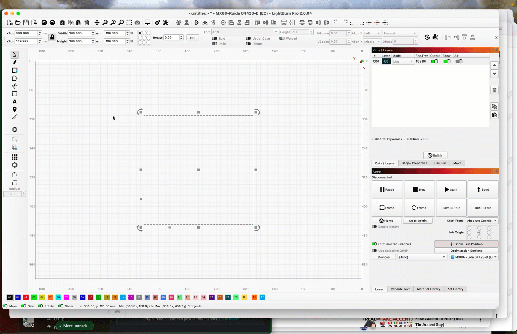

One can also use the 4-point Warp tool. With a shape selected, from the top menu choose ā€˜Tools’–>ā€˜Warp Selection (4 points)’. Holding the Shift key while dragging a handle will maintain horizontal symmetry. Holding Alt / Option while dragging a handle will maintain vertical symmetry. Double-click on a handle to reset it. :slight_smile:
4 point Warp
You can discover more about the Warp and Deform tooling here:
