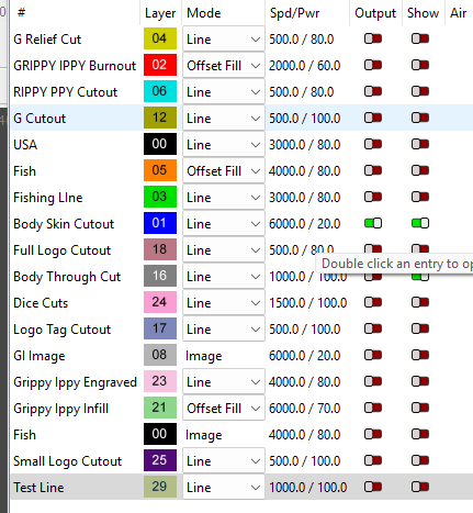

What color do you want theShape to be on? Almost all of your layers are turned off :smiley:
Body Skin Cutout 01 Blue - Is turned on. Sooooo Do I have to select the 01 Blue to see the ellipse?
I don’t get it. Something in the procedure?
Draw the shape, then click on 01 in your color pallet.
OMg. I knew it was simple. Still. For example when I draw a line I do not have to select a color to be able to see it. For the little bit of time I have with Lightburn I do not recall this being the case. There is a chance I never had to do a shape before but, again, I expect to see the shape in the Cuts/Layers window before applying a color. I see now that the shape does not show until a color is applied. Everything else I’ve done seems that a default color was applied.
I do intend to make the ellipse part of the 01 blue line so this works out good. I fumbled around with the colors with confusion before but I think this taught me something that is lightburned into my brain now.
