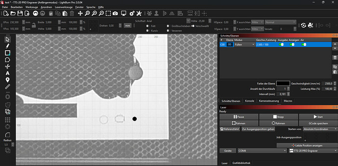

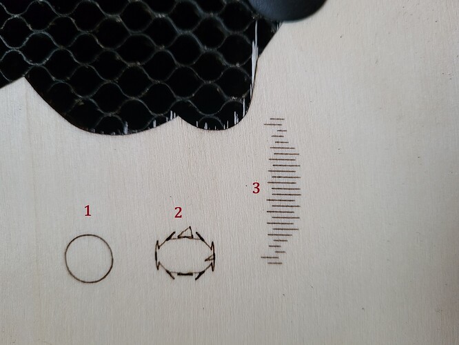

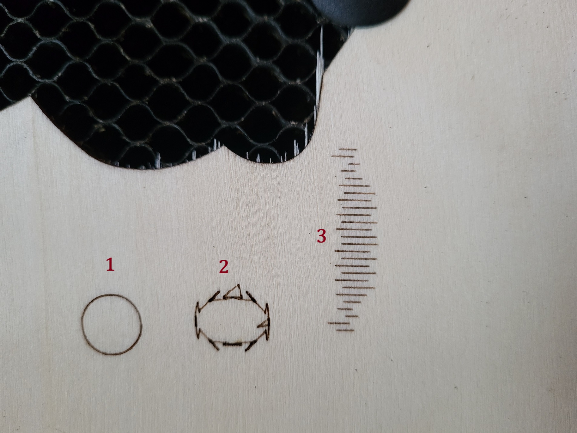

In the screenshot:
On the left (1) a circle line 10x10mm on V 2.0.0.2
in the middle (2) the same circle line on V 2.0.0.4
On the right (3) a 5x5mm circle filled on V 2.0.0.4
Has the definition of “circle” changed? With more complex designs or images, the laser goes completely crazy.
This appears to be an issue with your license. Email support@lightburnsoftware.com with a copy of your license key and we’ll investigate.
Where did you buy this LB version?
I got the license from the laser dealer.
Ali Express - > China :frowning:
So far I haven’t had any problems. I will contact the dealer and LB Support.
