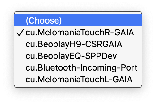

I am sorry to ask but I really need some help with this issue. I updated to 1.3.01… I was waiting as I had a job to finish and it started in December. Now LightBurn cannot be connected and I cannot even run the macro from CNC to Laser. I use a Mac running Big Sur and it always used to select a USB connection (1401 I think) but does not see it now. It is trying to connect to bluetooth items on the network (mesh network). I have turned the network off but the bluetooth selections are persistent (see image). The choose selection dropdown only brings up the settings I am trying to avoid. How do I get the auto setting back or remove these items. Perhaps there is a factory default reset process setting for the whole program. Thank you for any assistance.

You can tell LightBurn to ignore all those unwanted devices, see: [Connection Issues - LightBurn Software Documentation](https://docs.lightburnsoftware.com/Troubleshooting-Connection.html#connecting-to-the-wrong-port)
Usually the correct serial port name will show up as something like “cu.usbmodem1234561”.

> [@NicholasL](#):
Perfect answer!
Thank you very much for your comment.
I am very much obliged to you for the welcome assistance and the hyperlink.

Everything is now working as expected because of your assistance. Thank you.
