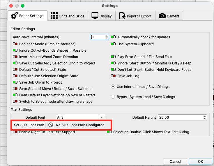

If you have the single line fonts on your computer you need to tell Lightburn where they are. They don’t install like regular fonts. The setting in in the Settings (gears) menu.
