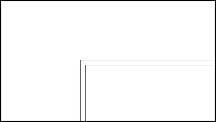

Regarding the data in the AI files.
The Clamp Spacer file has “double lines” that are .1mm offset.
The Hammer - Copy file has “overlapping lines” in 6 places. Five of the shapes that overlap are the filled in shapes, and the exact same shapes that are not filled. Also, the perimeter is 2 duplicate shapes.
The Zero Clearance Insert file has “double lines” that are .1mm offset.
The XXX file has “double lines” that are .1mm offset.

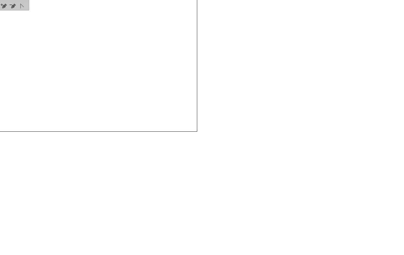

Have you looked at the files in AI? I know those files import into LB with double lines, but I can see no double lines in AI and that’s the problem. I know the hammer has the overlapping lines, it was designed that way. The critical thing in that file is that the square was created at the same time as the xxx file and it doesn’t import with double lines.
Yes I did. You can see the “double lines” that are .1mm apart if you change the view in AI to “Outline”
I’ve looked at them in outline view at maximun magnification and still don’t see double lines
I see them in AI, Affinity Designer (outline mode), and LB
This is what I see in outline of the xxx file
