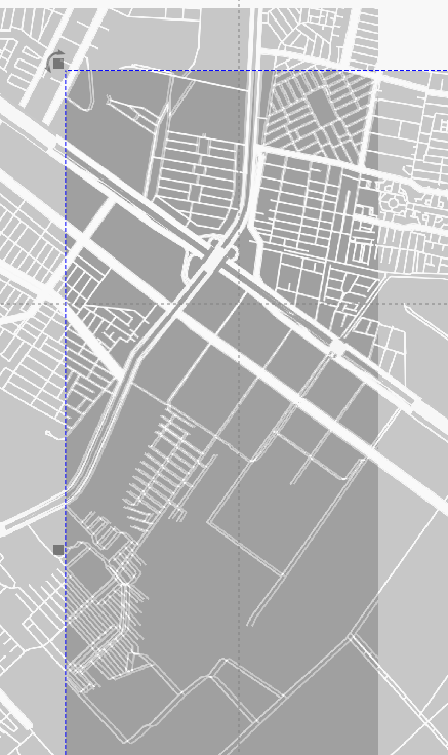

I do a lot of tracing. And after updating to 9.17 then 9.18 it seems that when I import screenshots, the sizing or scale is a bit off. I can only match one section of the pic and the rest is off. Before I used to be able to tile multiple Shots seamlessly. After these updates it has been impossible. Any insight?
Not really, not without an example or two. Not really following what “I import screenshots, the sizing or scale is a bit off.” means, exactly.
As if when im tiling an image. the Images that are overlapped can’t be matched. only a small, focused section can be and the rest bleed off. screenshot for reference. I rolled back to 9.16 and all is well again…

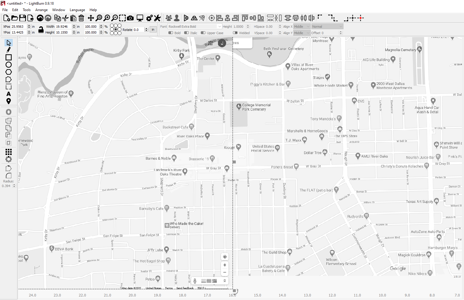

What application / process are you using to capture your screen? I am using Snag-It for screen capturing. I do not have this issue with 9.16, 9.17, or 9.18. Below, an example of capturing google maps as displayed on the screen, panning the map almost a full panel over, capturing the second panel, and aligning them together in Lightburn (copying to clipboard within Snag-It; pasting from clipboard within LightBurn; aligning the two pasted images in LightBurn).
