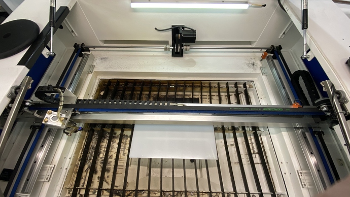

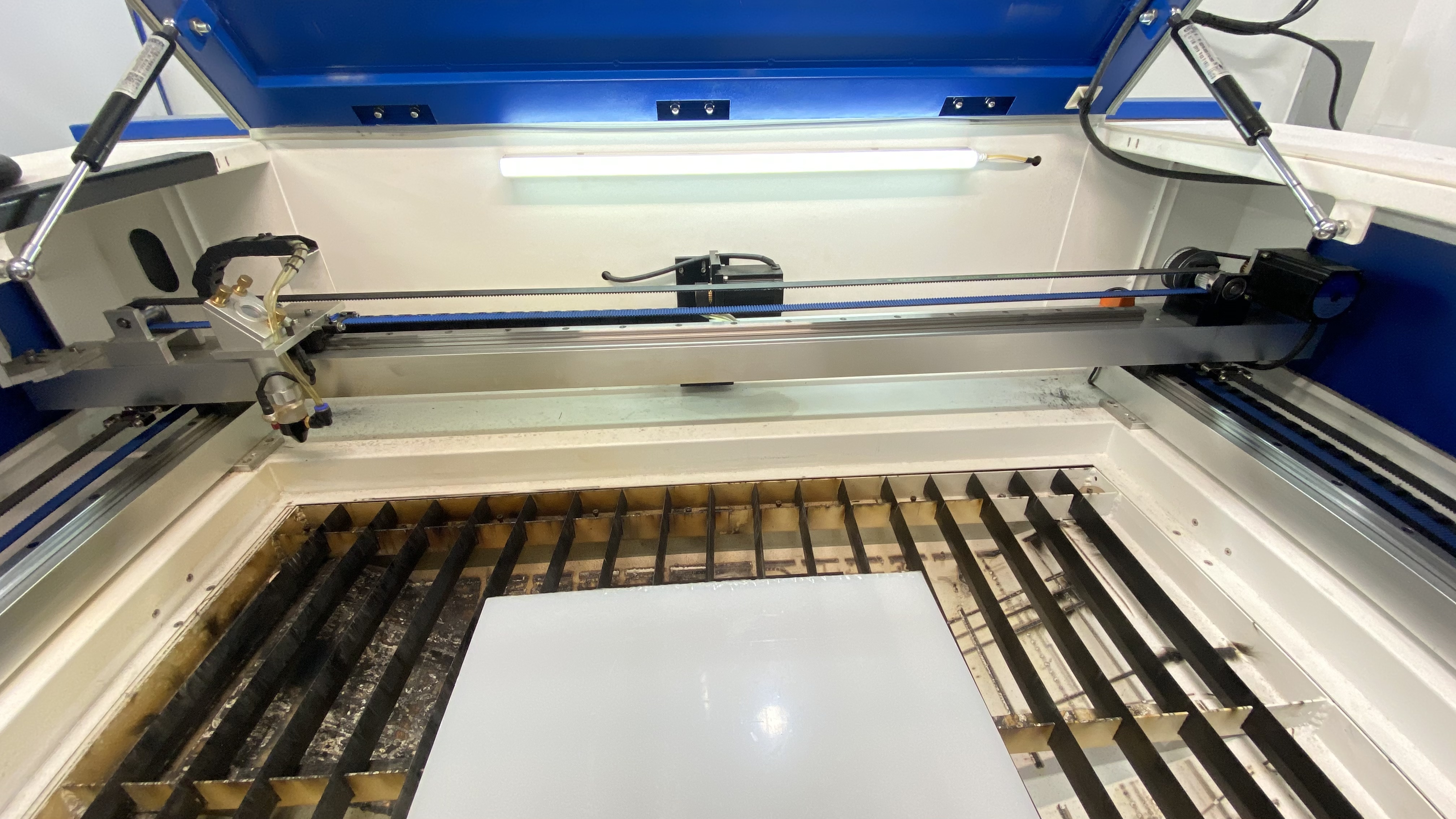

On my laser, X is the motor on the gantry (moving the head left and right):
Y is the motor in the back that moves the head toward and away:
Yep two motors on the x and one on the y
I trust you (your video doesn’t really show the motors driving X). The orientation of your gantry is uncommon. I see that the path of your laser is persistently in the front of your machine which increases the risk of operating the machine without a closed lid.
