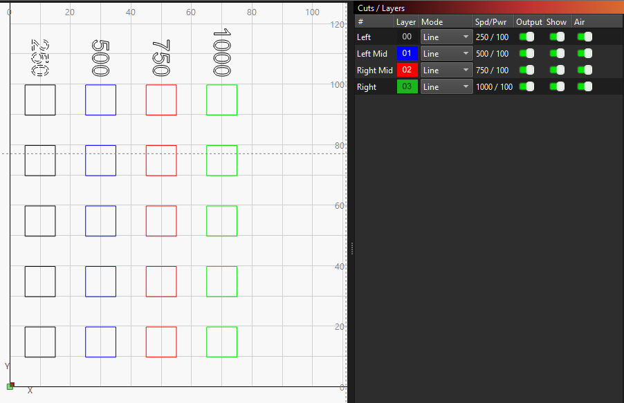

I built a test file for cutting with a number of squares, set to various speeds and powers.
However when I burn it the laser turns completely off for no apparent reason.
It’s still acting like it’s burning but the laser is completely off.
The speed adjust is in the layers, power in the squares themselves, 60% to 100% bottom to top.
I’ve been struggling with air assist for a couple days already and never had this problem.

The power settings are in the squares, not in the layers.
The machine will happily run 100%. Up till now I’ve been doing metal engraving, today is my first experiment with cutting.

There’s yet another problem there.
When I open the power window on the touchscreen, it’s always at 0%.
I can set it to any number I like, close the window, open it again, it’s 0%.
After multiple tries, usually a given power setting will “stick”.
This is the SM350 with it’s custom power supply. I’ve run it on other files just fine at 100%.
The only info I could find for such issues, mentioned updating firmware, check power supply overheat, and the 0% power issue could possibly be a software glitch/ bad Gcode.
If you can run other files ok, then is that file corrupted.
I own a SM Ray 20w & IR1064 but dont know much about code.
I did find that the same project will burn properly if output from 1.7.06 rather than 2.0 RC2. I sent that in as a bug report yesterday.
