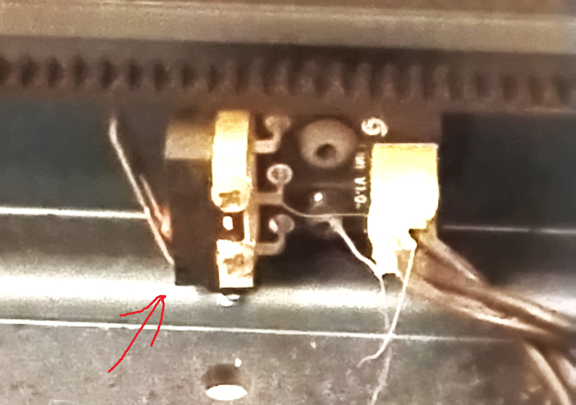

Hello I have been using this laser without issue on Lightburn for a while. I moved to a new location, and now it seems to have forgotten where home is. When I hit home, it goes towards the bottom left corner, then it sounds like iit’s grinding gears trying to get home still when there is nowhere left to go. I recently bought a second machine, a different brand different size, and it’s doing the same thing.
The first machine is the Omtech B10 and the 2nd is the Sclupfun s70max
If it tries to go beyond the limit switches, the switches are either broken / not connected or misconfigured. Show your configuration and the output of the ? command in the console.

Is this a physical switch you are talking about?

Did you move the machine? It sounds like your gantry is not square to the frame so the module can’t fully activate the switch.
First, measure from corner to opposite corner and check the square of the frame.
If the machine is perfectly, square, with the power off, slowly move the gantry to the top of the work area until it hits the hard stop of the frame. Pay close attention and see if both sides hit the hard stop at the exact same time. If not, you have to loosen the timing belt on the side that hats last and push it into the frame so the belts jumps teeth and the gantry is returned to square.
My guess is you moved the machine and the frame is now out of square.
EDIT: I just reread your OP and I see you did move the machine. It’s likely the frame.
Yes, a little hard to spot.
