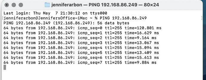

I have searched the forum and have tried all of the troubleshooting tips provided. My iMac is still not connecting to my Ruida CO2 laser via an Ethernet connection. I have manually tried to connect them so many times using the “subtract 100” method recommended (for the last series of numbers of the IP) and it still reads “Disconnected” every time. Tried uninstalling and re-installing with no luck. Help!

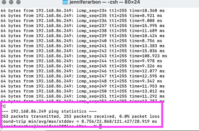

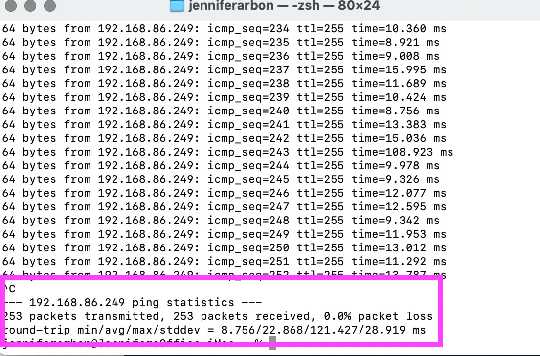

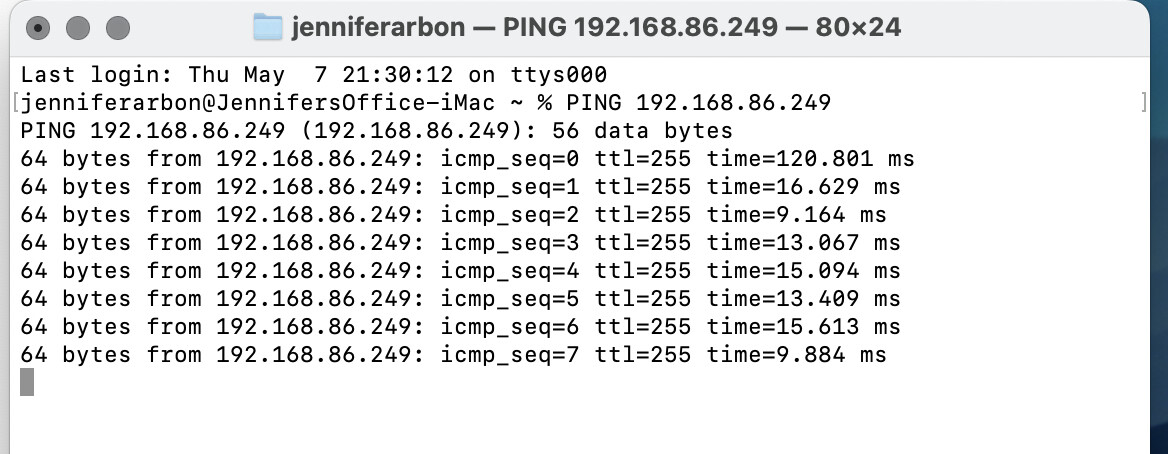

I verified that my IP is not being used for another device. My laser says “LAN ON” and when I PING, I get the 64-bit message indicating that the laser and my computer are communicating just fine. However, in LightBurn when I right-click on “Devices”—I still see the “Disconnected message.”

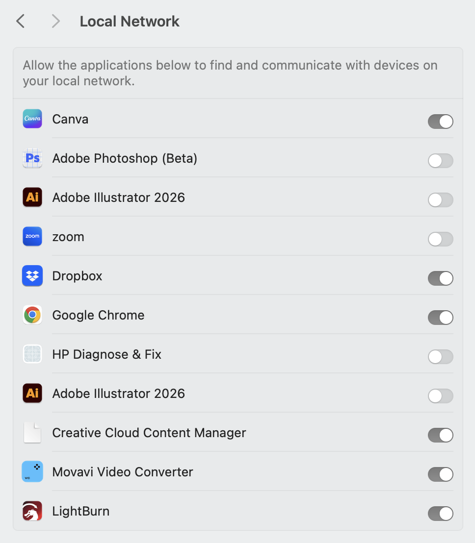

clicking on the “Read” button in Machine Settings where it shows an error, making sure I have granted local network permissions, plugging the Ethernet cable directly into the Ruida controller (rather than in the external port), and clearing the controller memory—among other things.

My LAN IP (iMac) = 192.168.86.136

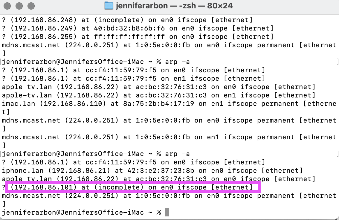

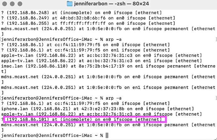

I tried switching up the last segment of numbers and ran this test. The newest IP (192.168.86.101) is showing “incomplete” which I guess shows that the laser didn’t replied to the request.

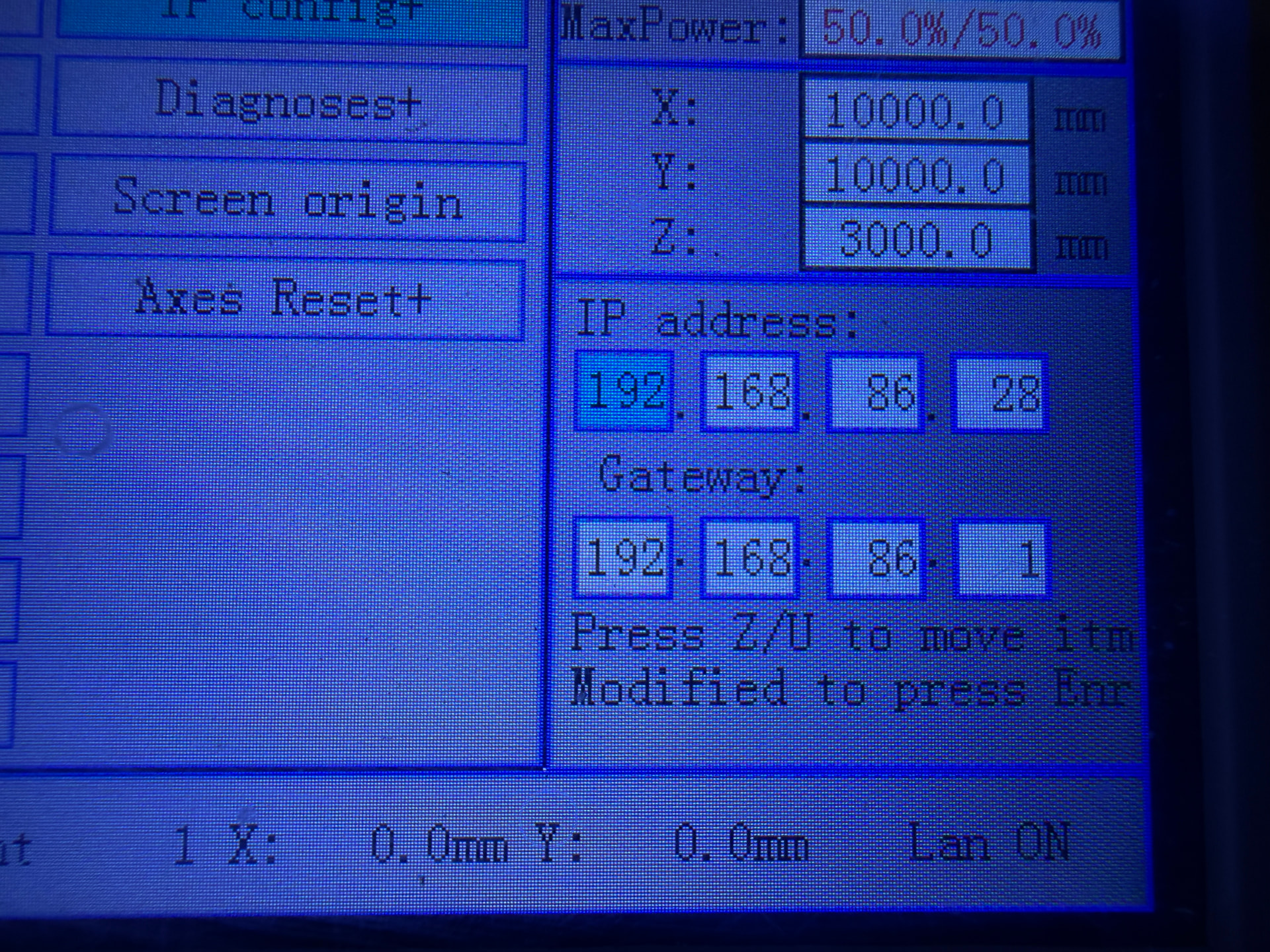

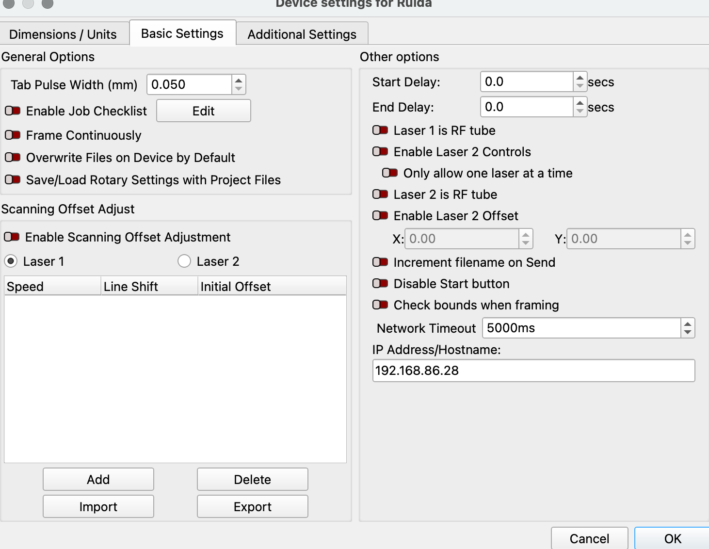

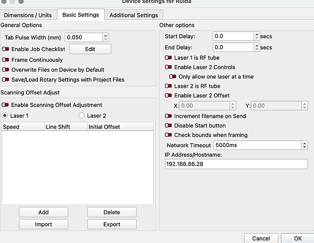

Show us:
- A photo of the Ruida display showing the IP address set there
- A screenshot of LightBurn
Basic Settingstab inDevice Settingsshowing the IP address set there - A screenshot of the Mac’s
Privacy and Securitysettings showing LightBurn has permission to access the network
Please don’t change anything after taking those screenshots, because then we’ll be solving a different problem.

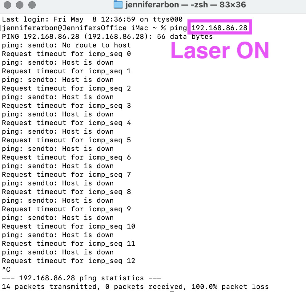

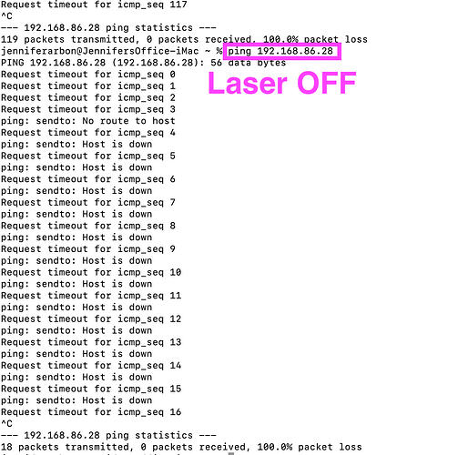

I had to change to .101 because I discovered the .249 was just pinging to a different device. I tested the .101 with the machine off and it still gave a “request timeout” message—so I’m hoping it is available.

I use a piece of software from the 60’s called ARP-SCAN, this scans the local lan and gives you information on what’s hanging out there.

And now it’s .28; you see why screenshots help us follow along.

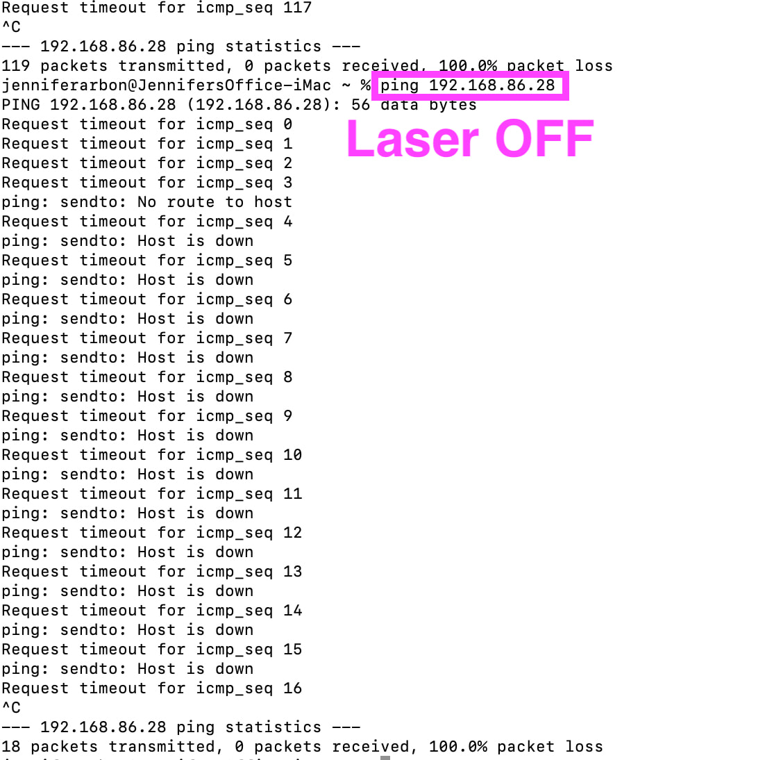

Without changing anything …
- With the laser turned Off, what is the result of a
pingto 192.168.86.28? - With the laser turned On, what is the result of a

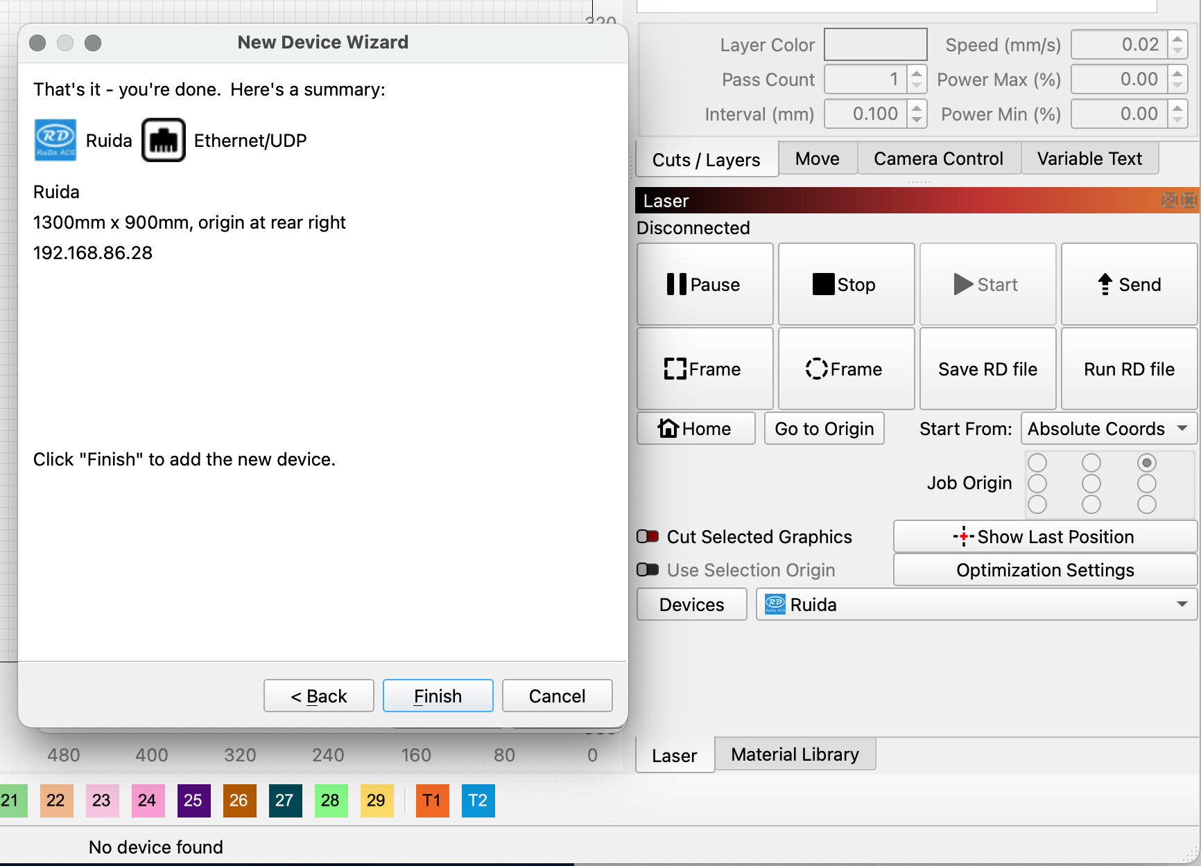

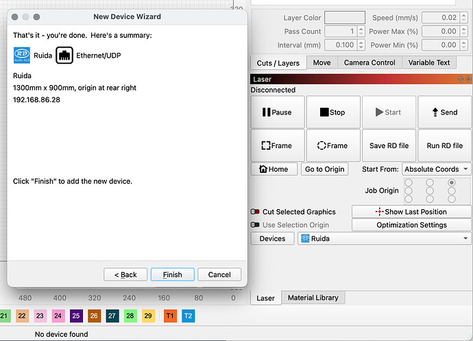

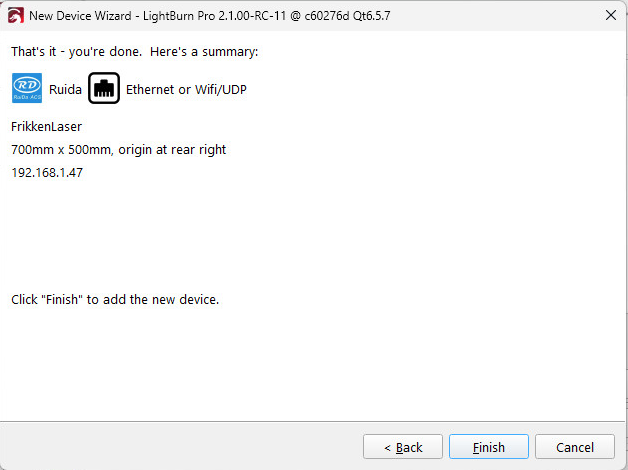

In LightBurn:
- In the
Laserwindow, clicking theDevicesbutton should show the single entry you namedRuidain the list. Drag that list over near the theLaserwindow and screenshot them together to let us see what you see. - Step through the device setup until you get to the
Summary, which will look something like this:
- Screenshot it so we can verify the setup.

Should that Gateway address be 255.255.255.1?
Yep, I changed it to .28 because .101 was being used already apparently.

Here are the screenshots you requested:
My subnet mask is showing: 255.255.255.0
