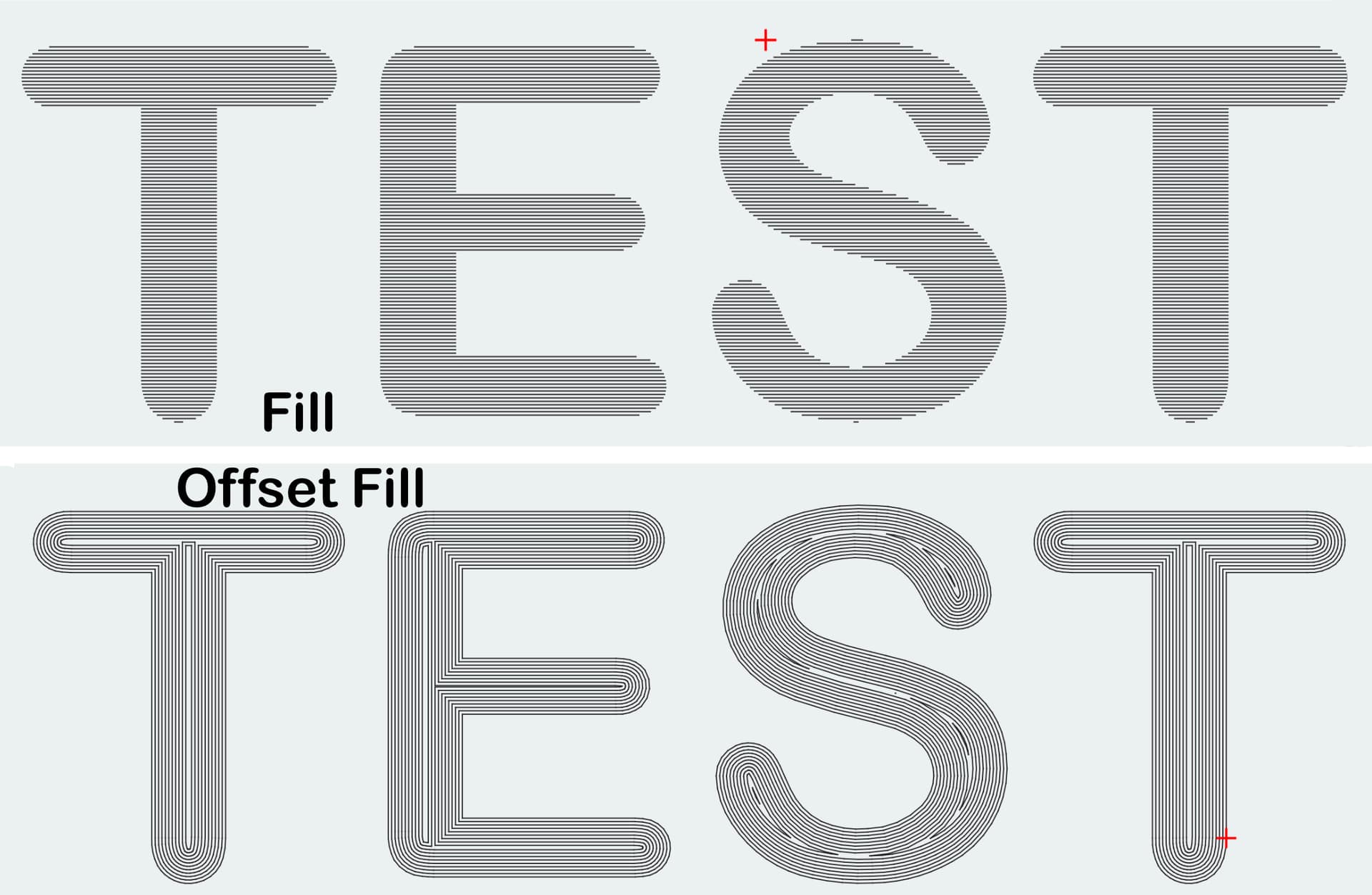

First, it is highly advised NOT to use Offset Fill with a rotary. Even with a chuck rotary offset causes the rotary to move back and forth more than it’s designed to. On a roller you will almost certainly lose position due to the cup slipping. This “Shouldn’t” happen with a chuck, but why risk it. Normal fill is the way to work when using a rotary.
Offset fill will give different results to your engraving, and it is really only for certain use cases, not general usage.

Generally offset fill follows the curves of the object, much like a spiral. This can cause issues with trying to apply some of the rotary options to a spiral fill.
All Lightburn can do is emulate the machine, so I suspect that’s what you see.
