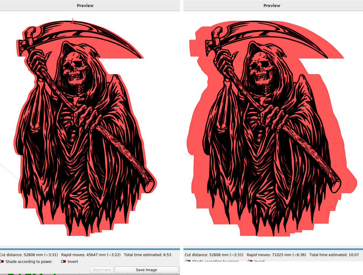

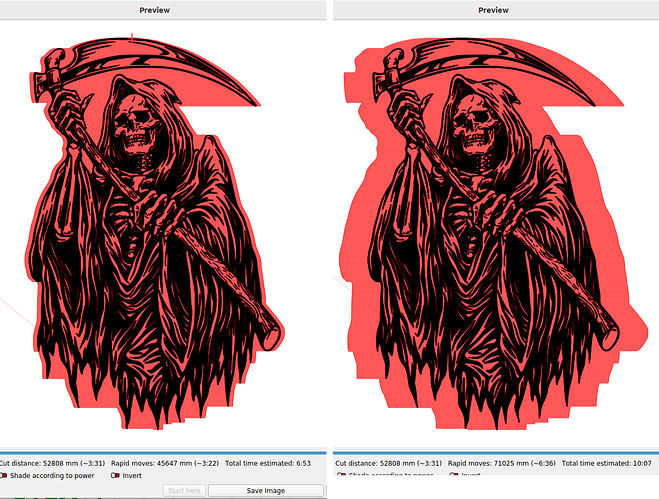

Here one that is more of a job that we typically do. I’m scanning this, on the right is 6000mm/s^2 and the left is an acceleration value of 40000mm/s^2. Notice the job times.
If you want to speed up a job, figure out how to increase your acceleration value. It also shows why speed isn’t everything.
