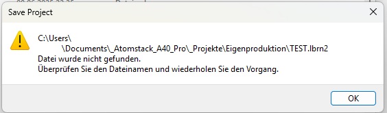

Yes, sorry, I can’t save in the Doc folder, but I can save anywhere on the PC. It’s probably a Windows problem. Here is the message in German:
Yes, pretty sure it is a permissions issue, although the Documents folder should not locked down.
