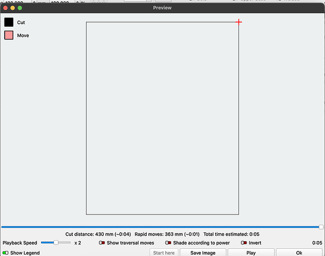

Is the “Start here” feature in the Preview window missing, or not implemented yet? I need to recover from an emergency stop.

It’s there, has been there for many versions of Lightburn. You see it grayed out in the bottom center of this screenshot. It’s gray because I’m not connected to a laser.
Thanks. I see it in Lightburn, but not in Millmage.

MillMage does not have a Start Here feature in the Preview. Might be for a safety reason; I have never seen an industrial mill (HAAS, Fanuc, Bridgeport, etc.) with this ability, although I was maintenance and not an operator.
Im pretty sure you hit the nail on the head - there are a lot of reasons to want a start here function, and I believe we’ll get there, but at this stage of the game it’s a nice to have.
We’re trying to get all the critical features perfected before launch as the priority for the moment. Start from here is definitely on my personal wish list too, but for now your best option would be to re-post your cut and disable any already-run operations.
Ah ok, that’s good to know.
Hopefully someone can update the docs, as it mentions “Recover interrupted jobs using Start Here” and teases me with the button in the preview section ![]()
I’ll put in the docs update request, thanks for letting us know!
